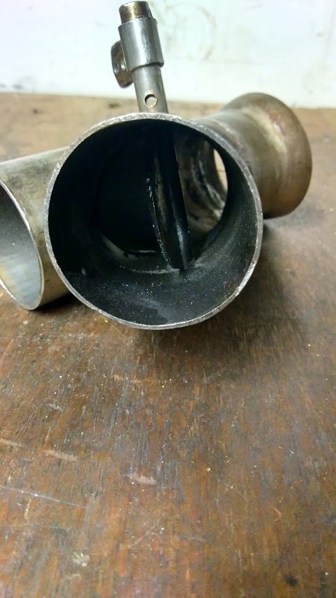

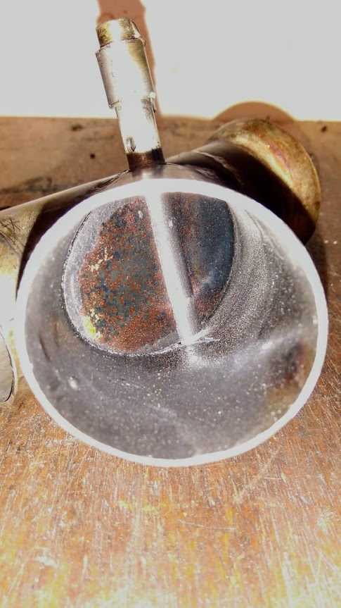

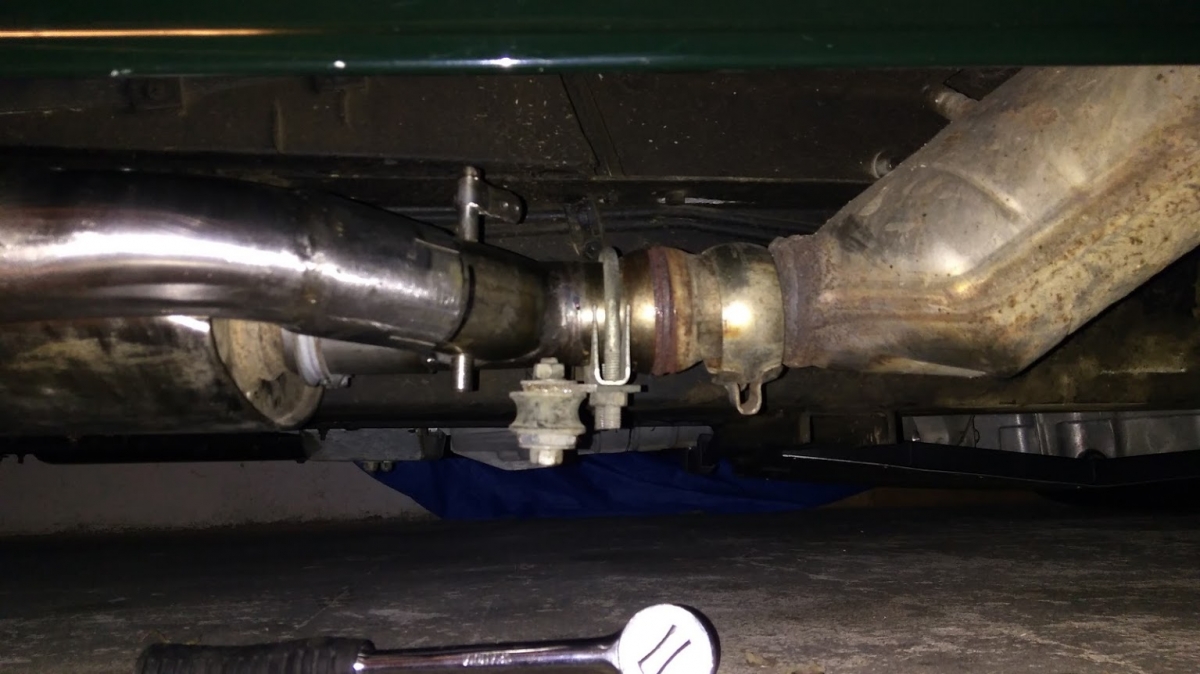

Some more pictures in case anyone wants to do this mod

Switching from silencer path to straight through path ? I wonder what happens to the idle at traffic lights as the ecu won't like it !
JJW #436211 12/03/17 10:18 PM
As it's post cat, it shouldn't affect the ecu.
Jays #436284 13/03/17 12:10 PM
Posts: 5,587
Posts: 5,587
Thats excellent news !

So, is the car left hand drive? But then the exhaust pic looks RHD.
nick w #443430 16/04/17 11:47 PM
Could be a conversion?
nick w #443496 17/04/17 01:31 PM
Posts: 14,749
Posts: 14,749
The exhaust is on the right hand side of the engine regardless of whether the car is LHD or RHD. I think the steering setup and the dash are the only things that change. Perhaps the headlights too, but not necessarily as some types are simply adjusted for LHD or RHD.
I wouldn't be sure about that. Back pressure, or lack of it, can have a big effect on the mixture requirements. To a degree the ECU will compensate using the sonda lambda feedback loop but the this will have limits to the maximum rich or lean adjustment available.
