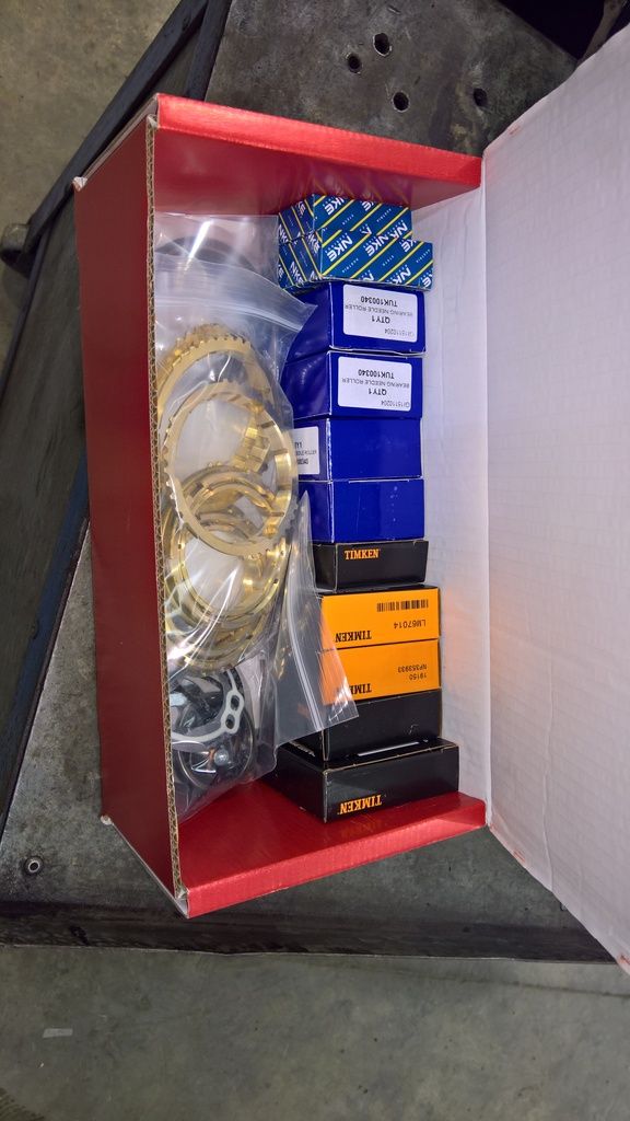

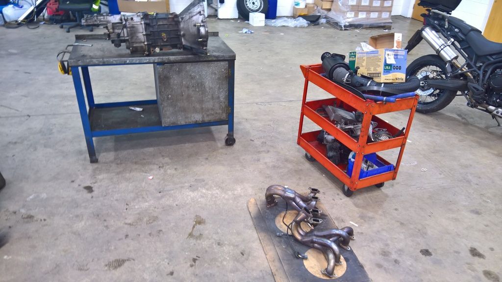

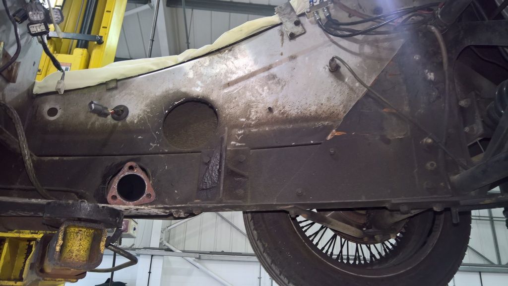

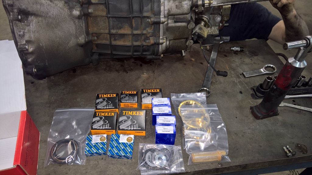

The big project has finally begun! The engine is out and at V8 Developments, gearbox out and stripped for a full rebuild. AVO shockers, Pandhard rod, brake reaction stays, anti-tramp bars and bonnet strap delivered. Williams 6 piston callipers, discs, pads and braided brake hoses still to be delivered. Motolita Mk 3 dark stain thick rim wheel on order, hopefully, it will all be complete for Goodwood FOS!
