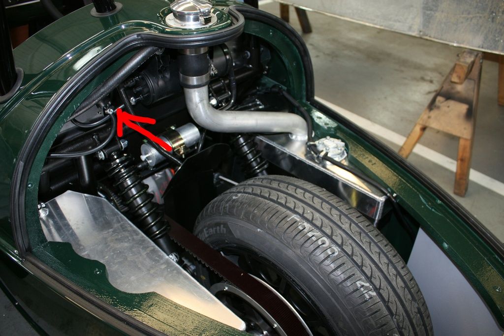

Originally Posted By polar993
The noise seems to be coming from right behind the seat, towards the upper part of the seat specifically. Is this where the fuel rollover valve is located? How do I gain access to it so secure it with a tie wrap?
Thanks for your help!
It's located here smile

Richard,
Thanks so much for the photo! I will give this a try. Hopefully securing the rollover valve will resolve my problem.
Do you guys think any noise comes from the seat belt tensioning system? Again, my noise seems to be coming from directly behind the seat.

Wow Richard that's one v clean and tidy back end!
Richard,
I thought it was seatbelt / tensioner too. I was ready to tear into it. It was the rollover valve. Loud little sucker!

Yeah... it was great relief because tearing into the seatbelt assembly looked to be a birch and the sound ( incorrectly) led me to believe that's what it was. The "fix" you're going to do May/may not provide relief. Don't give up. Try confining it at different angles and tensions until resolved. Mine is strapped down very tightly with two ties holding it on two different planes.
