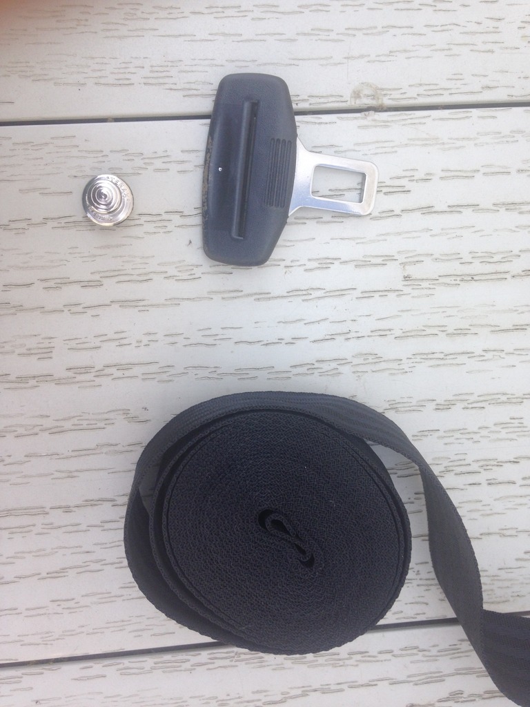

I drive a lot with my Tonneau cover fitted. The problem I have been having (as I suspect all Tonnuau covers have) is that at speeds above 25mph the airflow gets under the passenger side of the cover and it begins to balloon. Then as the speed increases the passenger side of the tonneau cover gets “into a right flap” which is annoying in that it’s noisy and is a constant distraction in the corner of the eye! So I decided to create a “Tonneau Cover Anti-Flap (TCAF) Strap” utilising the passenger seat belt anchor. The TCAF Strap costs less than a tenner, takes 40 mins to make and fits and removes in a second and works like a dream! The bits (see photo 1) a seat belt buckle (£2 ebay), 2 ft of seat belt strap (£2.50 for 5 metres off ebay) and a Tenax button fastener.(£5) . Fitting sequence:

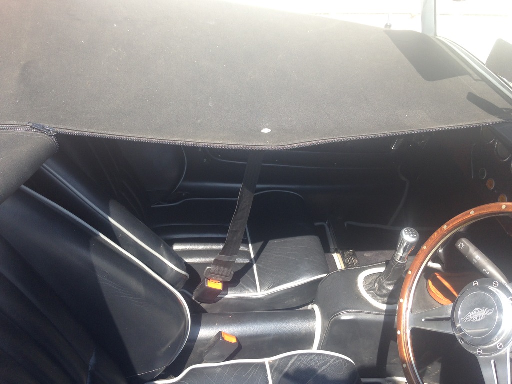

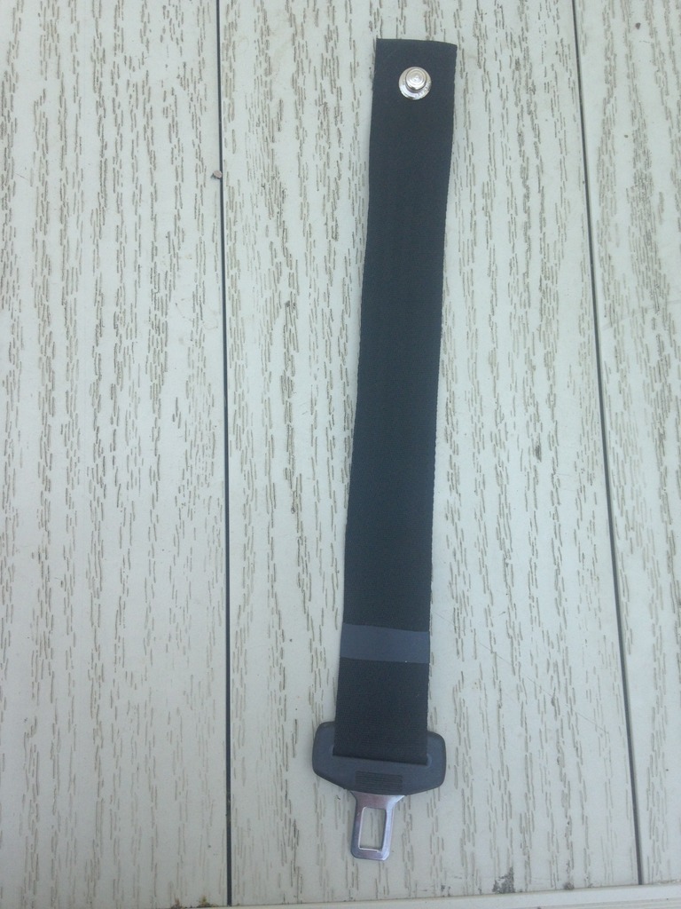

6. Remove strap cut to length and glue/sew strap onto buckle. (see photo 2).
7. The TCAF strap is complete.
8. Install (See Photo 3.
Finally in terms of general use I leave the Tenax connected at all times and once I have stopped I release the seat belt letting the TCAF Strap hang ready for next drive. This allows the driver side Tonneau cover to be fully secured as per normal when leaving the vehicle. The Tonneau cover driving experience is now superb
