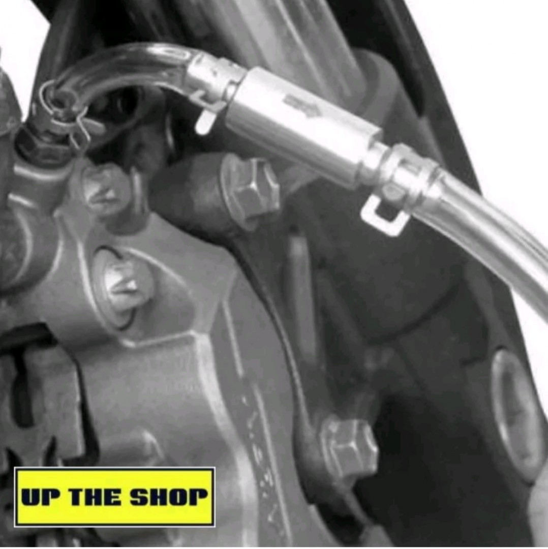

I just use one of these, had it for years, easy-peasy (link for illustration of tube only)
https://www.ebay.co.uk/itm/200345014236

I've opted for this device from ebay. Has a one way valve and the clips look reassuringly good for holding the tube onto the nipple. About £7 Inc delivery. Will allow for solo bleeding, and won't take up as much room in my every increasing morgan maintenance kit, as an easy bleed would.
