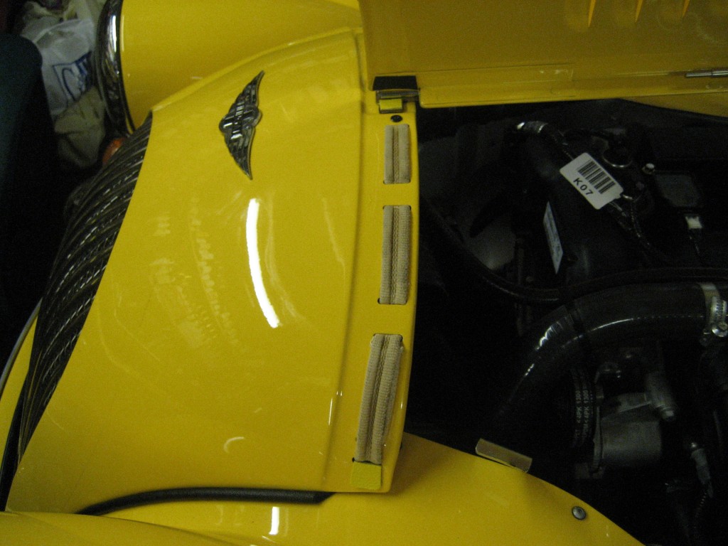

This is the factory buffer. It looks like 2mm standard density neoprene and as you can see it didn't last 200 miles. The paint was eroded in four places, even after such a low mileage.
I would have liked to have replaced the modern badge with a heritage Plus 4 badge but after lifting the badge, there was too much paint grooving underneath. So I added a neoprene gasket and refitted it. Interesting that the factory now use penny washers underneath with a fibre gasket. Makes good sense, but tightening down on soft paint doesn't make much sense!
Here you can see my replacement yellow leather buffers and a black leather buffer. All fixed with double sided tape, and vaselined.
Here's the bonnet rear. The hinge is fitted much further back than on my Roadster, so the brass hinge fixing is visible with the bonnet closed. So I've added some yellow leather to disguise this. Plus a black leather buffer on the bonnet - both sides.
On the bonnet corners I've added a black leather buffer - vaselined.
So now the bonnets, cowl & bulkhead are properly protected from chafing!

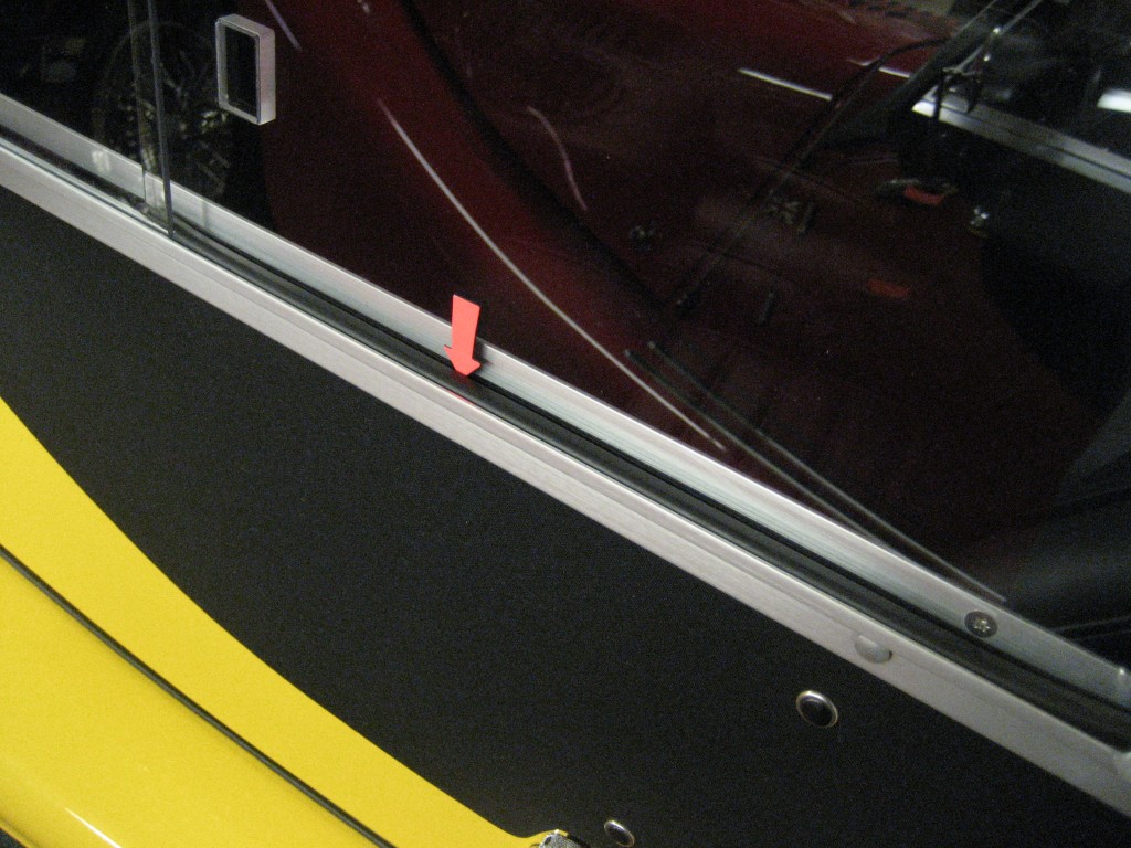

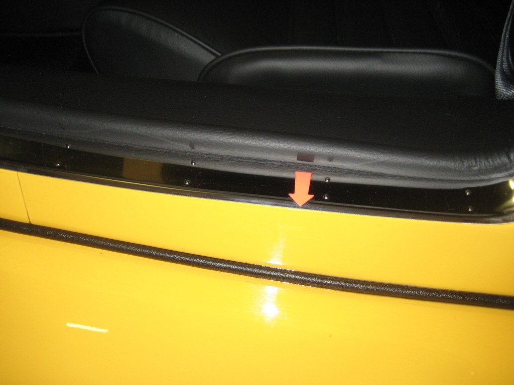

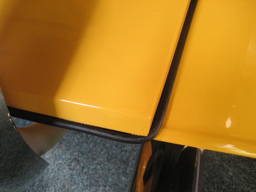

And so to paint protection film around the doors. Depending on how your doors fit, they can rub the paint in three places. Some cars don't have a problem. Others do.
First, the A post as shown by the arrow. I've added some paint protection film, but obviously it doesn't show up! It's below the raised moulding.
And here where the sidescreen can rub the paint:
And a 3/4" strip along the body where the door bottom edge buts up.

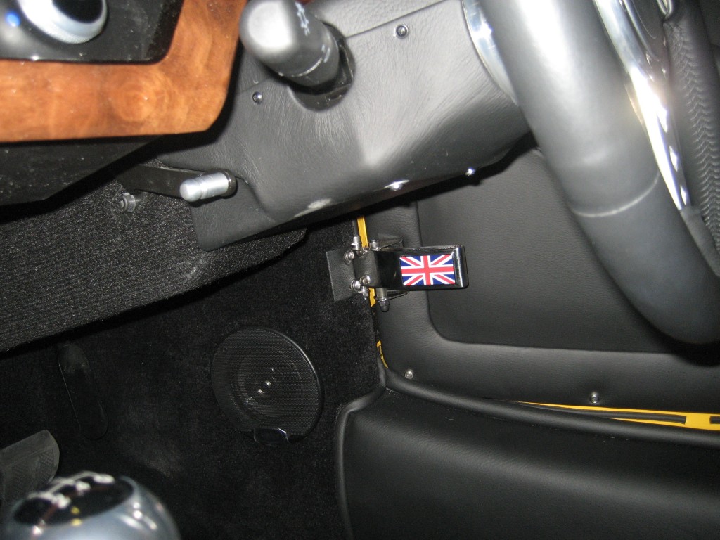

I kept my Librands door keeps from Bumble, but have leather wrapped the brackets:
I also boldly added some Union Flags which I had "in stock". Bling maybe but they do look good!

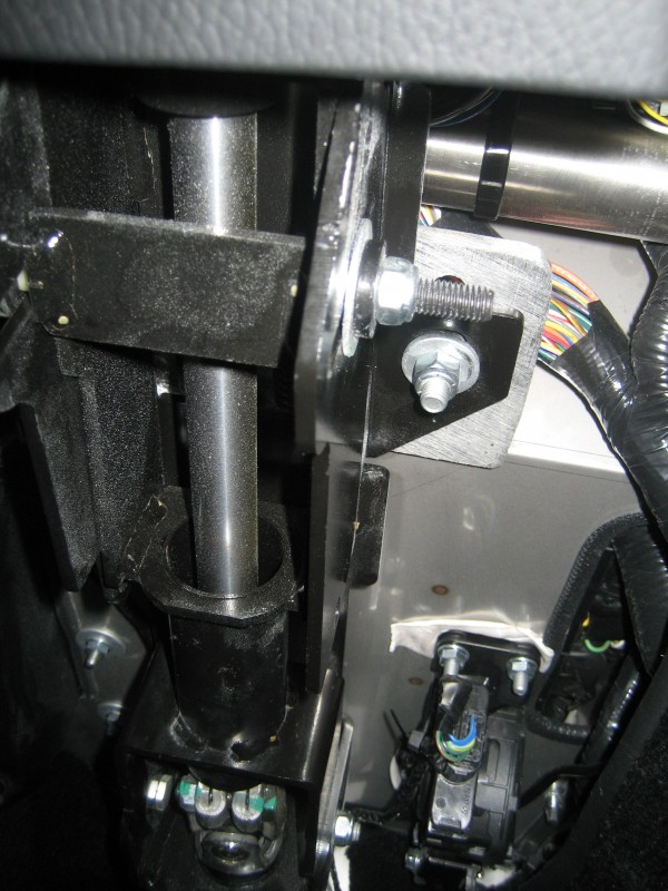

Finally today I had a look at the slight knock coming up the steering column. After half an hour upside down in the footwell, and experimenting with loosening nuts and bolts, I found the source. The hole through the bulkhead is a shade too low and the column is only a few thou clear as it passes through. So flexing means that the column touches the bulkhead occasionally. Luckily the column has two flat sections, big enough to allow a needle file in, so I spent half an hour or so opening up the gap. It's now OK. Here's the gap - "before".................
And here's what the column looks like naked.
The fly by wire throttle is to the right (above in this shot).

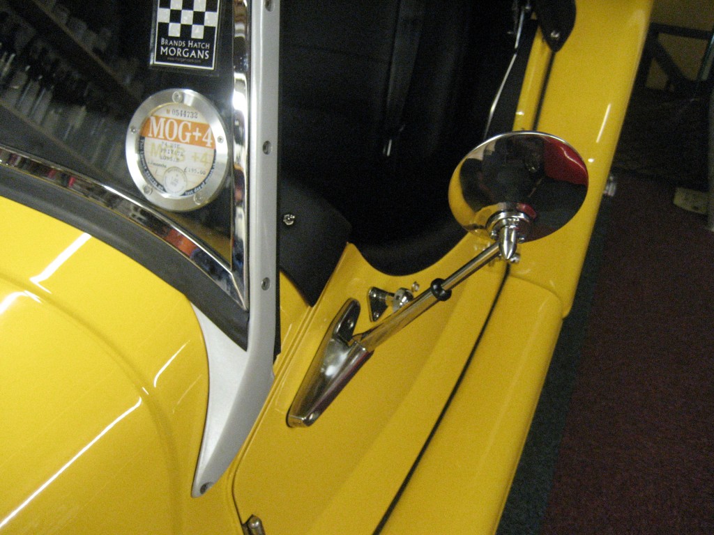

First on the agenda was to replace the door mirrors. I took delivery with the basic oblong mirrors, because I had some HoE mirrors advance purchased!!
The original mirrors are available - obviously the bases are fine, and the mirrors although not widely adjustable are "OK".
This is the Heart of England base.
For a bit of extra protection I added a neoprene strip:
First I did the driver's side. Here's a top tip. HoE sell two types of mirror. I have the standard size on the Roadster and had the same on Bumble. This time I went for the slightly larger mirrors, which have a bullet shaped end to the mounting, and three screws into the back of the mirror head, instead of one on the smaller mirror head. What I found is that because there are more variables, these mirrors were much harder to get adjusted right, and didn't seem to have as much flexibility. But they look the business!
The passenger side was a bit easier to get right. Locktite used on all threads.

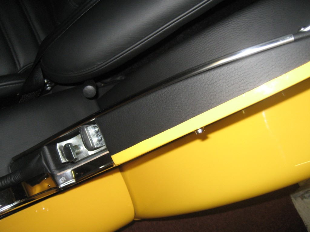

Next I tackled the edges of the doors - my pet hate and easy to fix. The edge of the door is painted timber.......
This needs some fine leather to get the tight folds. Here the leather is face down. I've applied double sided tape and this will hold the folded over leather edges, and also stick the leather to the door.
And this is the finished article. It just curves under the bottom, and makes all the difference.

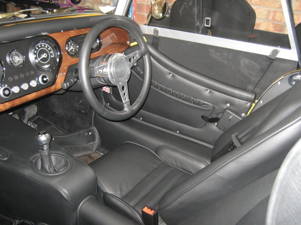

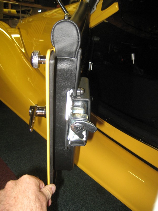

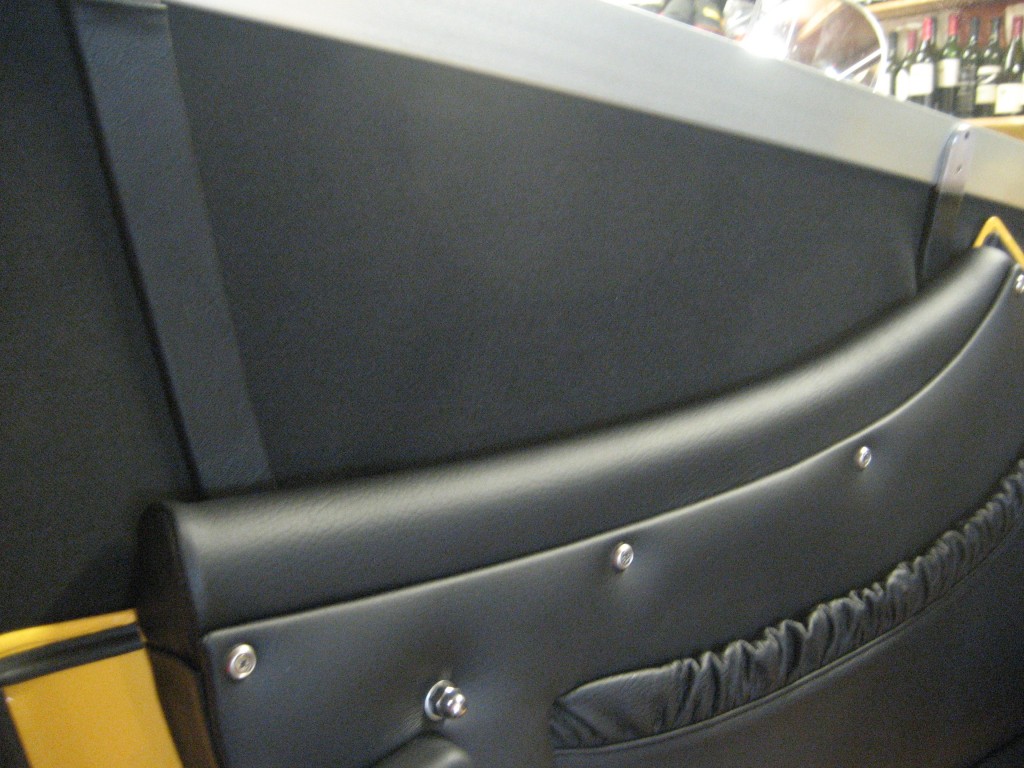

Next I turned my attention to the side-screen supports. I covered my Roadster supports in leather a long time ago but never got around to doing the same job on Bumble.
Again it needs a fine leather and double sided tape. The top edge of the leather needs turning over, and the turnover can be stuck with contact adhesive.
This one is in progress. The short front support is done and the long rear support is ready to be turned over and stuck with DST.
Finished - it looks like this. Worth putting Locktite on the side-screen screws as they can work loose, and also don't over-tighten as there isn't much thread on the supports.

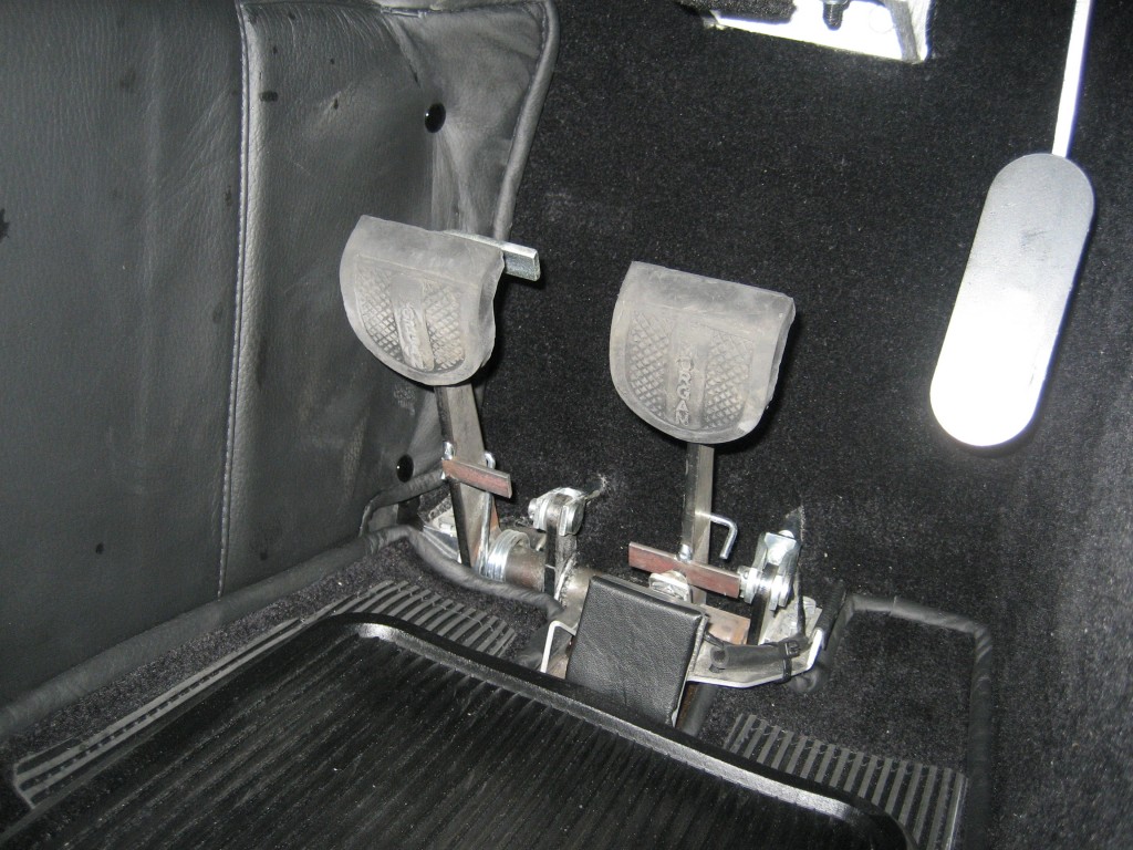

My last job today was to add a piece of leather to the metal plate in front of the brake pedal. It's just a rectangle with some double sided tape.........
Note the fly by wire throttle - plain black metal. We need an aluminium Morgan branded cover for this!

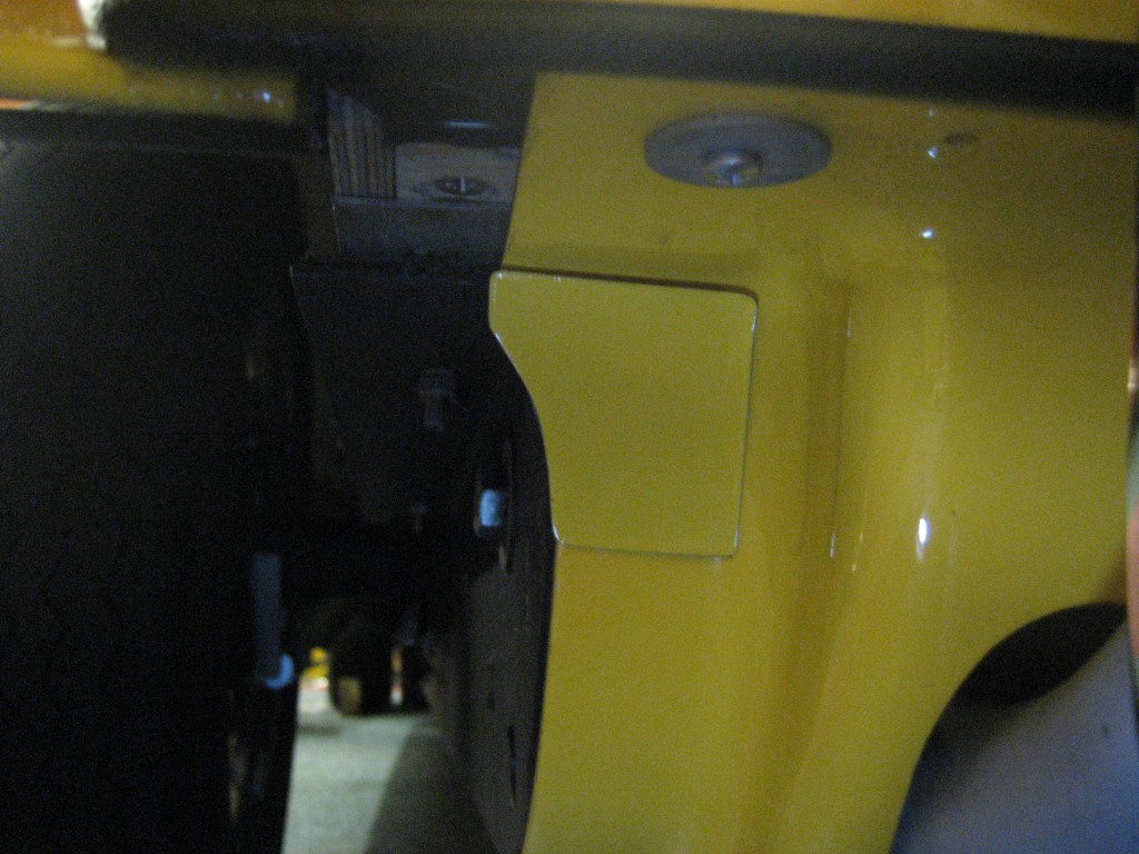

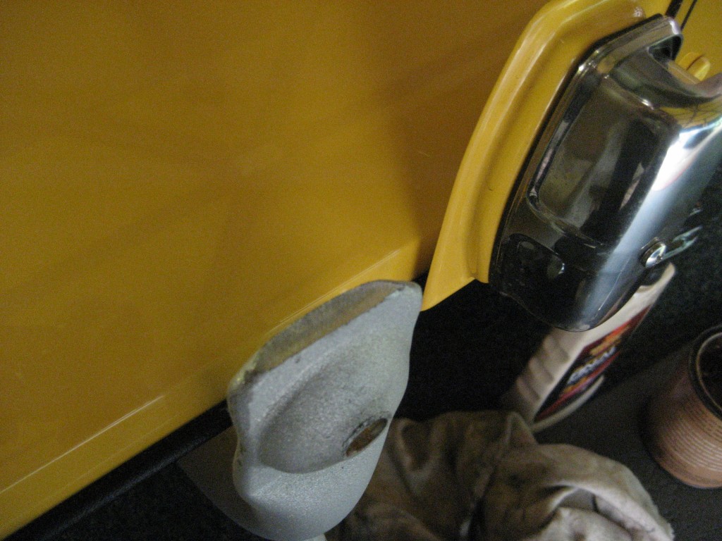

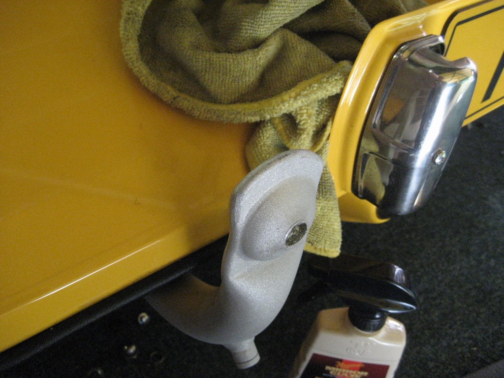

First the rear valance. It has a cut out at each end where the exhaust bracket locates. This is much neater than in 2012:
This is the side which doesn't get used on a Plus 4.
Obviously I don't like a cut out, and on Bumble I added some aluminium covers. They don't have to be too fancy because they are well hidden.
This is the shaped aluminium.
Now painted. The drawing pins are for later use!
And fitted with DST. The other side will follow but with the exhaust bracket it gets cut out with a hacksaw by the look so needs a bit more work.
I use the painted drawing pins with the points cut off and stuck with double sided tape here, after fixing the cross-head screws with Loctite:

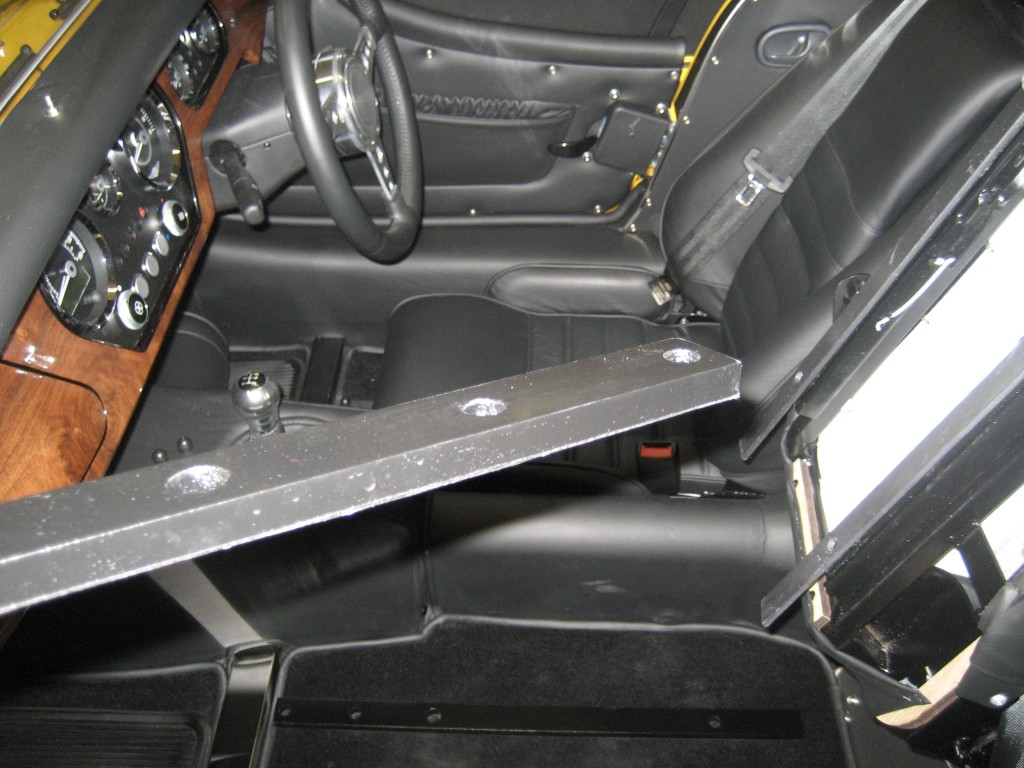

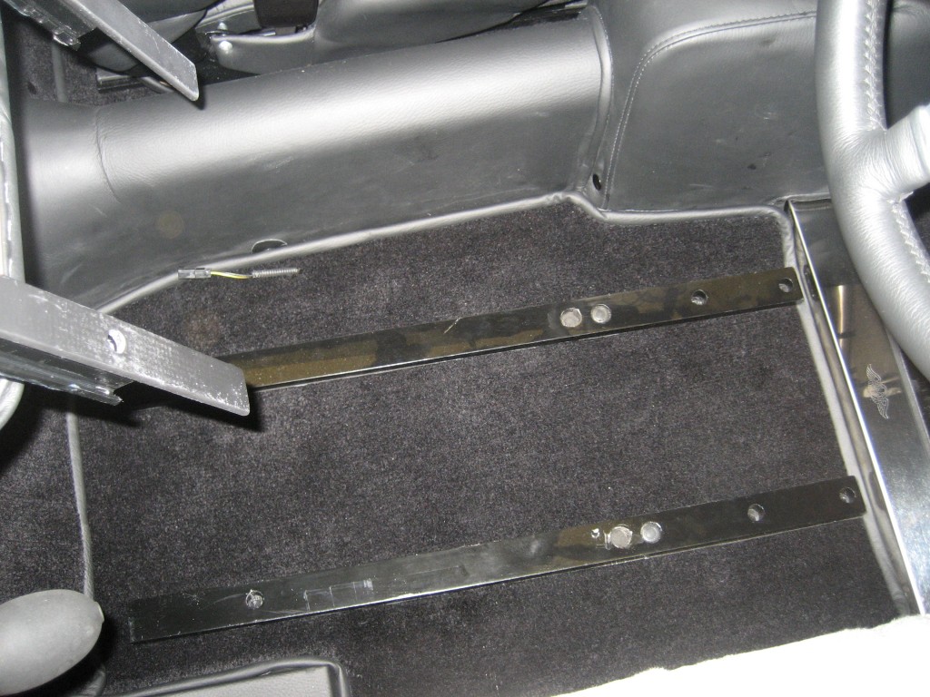

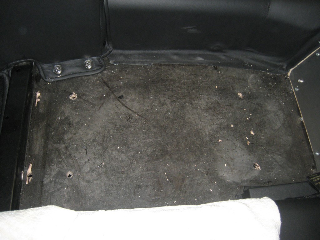

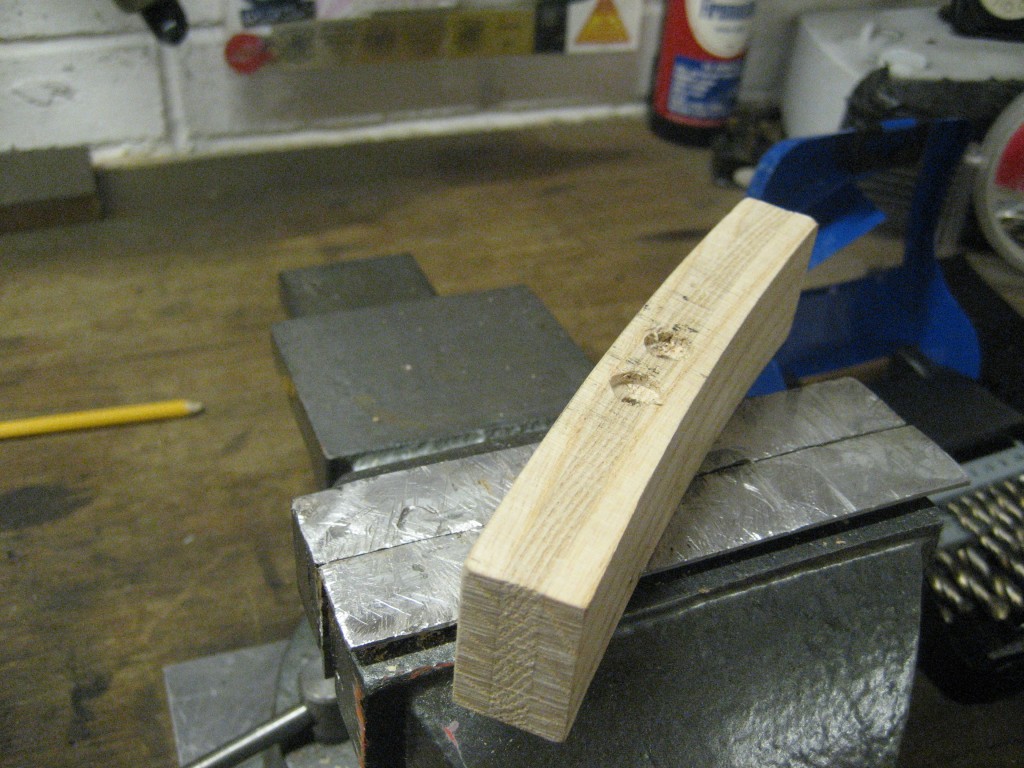

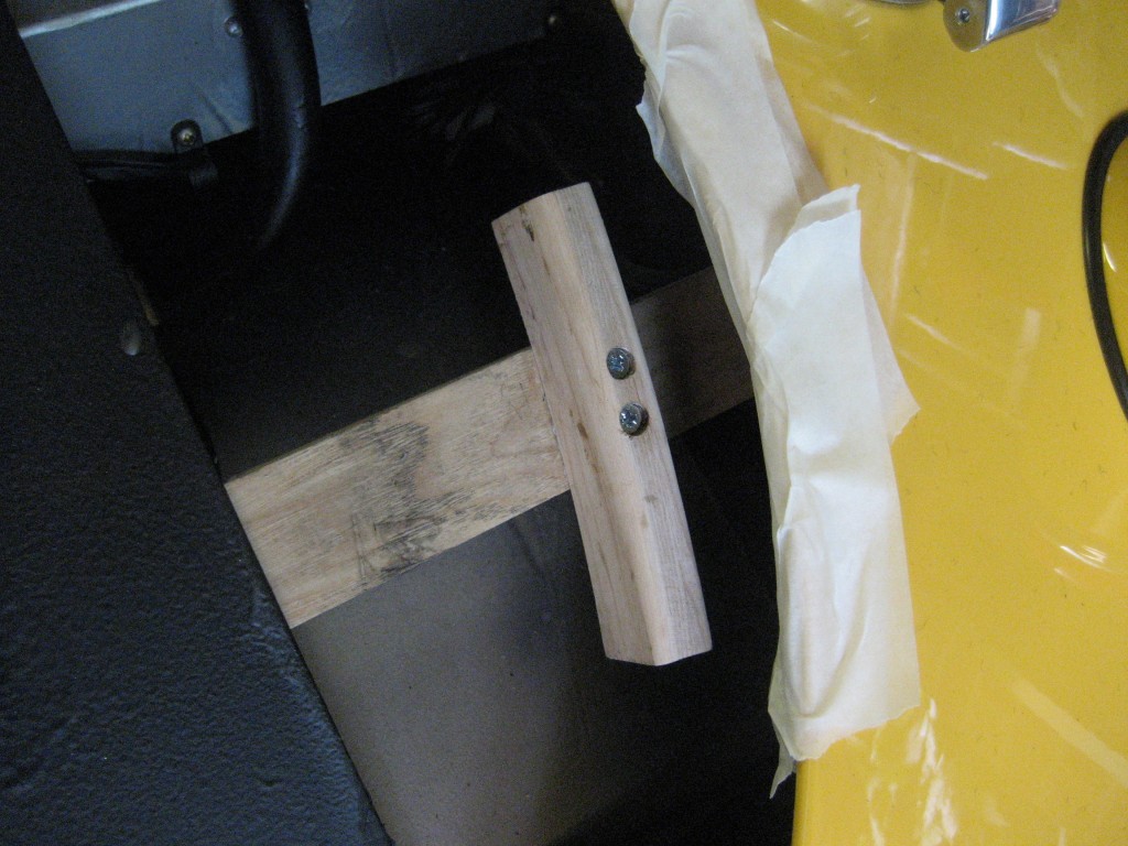

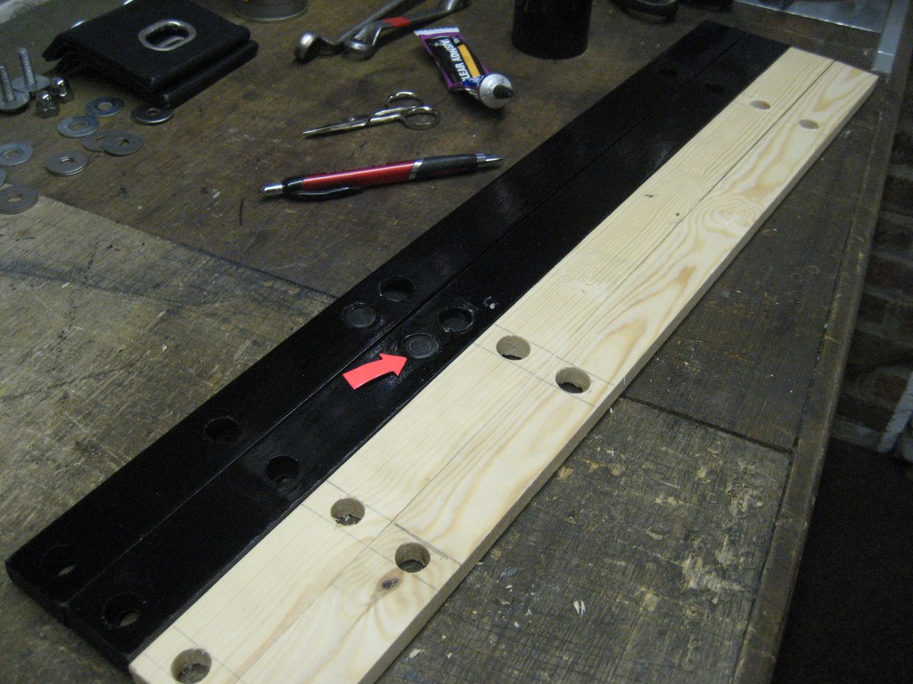

And so to the seats. I like to fit wooden spacers, to accept the protruding nut and to lift the seat a fraction. These are only a half inch. I made them up well in advance, only to discover that the Sports seats have the protruding nuts in a slightly different place, which meant more work.
The seat can be lifted and tucked, reclined, into this position. Safer than lifting it out. The protruding silver nuts are evident.

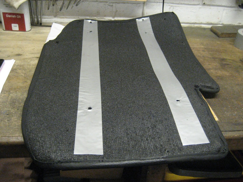

This was the carpet - still showing footprints from the factory.
The carpet will stick to the floor under the runners so I add some gaffer tape to protect the pile.
The carpet is tacked to the floor, I expect so that when the seat mounting holes are drilled it doesn't move.
The floor needed a good vac and I gave it a coat of Danish oil.
Much better now!
This is the spacer, before I discovered that the hole for the protruding nut was in the wrong place......
In the end I made up a couple of new spacers, and used two of my originals. The red arrow shows where the protruding nut lies with standard recliners, and the new holes show where the sports seat protruding nuts are.........

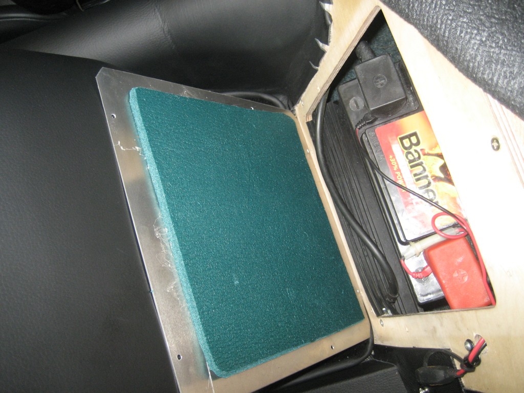

This is the passenger side completed with the HoE cross-member cover. I've touched up some chips in the chassis paint and given it a coat of Tectyl 506 under this cover.
While I was on this side, I added a rubber seal at the battery base - visible here. It stops road dirt splashing up.
Another mod is to add some camping mat to the inside of the cover - insulation and keeps the road dirt out.
You can also see the battery conditioner cable work in progress.....
And here it's all back together.
The driver's side was much the same:
You also have to disconnect the seat belt sensor, wire which is fiddly.
But it all looks much better when back together. Fitting seat spacers means that longer bolts are needed, and even with my extensive stock of different lengths, I still had to order some extra bolts. They are UNF, and the rears are much longer as they pass through the cross-member which takes the seat belts and rear suspension front spring mounts. At the front, the first pair of mounting bolts pass through the cross-member, and the second pair just go through the wooden floor. Sometimes they can be difficult to locate and today they put up a bit of a fight.

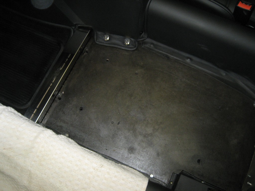

Today I've been fettling the spare wheel area. First I fitted some spare wheel retainers. I did this job to my Roadster earlier this year so I won't go into too much detail this time. The curved ash is from the factory scrap box.
Cut to size, measured and drilled.
Here it is fitted on one side, and you'll see I rounded off the edge as it was a bit too close to the tyre.
The amount of effort this took is obvious here!
But the result is worth the effort:
Here you can see that I've also added four neoprene triangles so that the tyre doesn't rest on the metal plate.

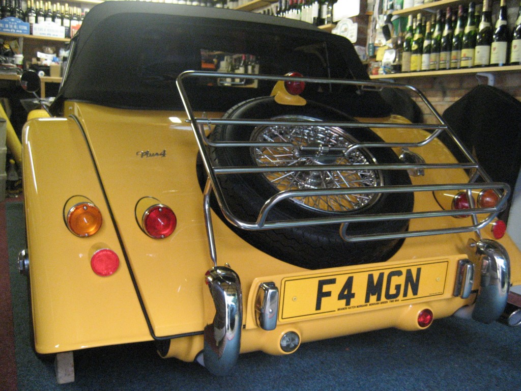

Finally what should have been a doddle - fitting the luggage rack. The over-riders come off with the large visible domed nut and a hidden set-screw under the rubber grommet at the bottom of the unit.
When I fitted a rack to my Roadster way back, it was necessary to elongate the hole in each over-rider bracket because the small set-screw hole on the main bracket was out of line after fitting the rack bracket. So I was prepared for this. But it turned out that the new design of bracket is too tall to fit the rack brackets without some serious filing.
Here's how it comes:
And this is how it needs to be to fit the bracket:
So after a sweaty hour or so, it all went together OK.

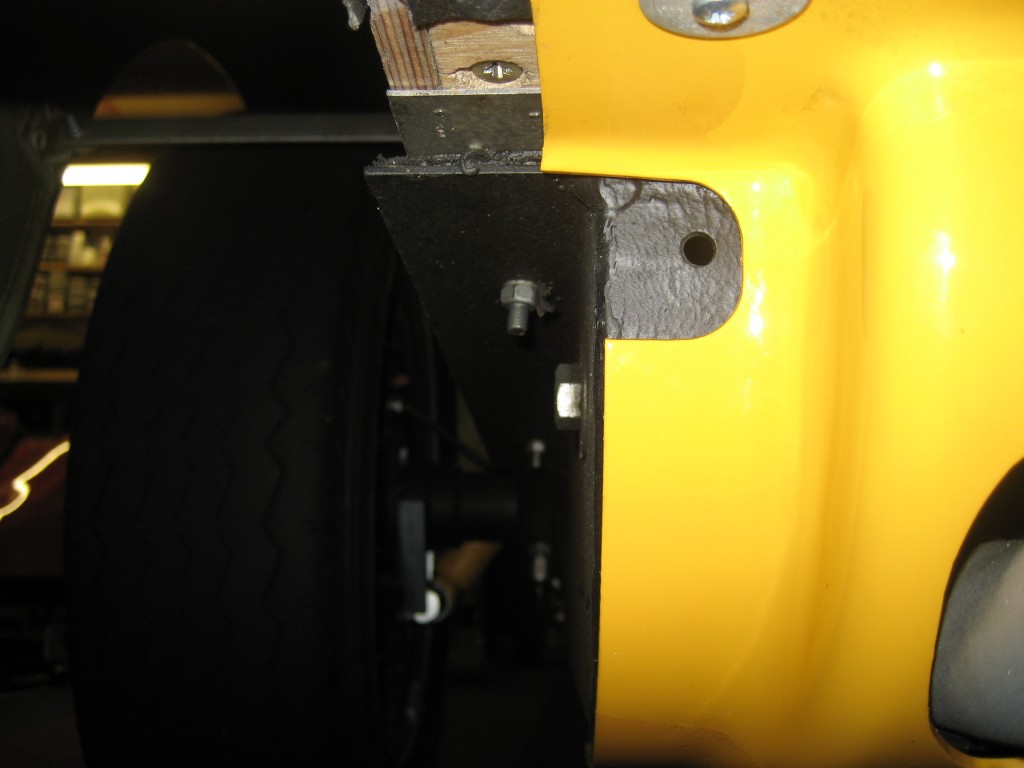

The build number is stamped on each wing - bottom of rear at front end:
Bottom of front - at rear end.
This is how clear underseal looks, but I've since added some Tectyl under the wings.

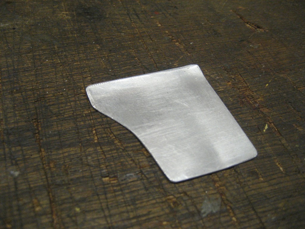

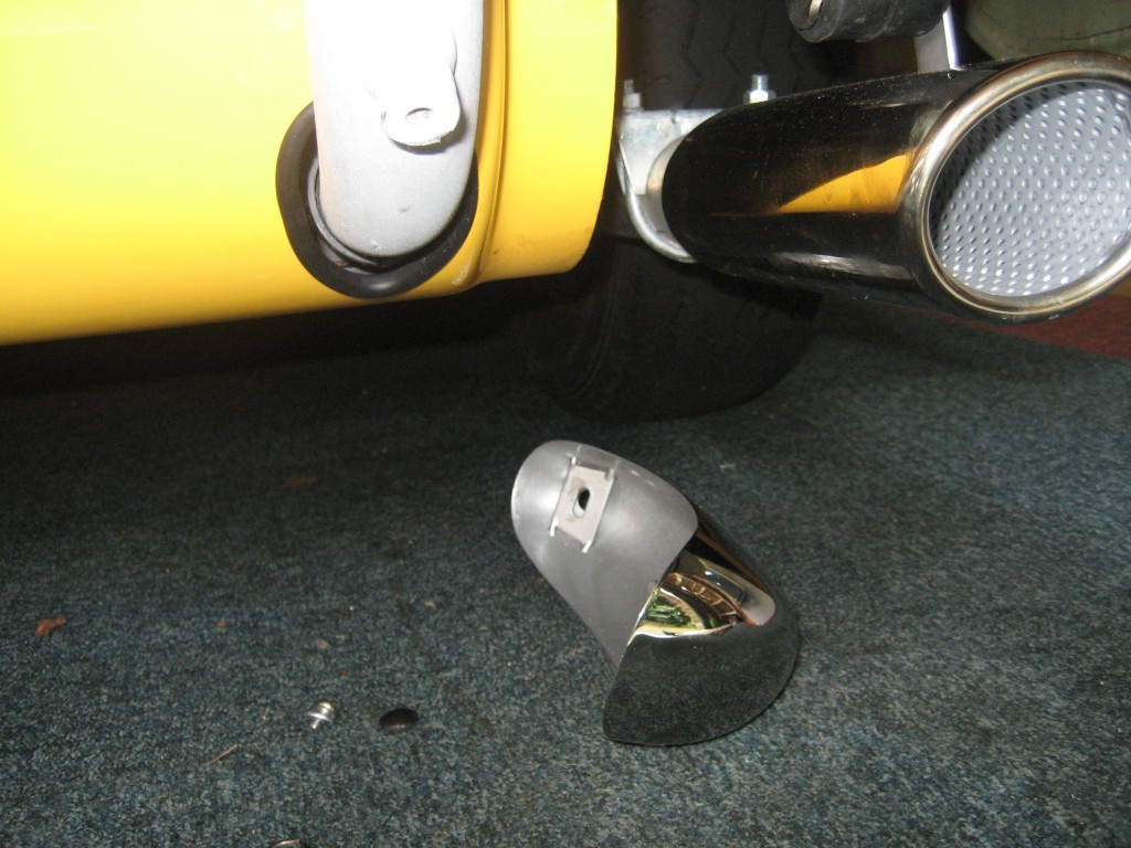

This is the cut out for the exhaust mounting - more Heath Robinson than the other side. You can also see my neoprene edging to the over-rider bracket holes here.
I shaped an aluminium off-cut over a ball pein hammer and was quite please with the shape:
Another look at clear underseal:
This bracket doesn't fit as well as the other side, but both need plugging at the end to stop rubbish getting in. I added a small plug of neoprene on both sides. I'm leaving this bracket alone as the car is under warranty but it's tempting to straighten it up.

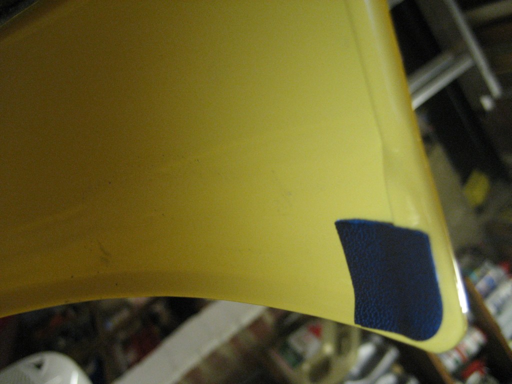

I've added my usual wing end protectors. You don't need to disturb anything, it fits over the existing bolt ends, and nuts & washers go on top. This shot shows that the Tectyl has coloured the underwing area golden brown, which looks better.

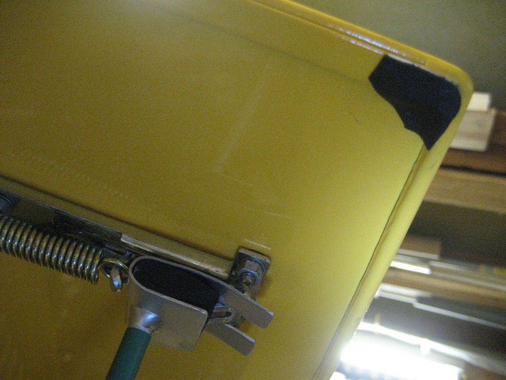

Next I added some L section neoprene strip to the side-screen channels:
And fitted two Lucas horns, sourced from e-bay.

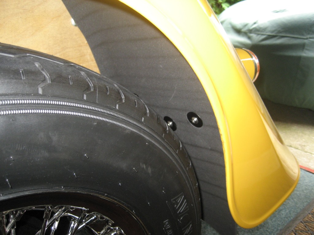

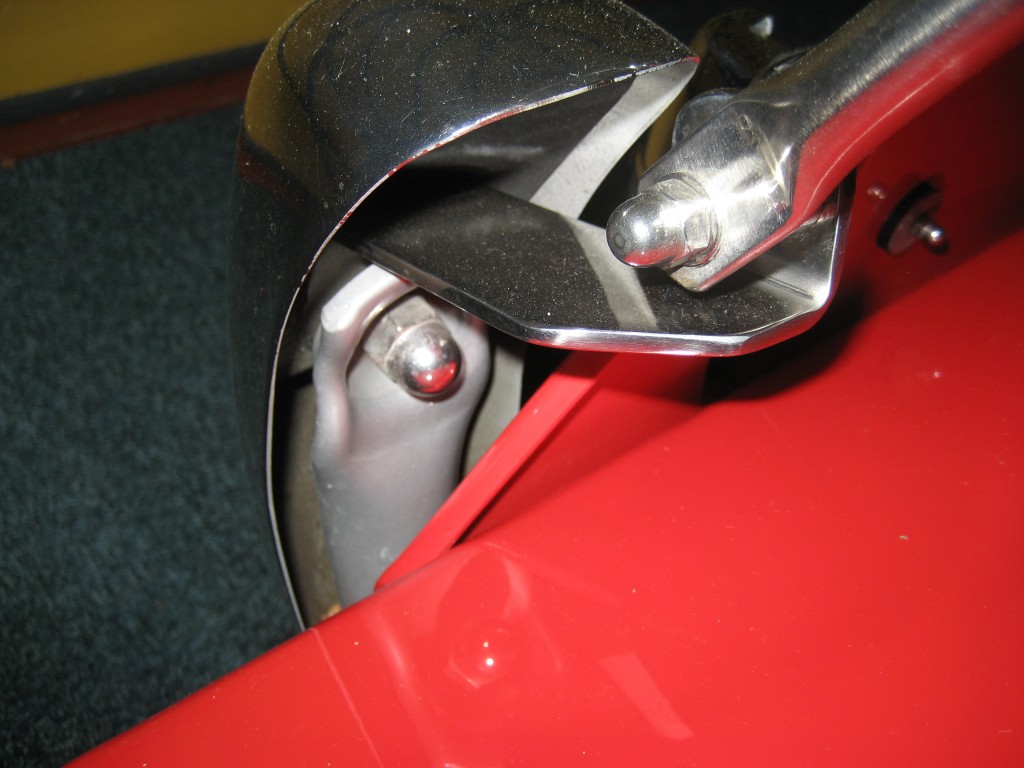

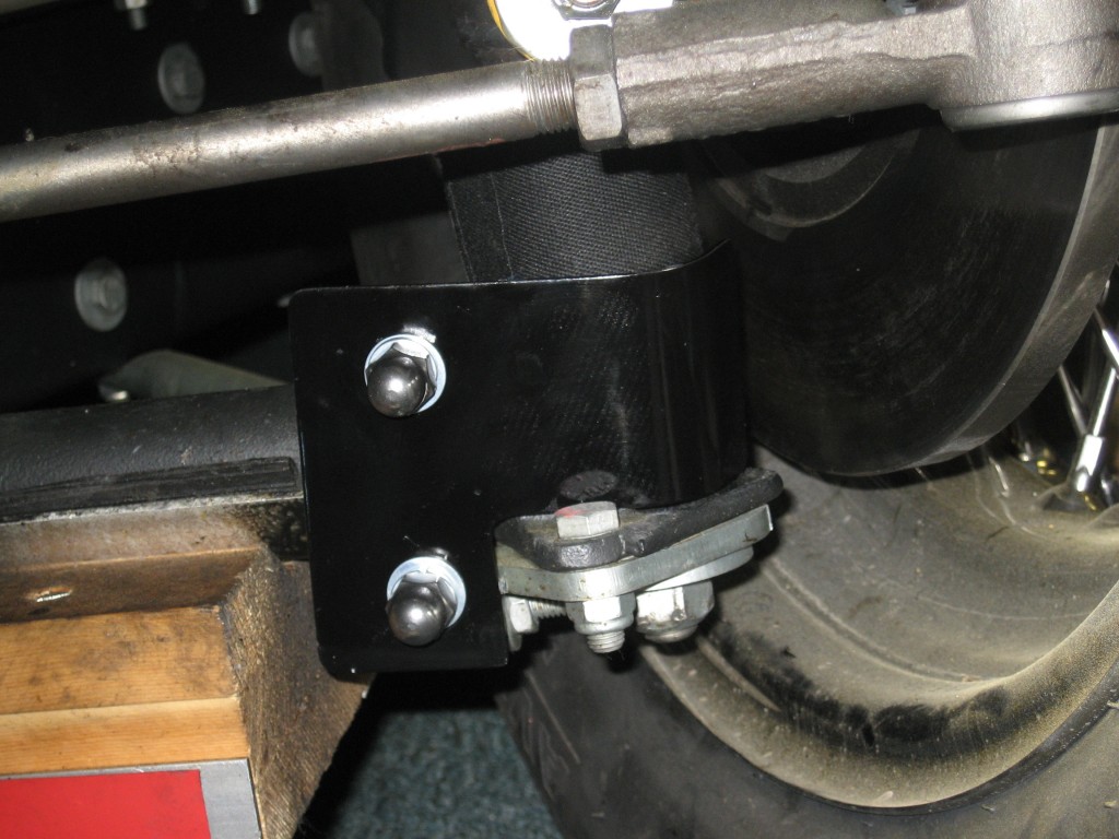

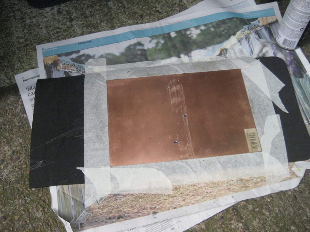

Rear wing protectors came next, once again based on Maplin's circuit board which is light and just the right size. This is a simple and straightforward job.
This is the back. The leather strip is where the wing stay fits. Two stepped penny washers above and one below holds it firm.

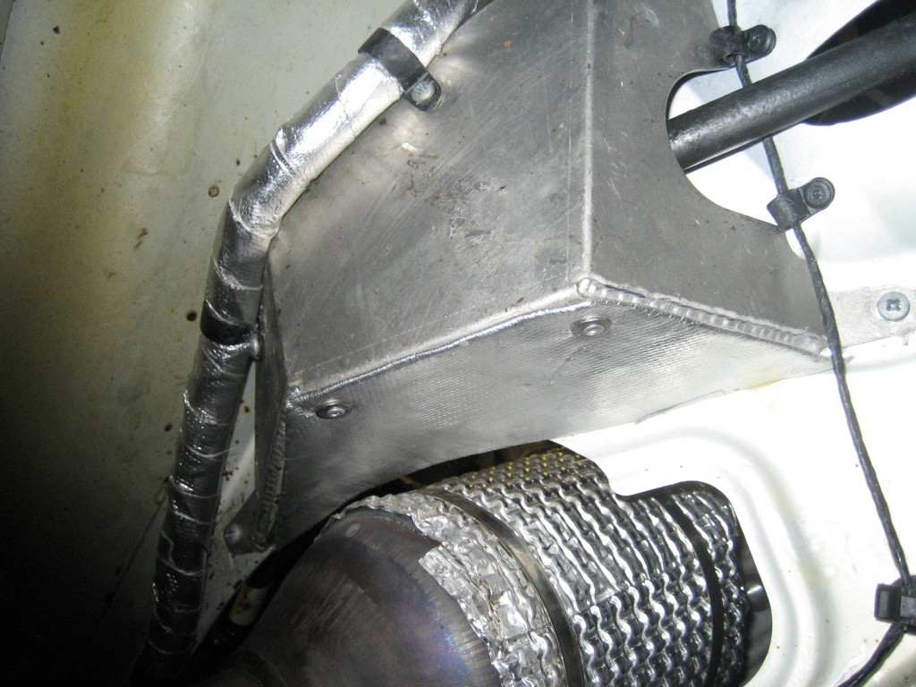

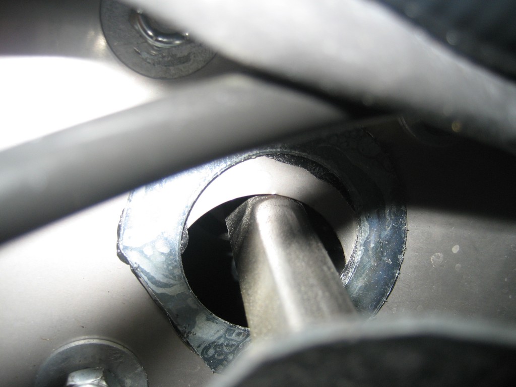

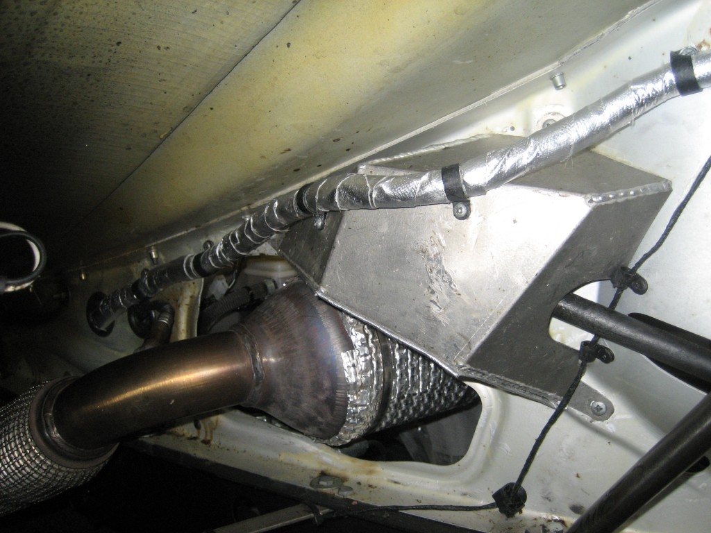

This is the box around the steering UJ's. It's much bigger than the 2012, and 2005 boxes. Here is the 'after' picture. The wiring loom is protected above the cat, but I've added some 'Reflect-a-cool' to improve that. I've also added some insulation on the bottom edge of the box. With the UJ's so close to heat it can cook the grease and wear the UJ prematurely, so for the sake of a bit of disassembly.....
Note also the big hole at the front for the column.
I sealed the hole with a leather grommet.
This is how close the box is to the cat.
I also insulated the first section of fuel pipe. To do the rest I will have to remove the exhaust so not now......
The inside of the box...... nicely made.
