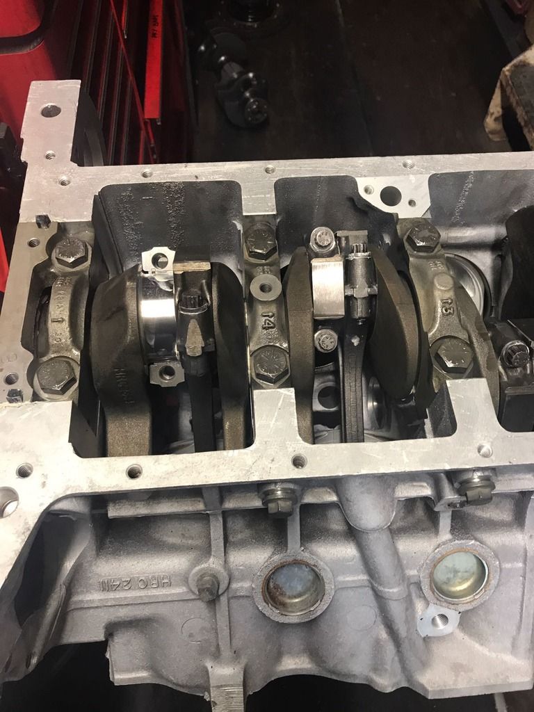

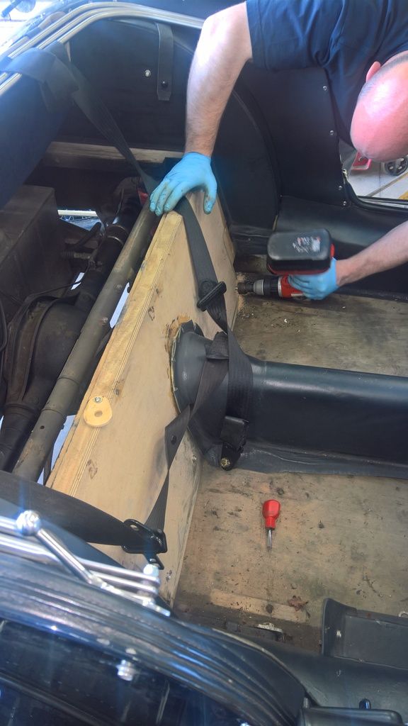

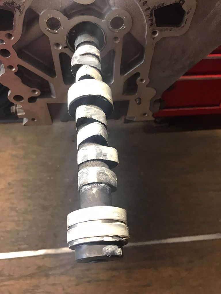

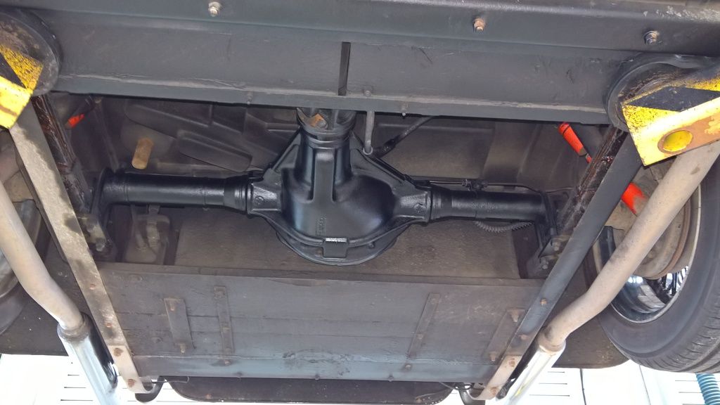

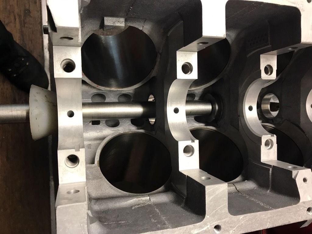

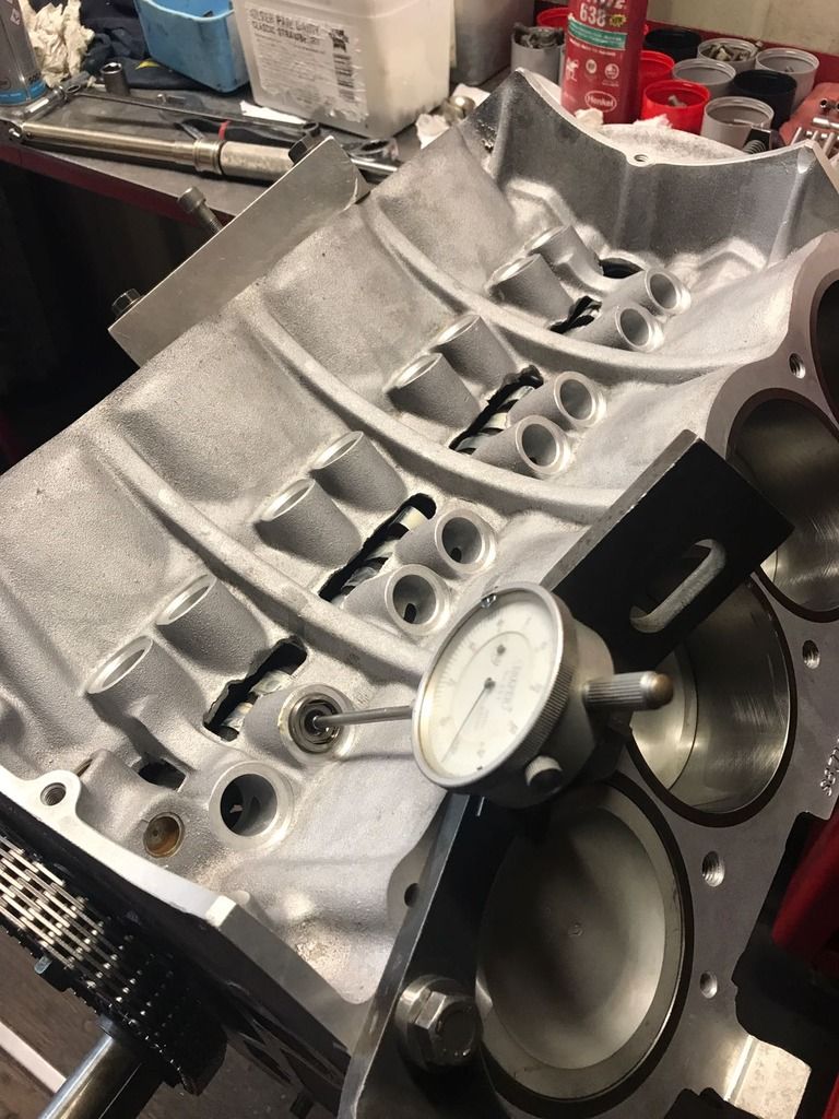

A few pictures from the engine builder and the anti tramp bar fitting, still lots to do and only three weeks 'till Goodwood!

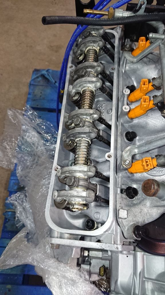

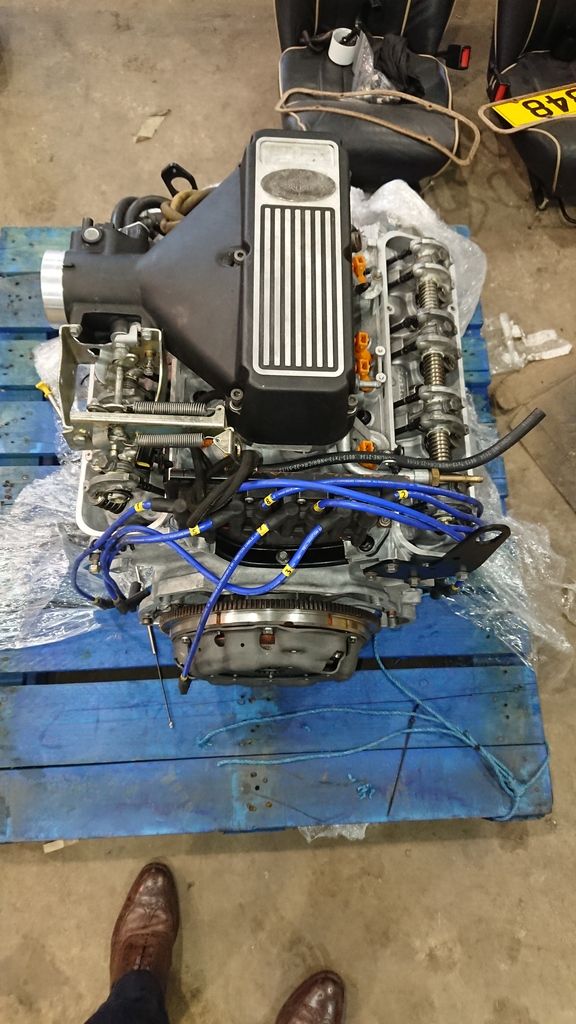

The engine arrived yesterday and looks great (rockers have gone for painting.) Ray from V8 Developments has been great to deal with, but the proof is in the pudding! So far, everything looks fantastic.
Brakes due today, steering wheel and reg plate due next week.... then let the fun commence!
