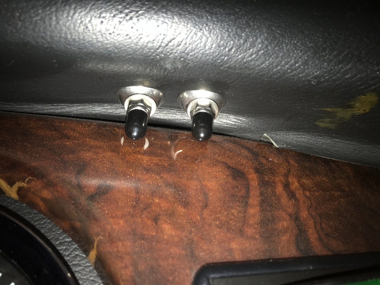

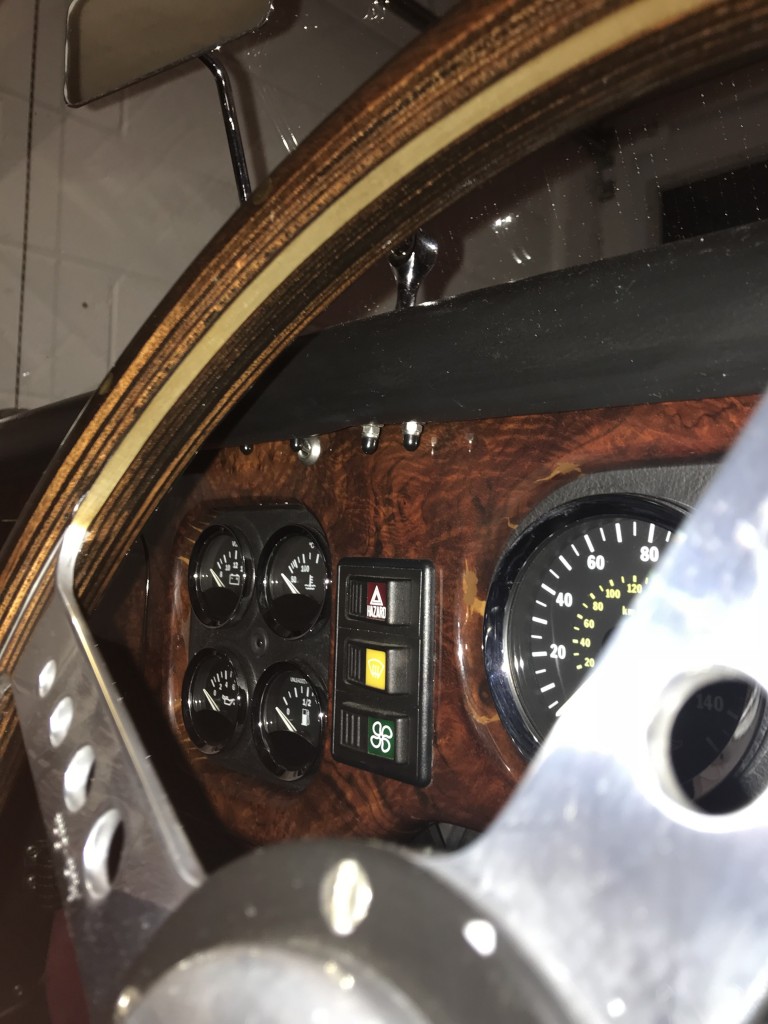

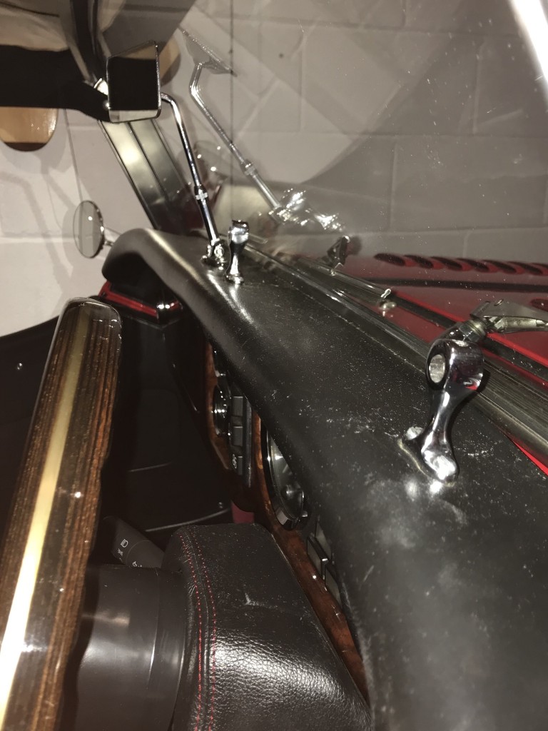

Thanks for reminding me, I was going to post some photos of how I fixed my aeroscreen feet to the crash pad
This is only applicable to Morgans which don’t have the windscreen heater vents on the crash pad as the distances in relation to the dashboard are different
Mine Is a year 2000 car with the heated screen
I drilled the bulkhead through the crash pad just forward of the dash, put bolts through retained by a large washer and a dished counter sunk washer (wish I knew what things are called) and nylock nut
Cut the excess bolt length off with a dremel (protecting the dash with tape) and put some black nylon threaded bar caps on the end to look neat (ish)

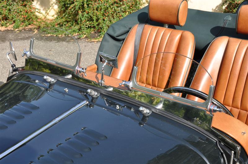

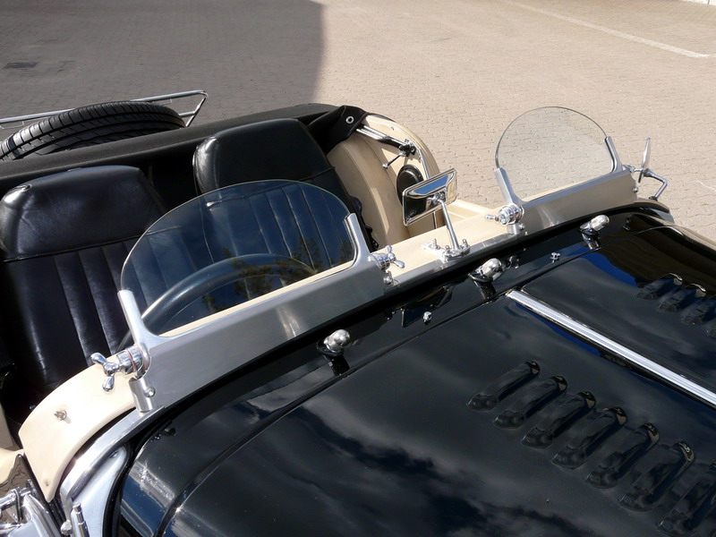

Richard,
Found these on previous posts
Have been considering this alternative to the folding screens.
