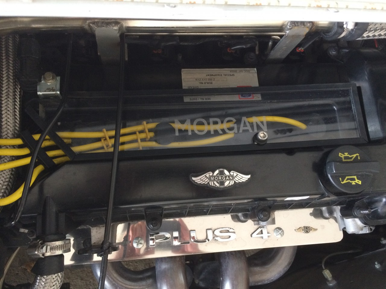

Rain in Spark Plug Channel;
Cheap mod (£7)to keep water out of Spark Plug recess: 5mm polycarbonate, rubber edging, frosted glass decal, 1 hour of work.
Looks good. Tested and problem solved.

Very nice looking engine top , lots of nice badges too !

Neat..are the yellow plug leads standard? They add to the look!

No I ordered the leads separately a couple of years ago.

Have you taken the bonnet assembly off to get vertical access to you spark plugs?

That looks brilliant. I will certainly have to try and copy it during the winter.

Nice work thumbs

Could you please point me to a supplier of the polycarbonate that you used for the plug cover.

Sorry been away.
I made a cardboard template, then did a drawing and sent to:
Perspexsheet.co.uk
0845 600 6221
5mm Polycarbonate.
Got the "Morgan" transfer/decals from a vinyl priter. Frosted glass vinyl.
Regards
Ian
Cost peanuts
