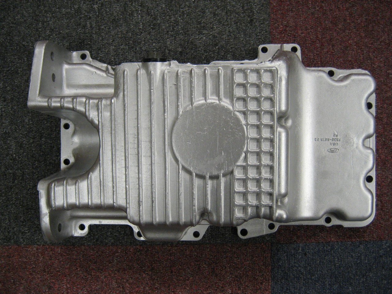

The Sump..........

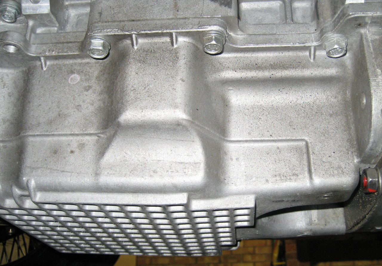

It looks like this:
The slope towards the offside is obvious and the strengthening hatching on the underside looks like a large Waffle.

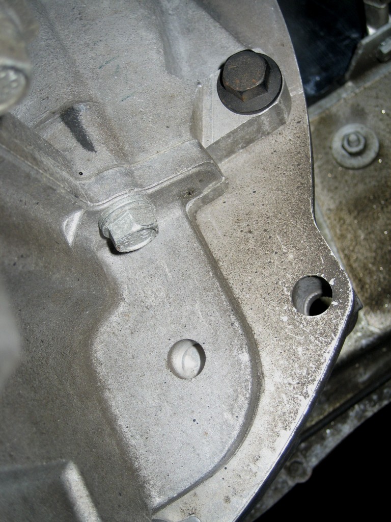

The V6 Duratec was not designed to fit the Getrag gearbox, which is evident by some anomalies in the fixings. The first photo shows the offside edge of the sump, where it meets the bellhousing. On the Mondeo, the second open hole in this photo is used to fix the engine to the gearbox, but in the Morgan, an extra hole is drilled and a 10mm bolt is used, which is probably over-engineered, as it's only holding the two parts together.
This is how it looks from the bellhousing side, and you can see the mismatched shape. Also visible is the rear of the large waffle strengthener, and drain plug.

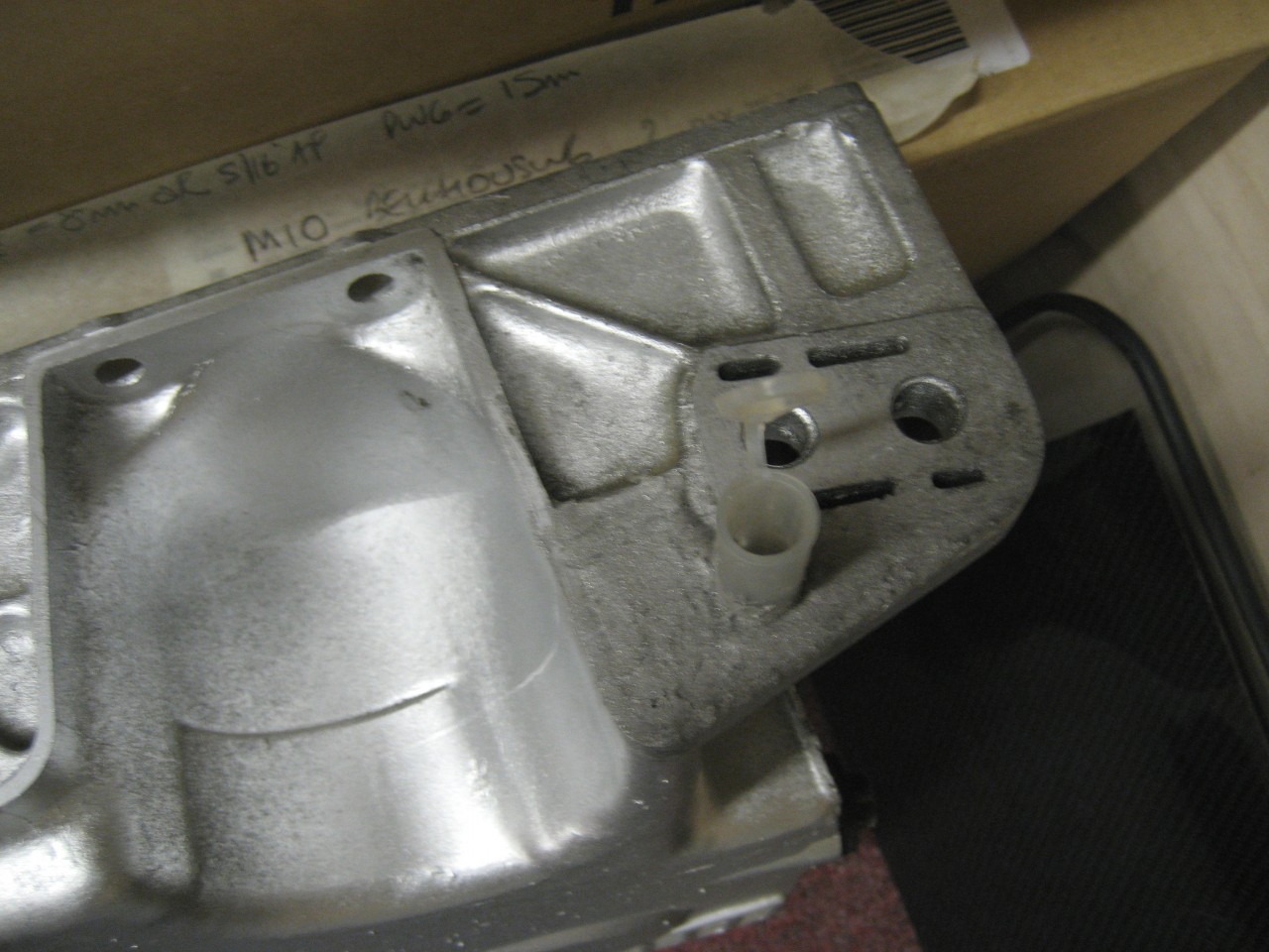

This is the same side of a Ford sump - and there's no third hole.

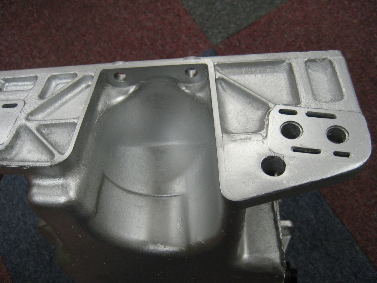

From the other side it looks like this, and the location of the missing third hole lacks re-inforcement. This is fixable, but more of that later - not today.......

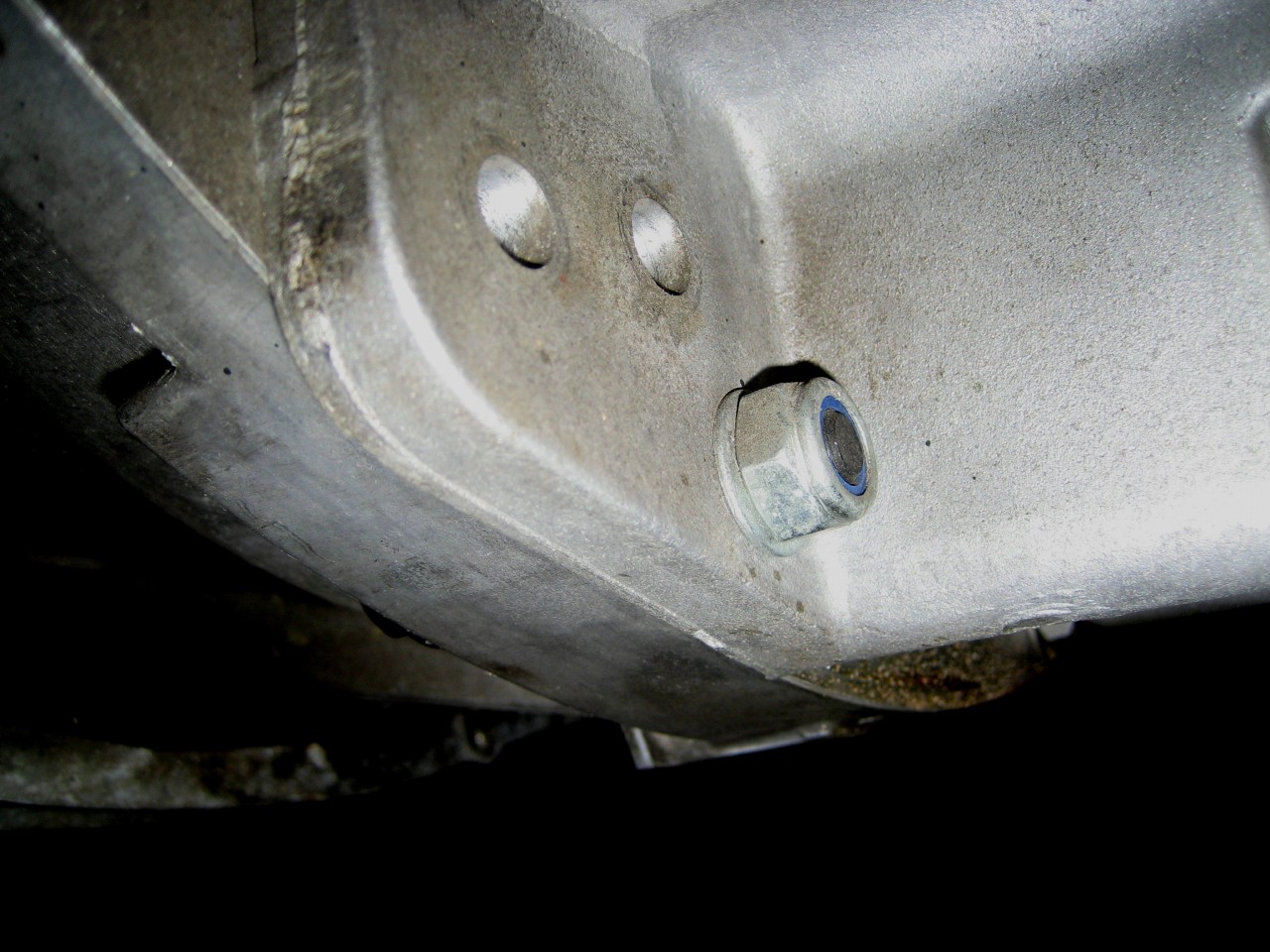

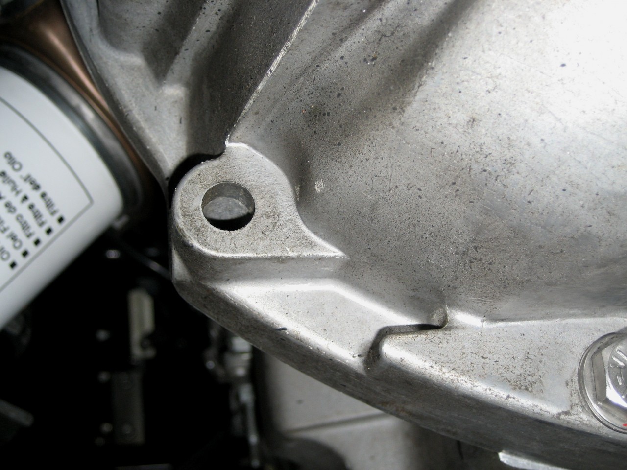

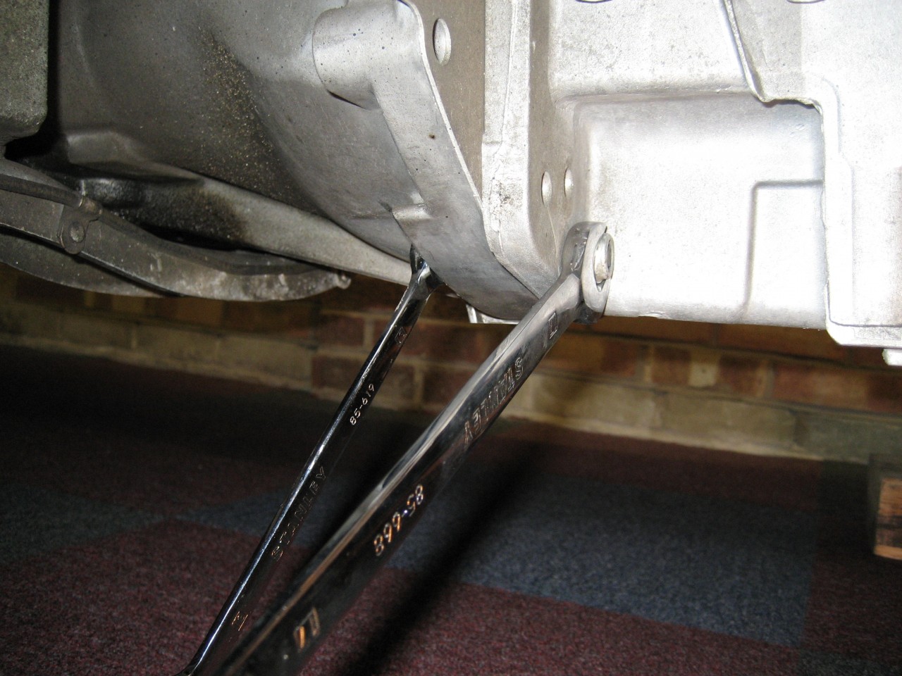

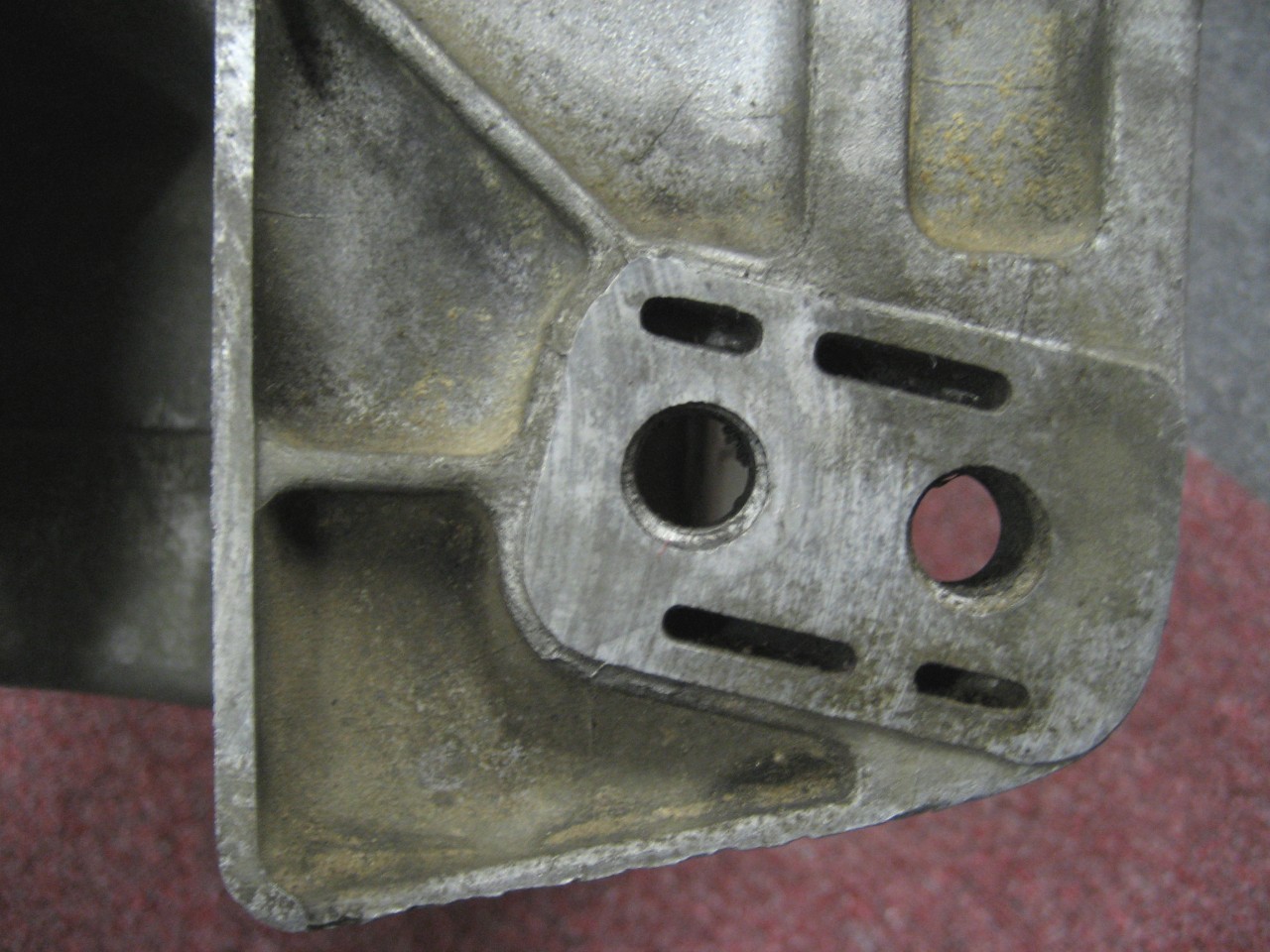

On the nearside,this is the lower mount on the edge of the sump. The left hand hole is used on the Ford, but on the Morgan it can't be used. and neither can the bellhousing hole, so neither is used!!
From the other (bellhousing) side looking forward:

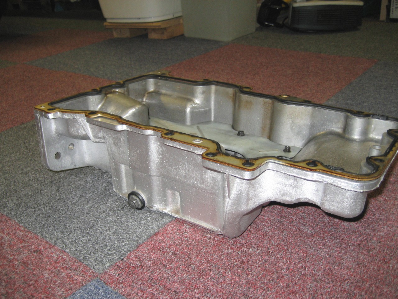

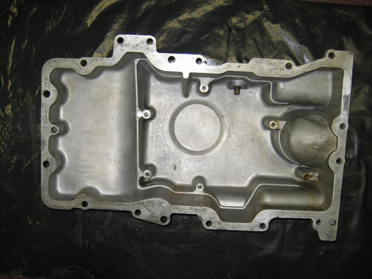

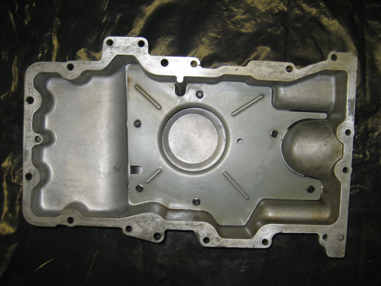

And here's the inside, with the baffle plate removed:
Note the centre oil pick up.

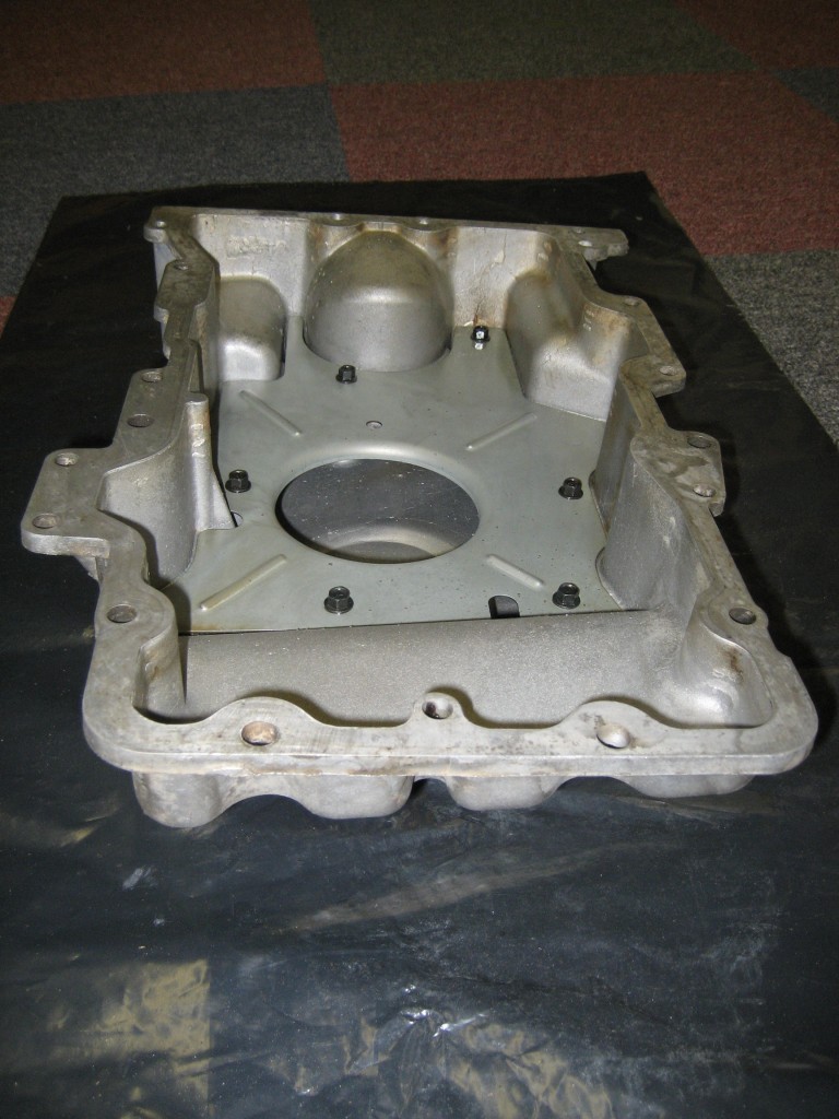

This is with the baffle plate fitted:
The front pan is shaped to drain oil to the rear, and to the offside - left side in this photo.

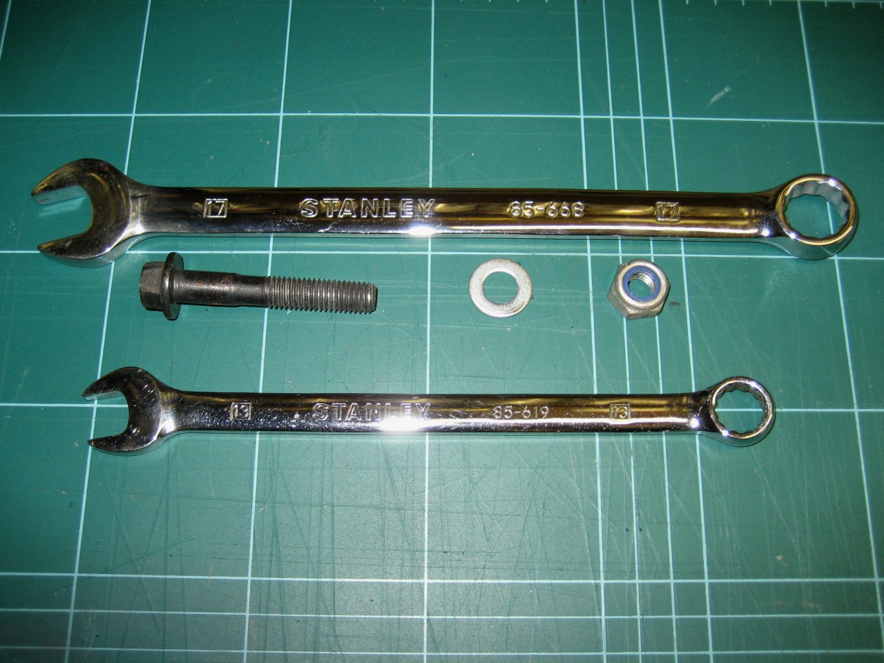

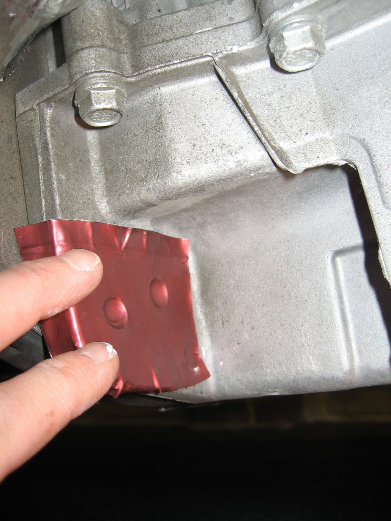

Busy day today, so not much done to the Morgan. I did manage to take that Series1 specific nut & bolt out. It's unusual in having a 13mm bolt head and a 17mm nyloc nut.

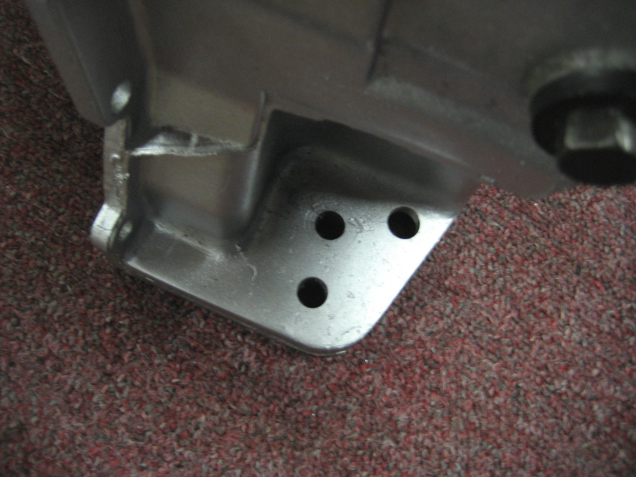

This shows the sump flange with the bolt out, and you can see that the casting has been thickened up for the extra hole. You can also see that the bolt has chased some threads in the alloy. I'm guessing that the hole was drilled after the engine & gearbox were mated (from the rear). The hole is slightly undersize for that size bolt.
Here I'm using metal foil from a wine bottle to make a template for when I drill the extra hole in a spare sump. This foil is just right for keeping shape, so it can be moulded round the holes to transfer the location.

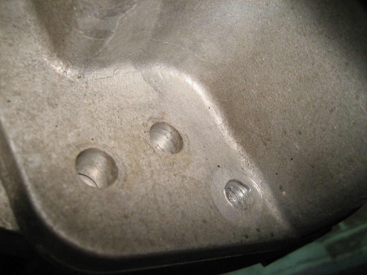

Well, I've prepped the spare sump for emergency use, and drilled the extra hole using the template.
Round the back it needs strengthening, and I've taken the easy route with JB Weld. This is so that when the nut is tightened, the filler will not compress, and stop the flange cracking.
Finished off........compare this with the photo in the first post.

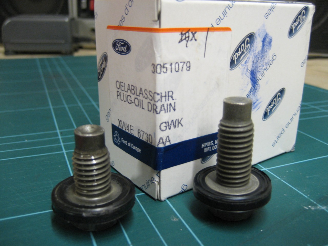

Now the question of the sump bolt. There are two sizes, 21mm & 28mm - and I really can't see what difference it makes.......3051079 is the 28mm version, which comes in this large box. Look carefully at the integral neoprene washer and you'll see a small raised lip. This is what makes the seal, so providing it's undamaged, the bolt will be OK to re-use.

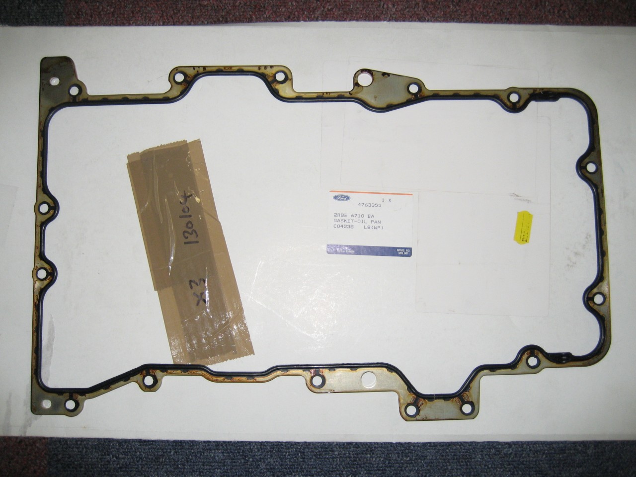

Next the gasket. Two were listed for the ST220, and I went for the post 2003. The part number for this is 4763355, BUT there's a big but............
I hope it's obvious in this photo. The gasket is a composite alloy/neoprene (and is over £40.........). The thickness is at least 2mm and if this were fitted to my Mog it would be visible as a sandwich plate. No gasket is visible. I therefore conclude that in order to increase clearance, a paper gasket is used on the Morgan.

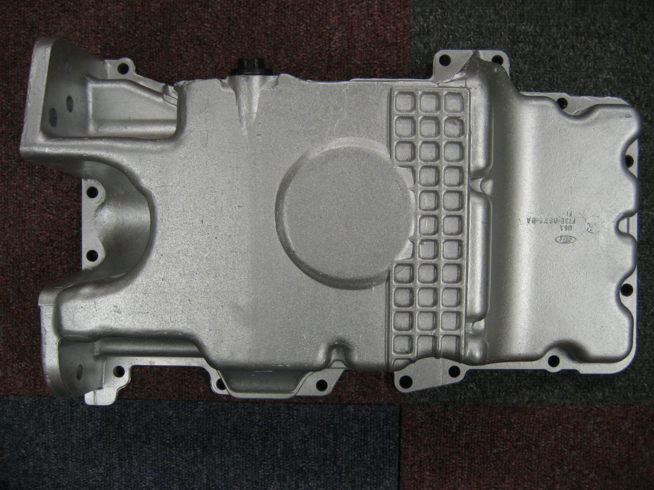

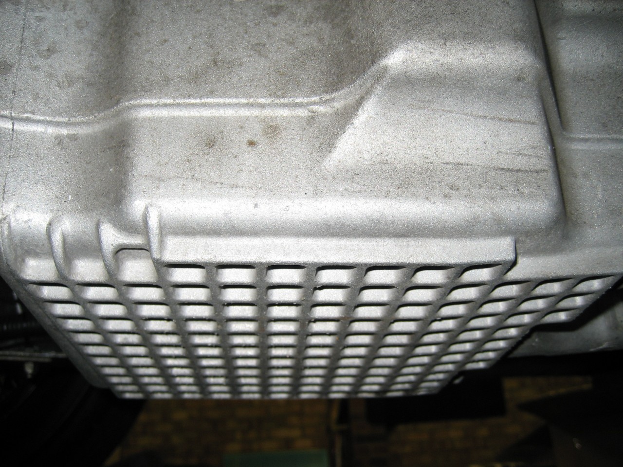

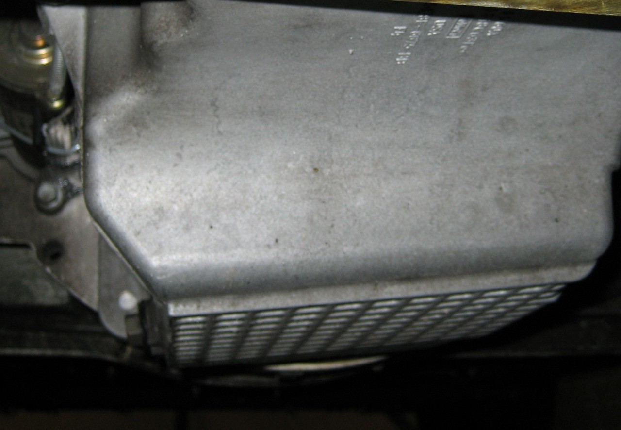

You should all know what the standard sump looks like.
Lets call it a 'full waffle' design.
The front is smooth....

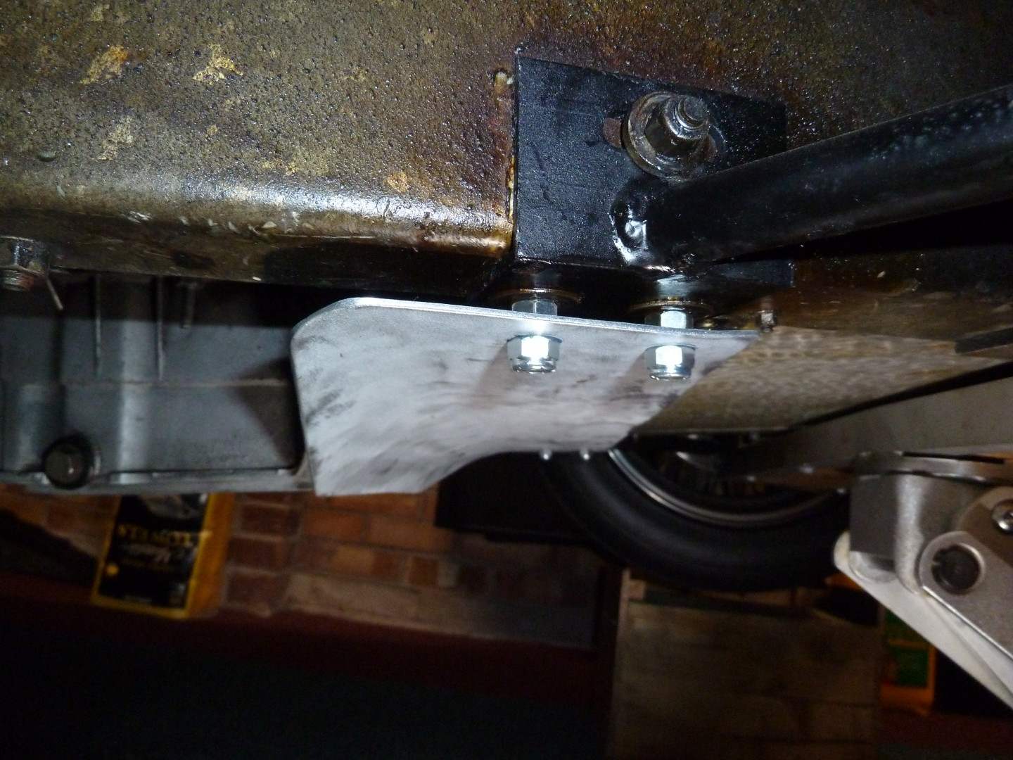

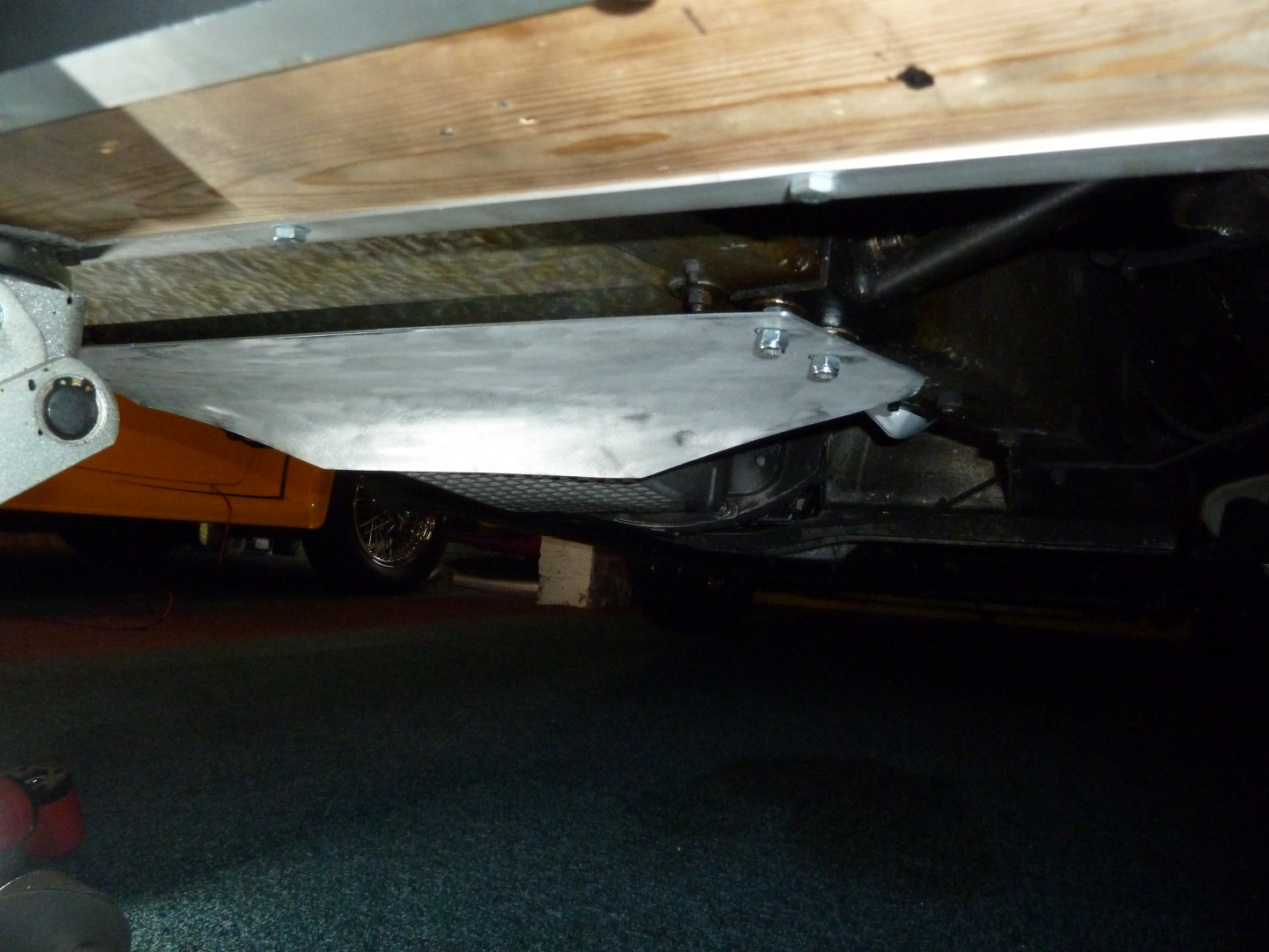

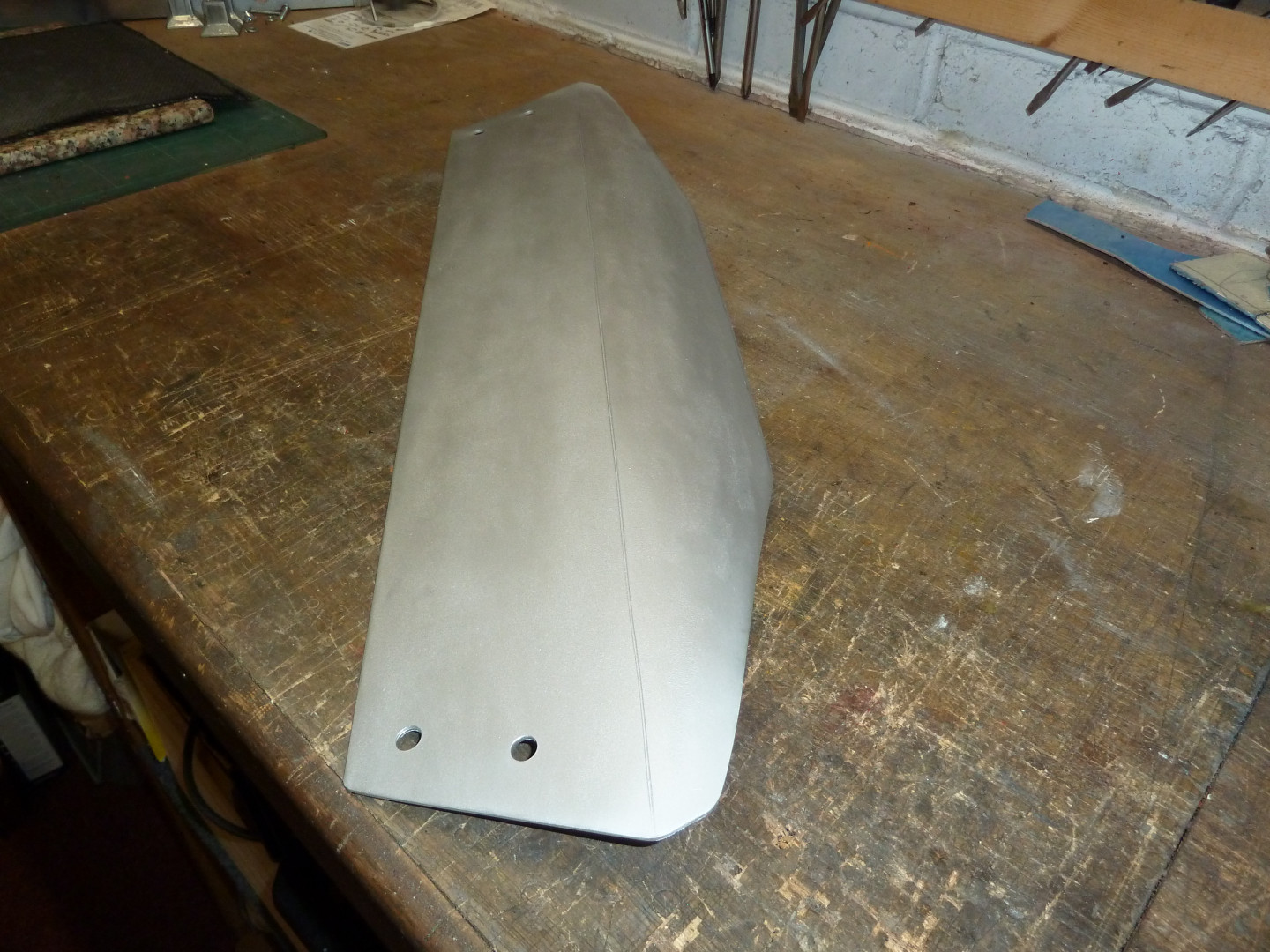

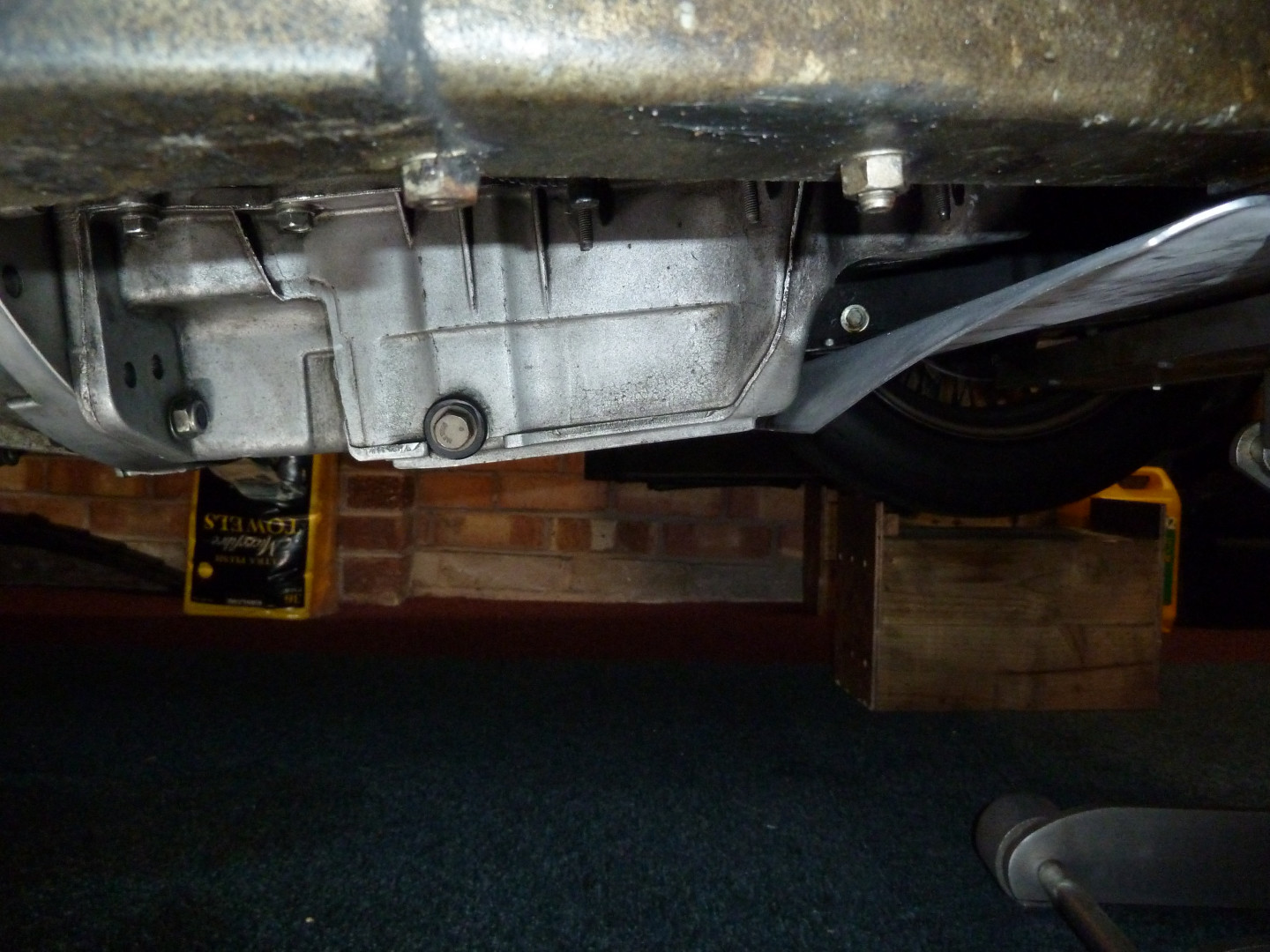

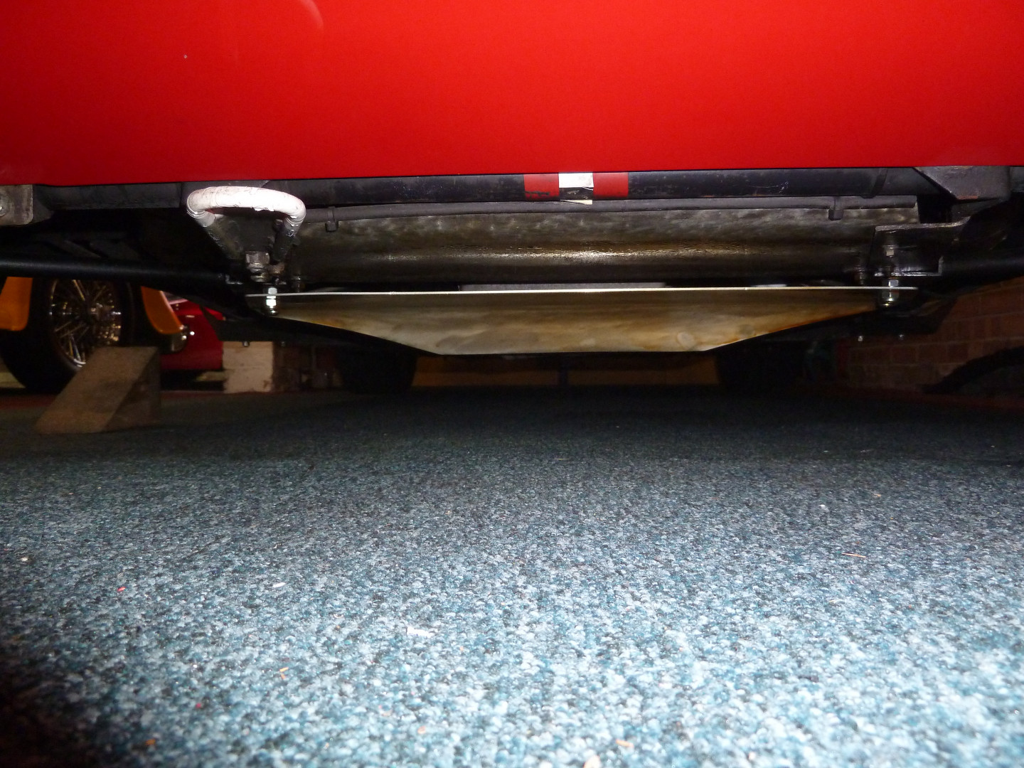

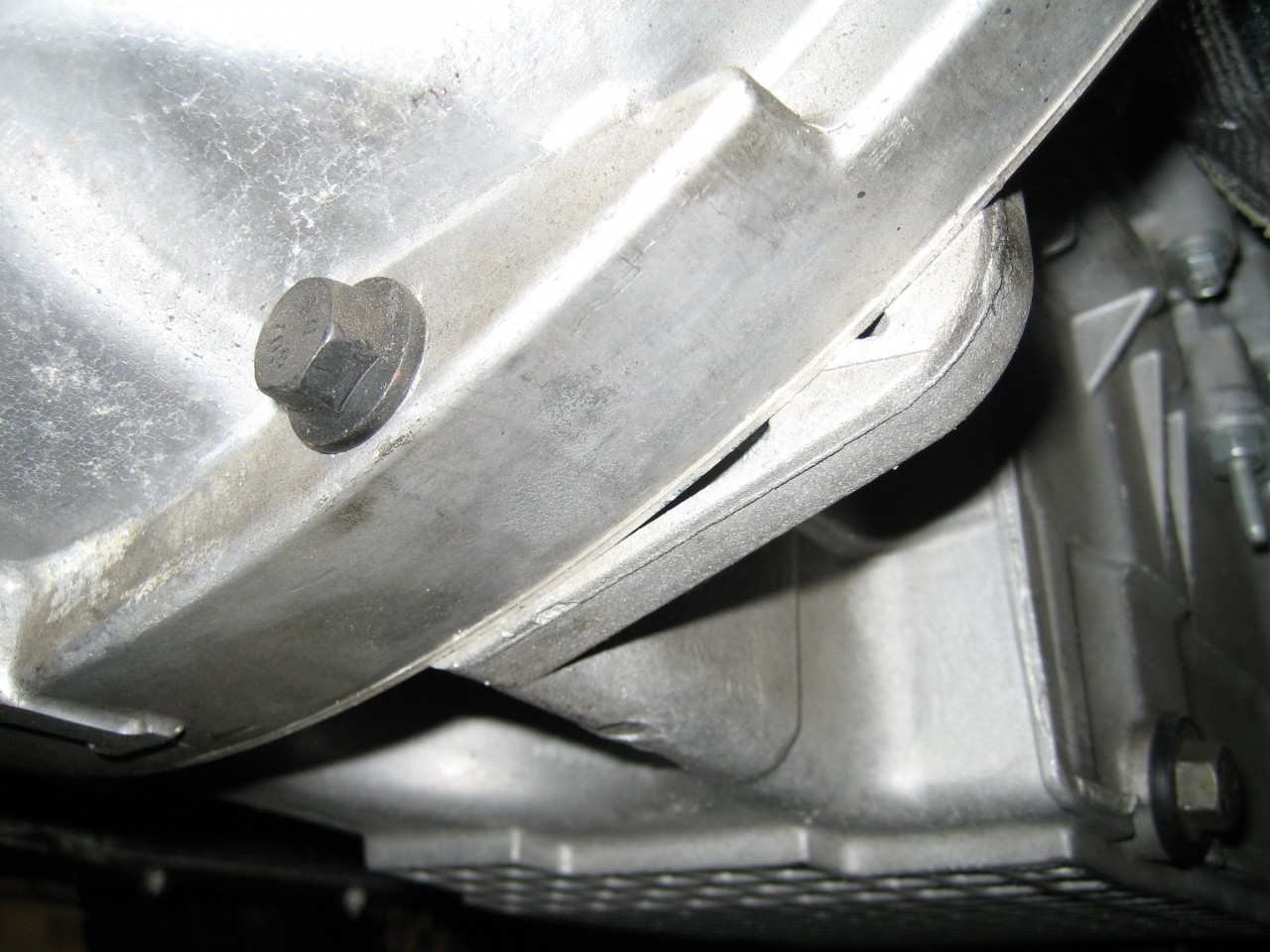

So after 13 years, I decided to add a sump "snowplough". By this I mean a curved plate ahead of the sump, to deflect any road debris away from the front edge. Very occasionally I've found a brick in the road, or something dead, and the casting is fragile, so a bit of extra protection won't go amiss.
I decided to use 2mm Aluminium, despite advising myself and others not to use 2mm. because it's so difficult to bend without a metal bender. But it needed 2mm for a degree of strength. Having made a cardboard template, and got the shape and size right, I then tried to add a clean bend. It didn't work. In the end I used the garage door as a vice, and slowly added a curve. It was laborious.
But when done it looked like this
On my 2005 Roadster, the crosshead stay bars are fastened (each side) with two nuts and bolts vertically through the chassis, and one horizontally. The two vertical fasteners are ideally placed to secure the plough. However, later cars use a single vertical nut & bolt to secure a different stay bar with a slotted end, which is not as convenient.
To get the right depth, I changed the original bolts for longer, and then mounted the plate over the existing nuts.

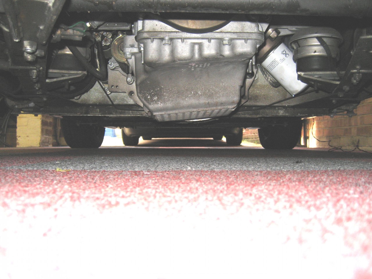

Ground clearance, with my raised engine mountings, is 3&5/8", or 93mm. It's not much.
Do not confuse this simple plate with a steel plate sumpguard. That was not my intention. This addition is simply to provide another layer of protection against minor road debris, some of which is impossible to miss, especially in the dark.

That should work, and if you do hit something unyielding, make a wonderful noise!!
Posts: 22,366
DaveW Offline OP
Posts: 22,366
Like a bell..........

I don’t think Dave’s design reduces ground clearance. His use of the term “snowplough” and the pictures show that his solution is a deflector - not a guard - and does not reduce ground clearance.
