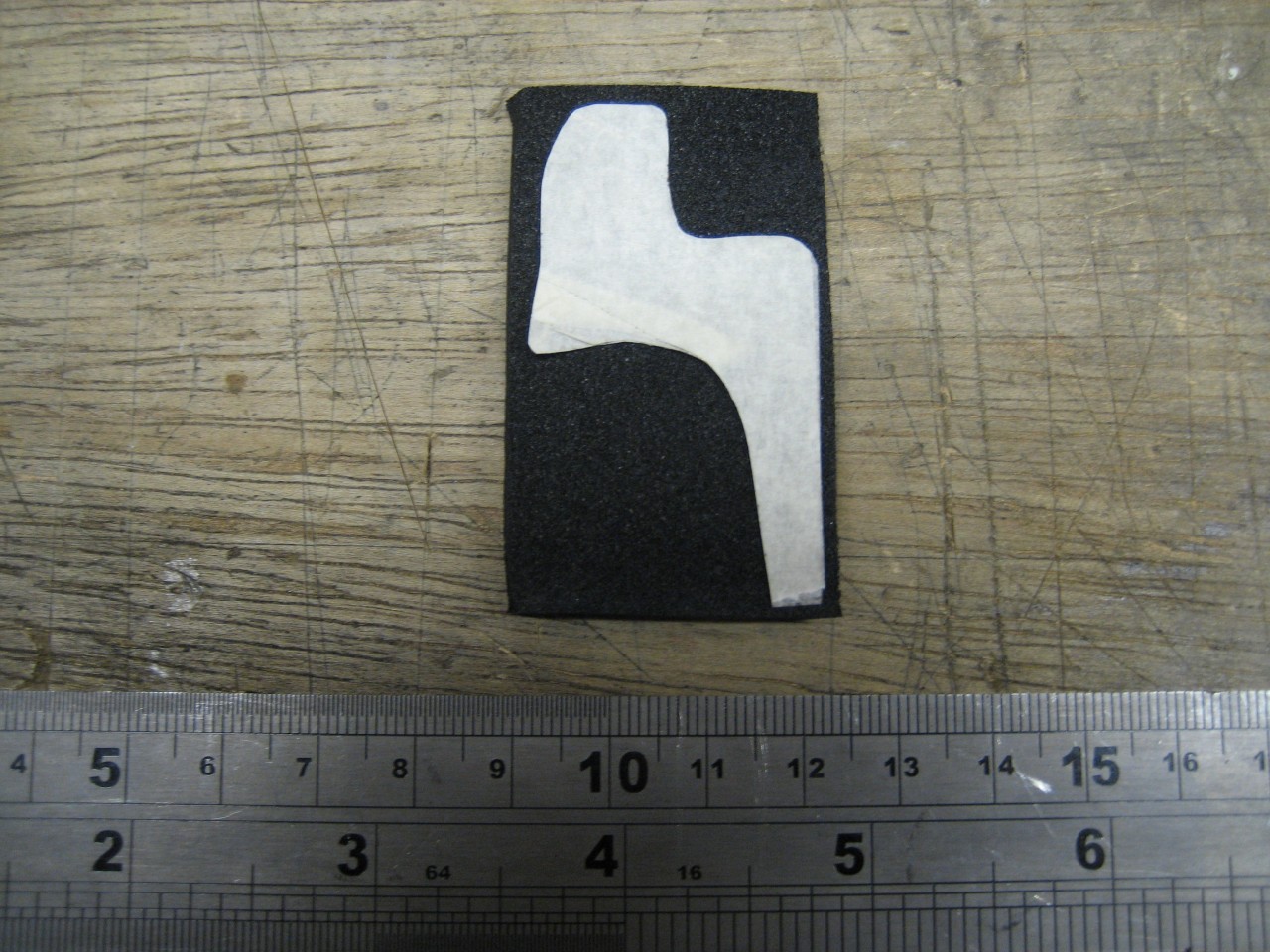

Tonight I had plans which were thwarted when it took absolutely ages to cut the two screen-frame-top-neoprene-patches to the right shape. I've used 4mm standard density neoprene, but it's a fiddly shape, and even a new Stanley knife blade wasn't good enough because the neoprene is very soft and this makes accurate cutting very hard. In the end I roughed it up with the Stanley, then trimmed with scissors and finished off with 240grit wet'n'dry!!!!!!
Actually MrsW's hairdressing scissors would be great for this, but I value my nuts too much to touch them.

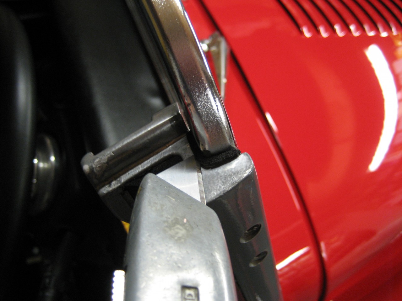

First, here's Mr Stanley taking off a small strip of surplus seal which is in the way.
This is a masking tape pattern laid on the neoprene, before I discovered it was Mission Impossible.........
But after an hour and a half..........
(I made five to get two) stars

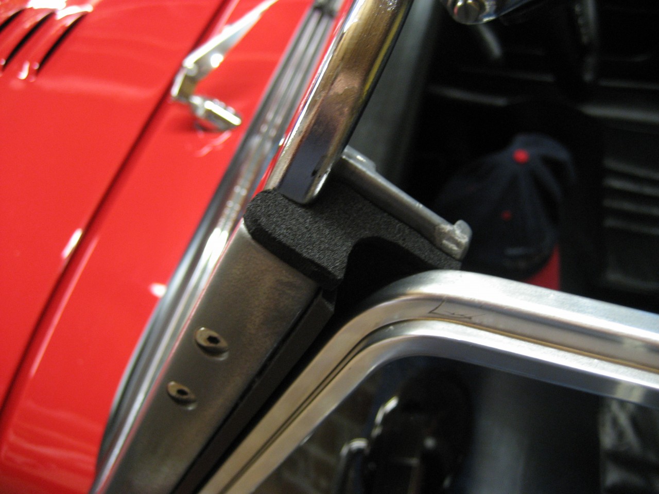

Well, due to other priorities, I've yet to do the sidescreen seals, but put the hood up on Sunday to test the fit of the top seals on the pillars. They work pretty well.
This picture shows how the header rail nips the top seal, and fits quite well with the recently added water deflector strip.
If you have the latest factory hood you can compare the original set up with this.
This picture shows the inner hood flap in place. There's still scope for water to get in at speed, but I might give this small 'gap' in the defences more thought on Saturday.

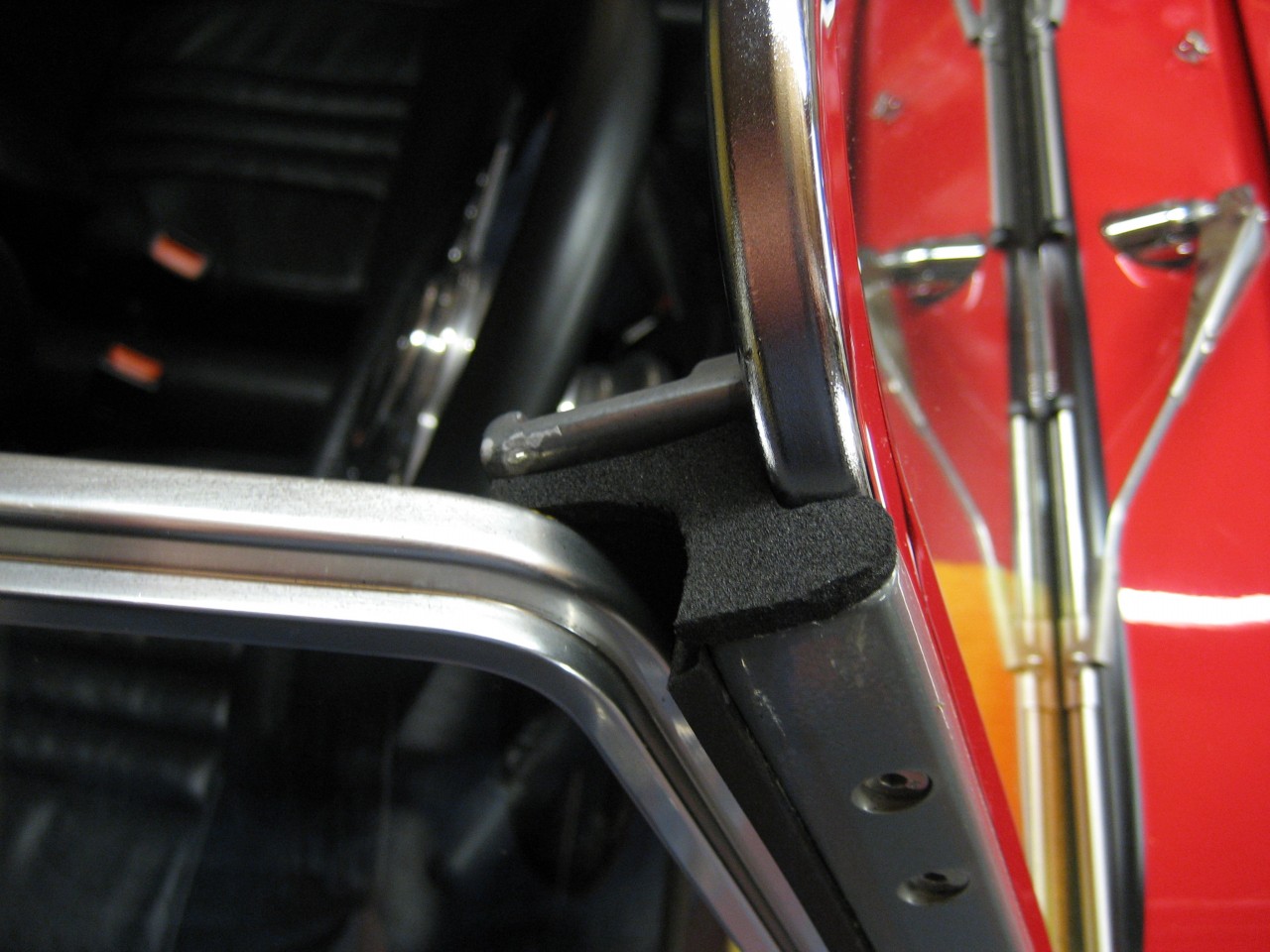

I wondered if the triangles would be the right shape
It turns out that once again, fate has provided a simple fix. Heavy duty Bostik is my glue of choice for 'mohair'.
Only the front half is glued. Compare this view to that earlier in this thread.
When the door is closed, the sidescreen frame just holds the corner. In wet weather it may be better if this was left to overlap the sidescreen - only time will tell.

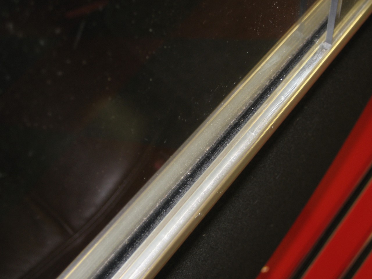

Another idea hit me over the weekend.

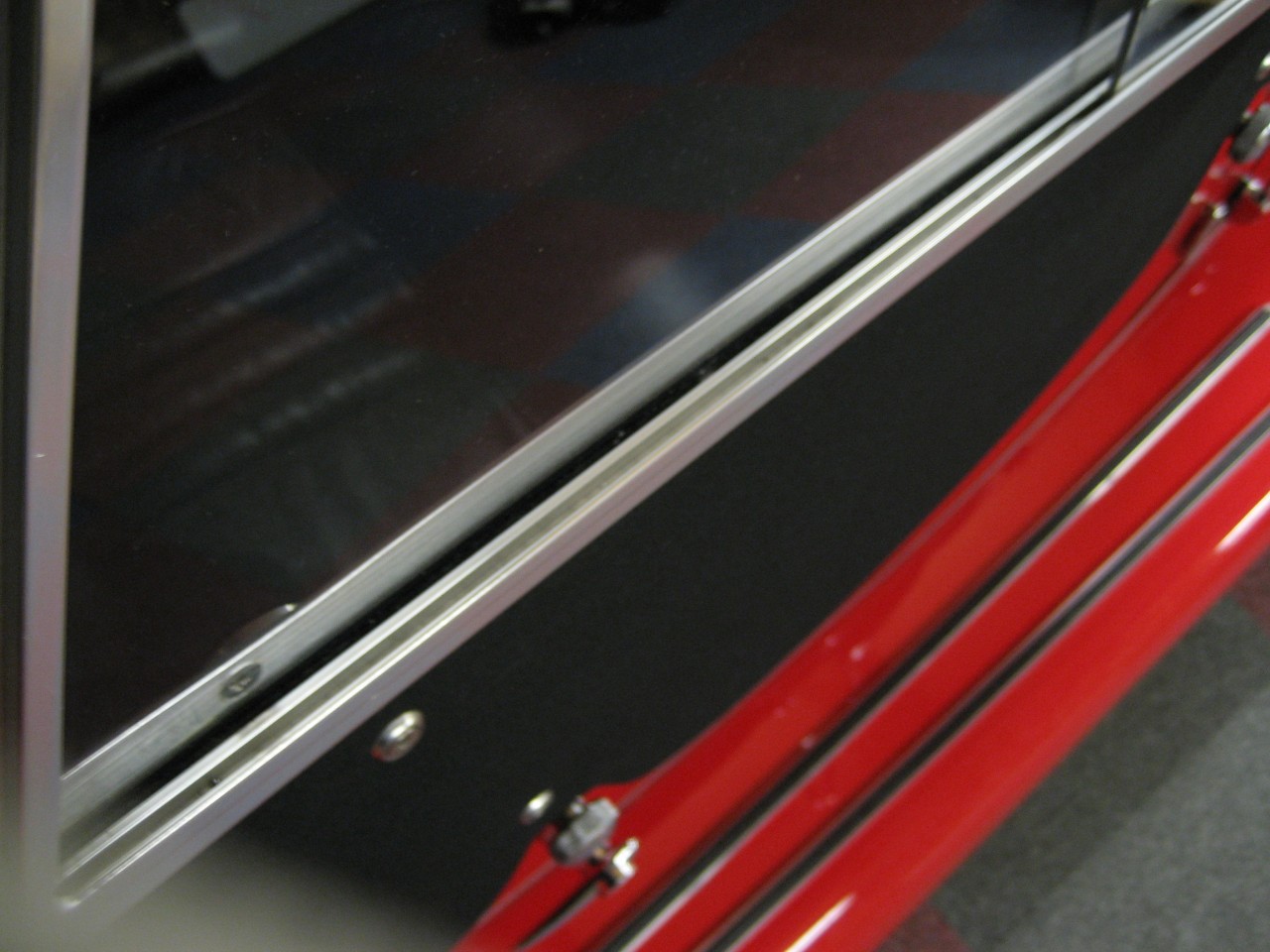

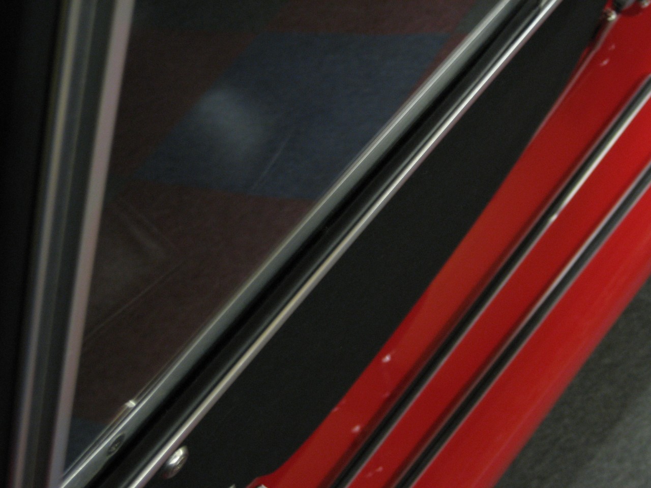

The rear sliding portion of the sidescreen has a narrow trough in front of it, into which the front plastic window is secured with clear silicon sealant.
Closer look - difficult to show clearly.......
COH Baines sell angle neoprene (L shaped with one leg thicker than the other) - reference IRS0822EP at £1.06 per metre......
The thick end slots in the trough and the thin leg fits close to the sliding window. This means that when it's wet, much less water can get in that slot. I've fixed it at each end with double sided tape. Although the tape doesn't stick well to the neoprene (due to the waxy release agent I suppose)- it helps to hold the seal in the trough. Just a small piece at each end.
Close up with flash (sorry about that dust........)
The only tricky bit is that there was some silicon residue at the fixed window end which took some shifting so the seal could fit properly. But this is a nice and easy quick cheap fix.
And one day it will get wet again.......
