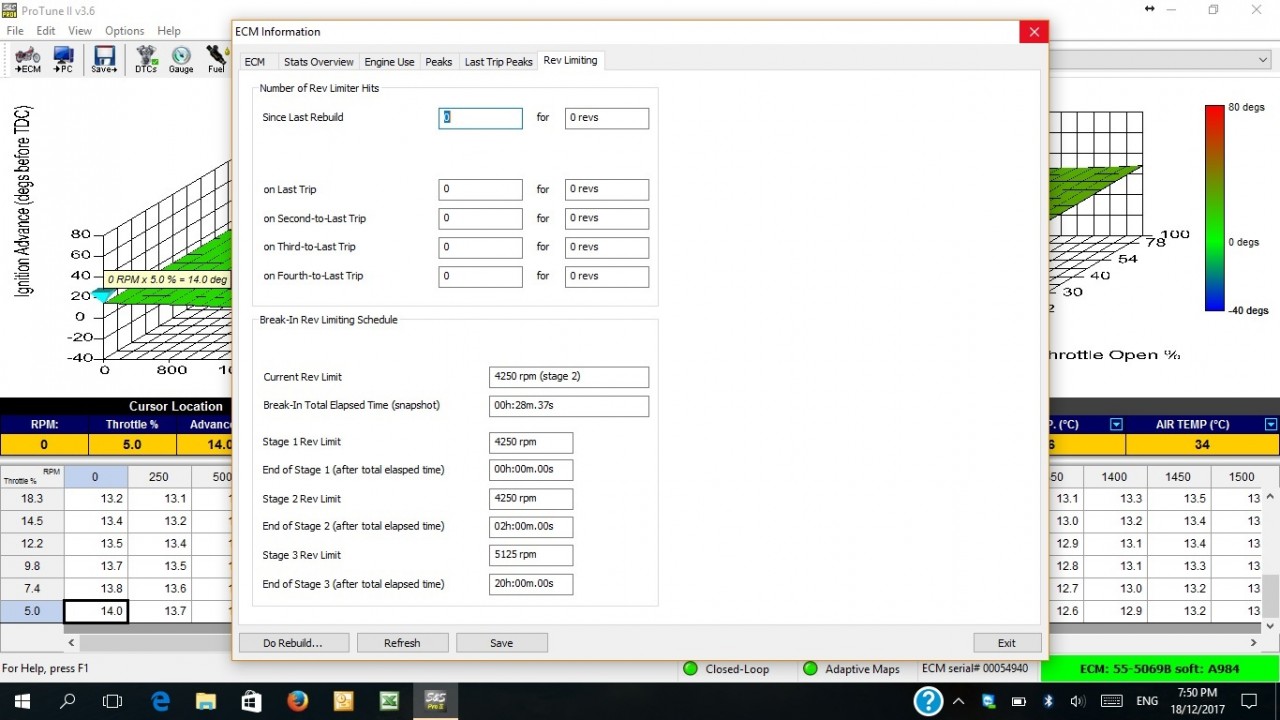

Lovely day for a quick ride to check all is back to normal, but ....engine was faltering at just over 4000 rpm. Any gear and running perfect at all loads below 4000 rpm??
First thought, had knackered battery whilst charging?
Perhaps this was cause of the lead coming off issue??
So, checked plug leads, new spark plugs. No change
Mind drifting off to blocked fuel filter etc etc.
Tonight i hooked up the laptop to the ECU to see if any codes. No codes
In fact not much history of anything.
Noticed that the run time history was only 28 minutes??
The rev limiter page shows that I am now back to square one, with rev limitation active!!
Limit is, wait for it, 4250 rpm !!!
The drastic loss of voltage seems to have reset the ECU

if the engine to injection cuts to 4200trm it may be that the ECU goes into engine run-in mode, it happened to me after trying my ECU on another TW, I think it also handed me the hour meter to zero hours of engine running, everything returned normal after hours of engine break-in time.

I think the cause of my problem is that I did not disconnect the battery on both TW's to swap and test my ECU.

I am hopeful the issue is ECU going back to "new" but nothing is ever simple with our machines so will keep looking to other possibilities
To that end I have taken battery out and had it checked at battery shop. Clean bill of health on all accounts . So cross off battery, HT leads and sparkplugs.
At this time will look to get the hours up to get to "no rev limit threshold" on ECU.

If xmas dont get in the way, should be able to do the 2 hours needed to fool the ECU.
