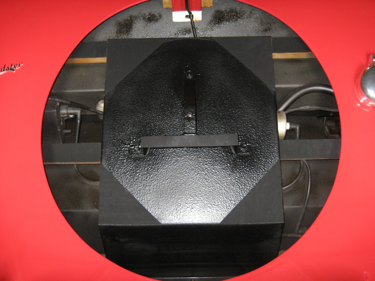

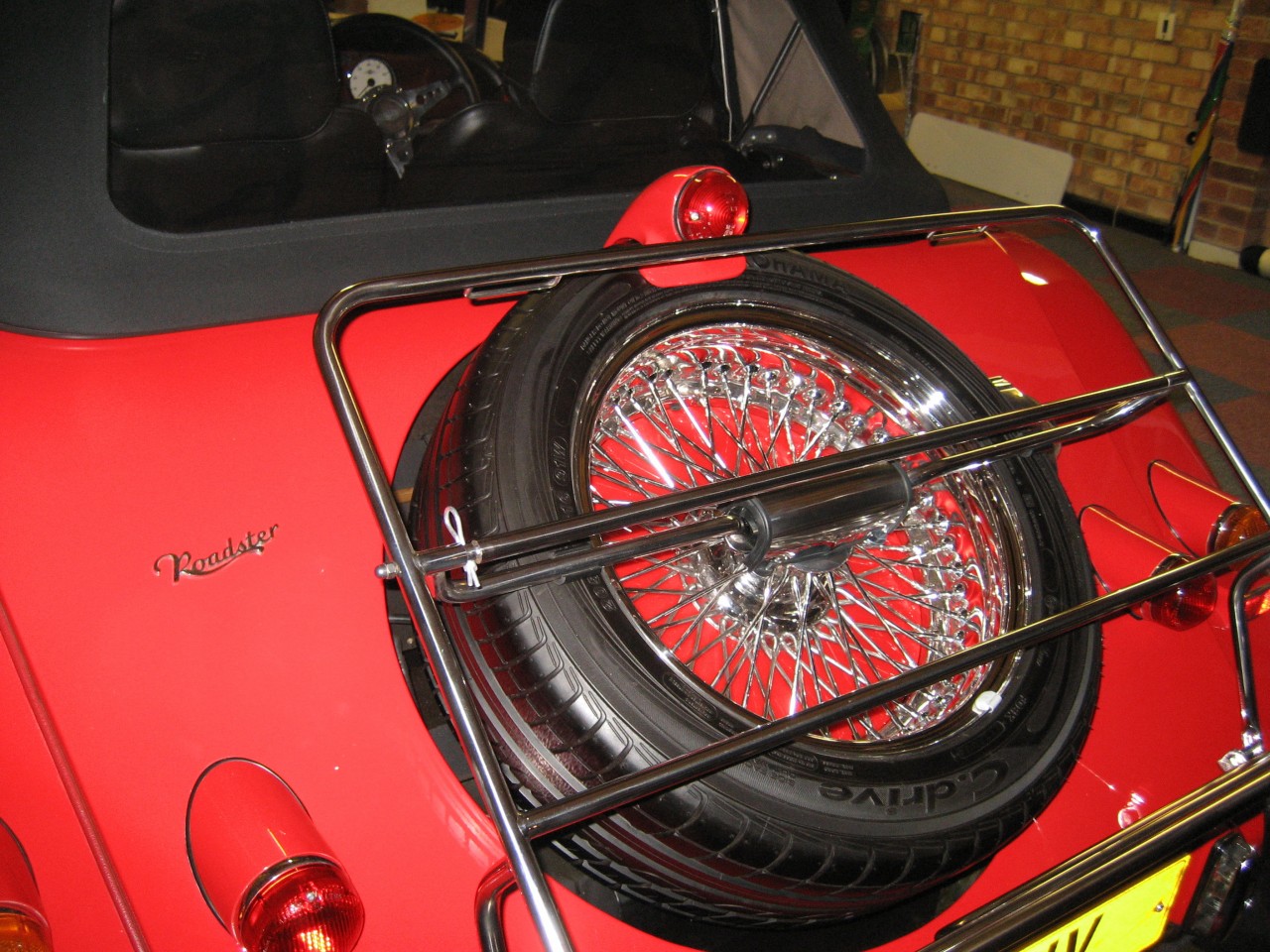

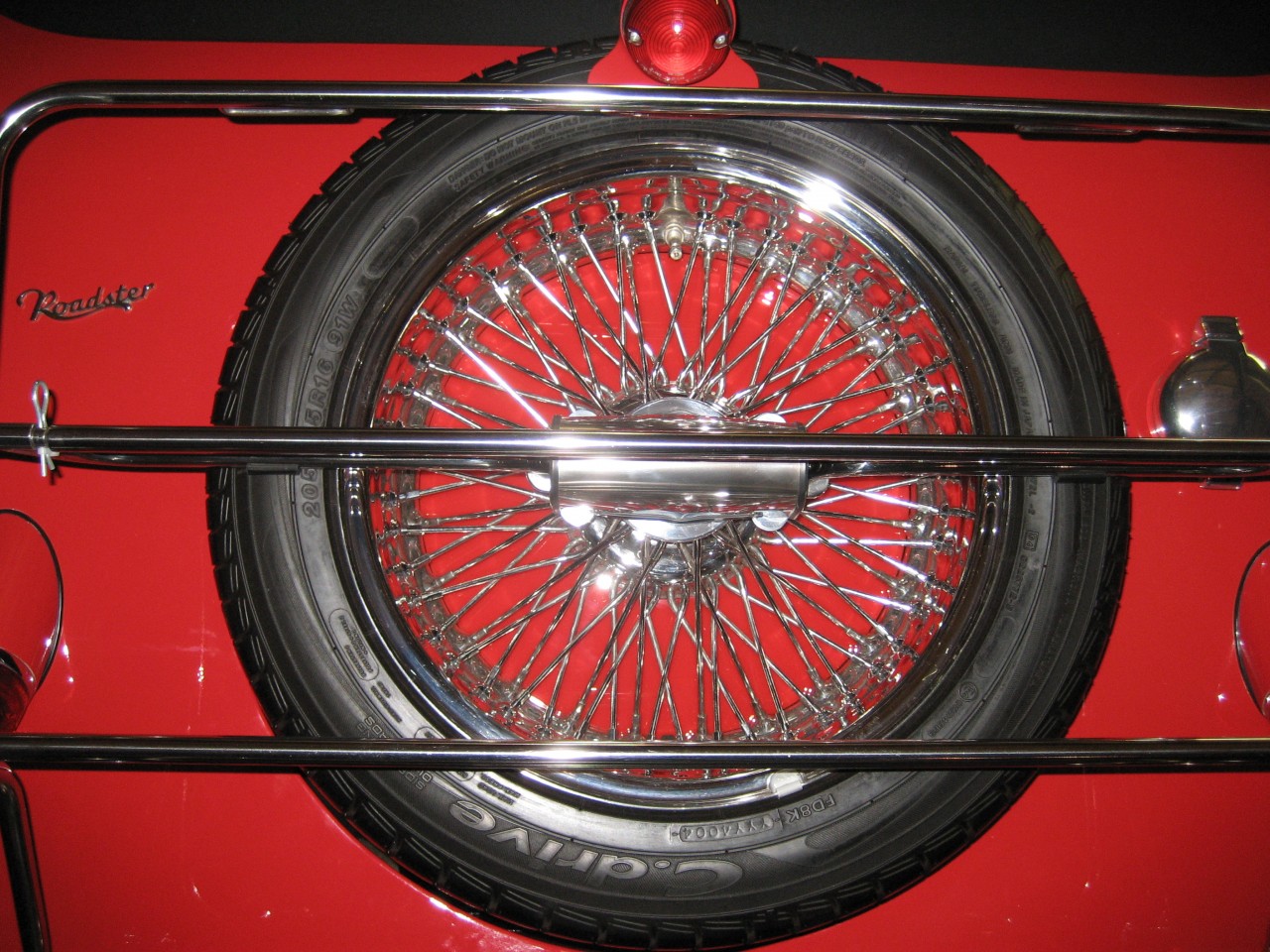

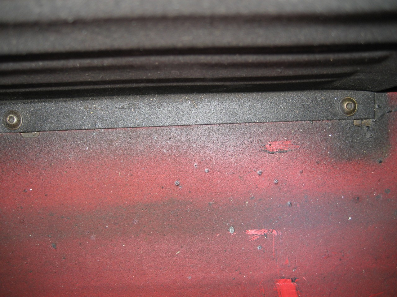

I managed to get half a day to myself, and took the luggage carrier and spare wheel off to see if I could smarten things up a bit. There's not much scope under there. The rear frame 'bonnet catches' have a wire which is supposed to run in a groove in the wood, but on mine is a bit slack. I've held it up by slotting a plastic tube behind the centre rear brakelamp bracket. All I could do was to add some thin neoprene to stop the tyre rubbing on the metal plate and cross timbers. I also blew the metal plate over with some satin black, and added a bit more wax rust proofing. I didn't take a 'before' picture, but here's the result. The neoprene shows up as four triangles, and there's a thin horizontal strip where the inner part of the wheel rests, plus a piece on each of the horizontal timbers. It's as tidy as I can make it for now.

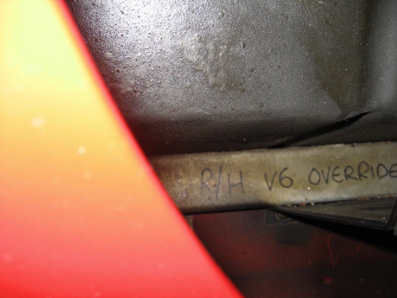

First - on the left side cross-member there is the production spec in black marker pen. So mine is R/H - (right hand drive I suppose) - V6 - with over-riders.

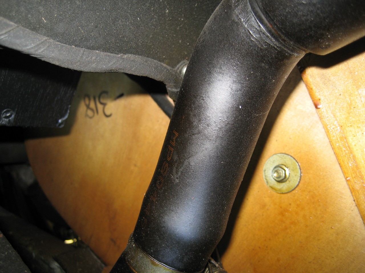

Then - tucked up behind the fuel filler tube is the chassis number - it's upside down (not the photo)........

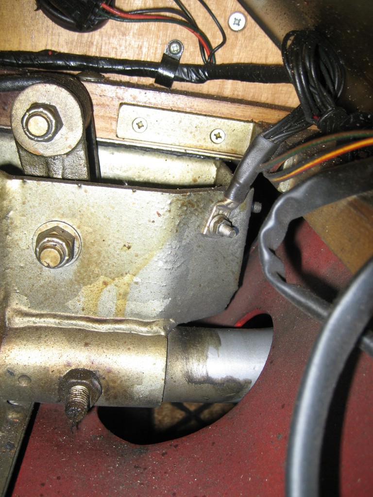

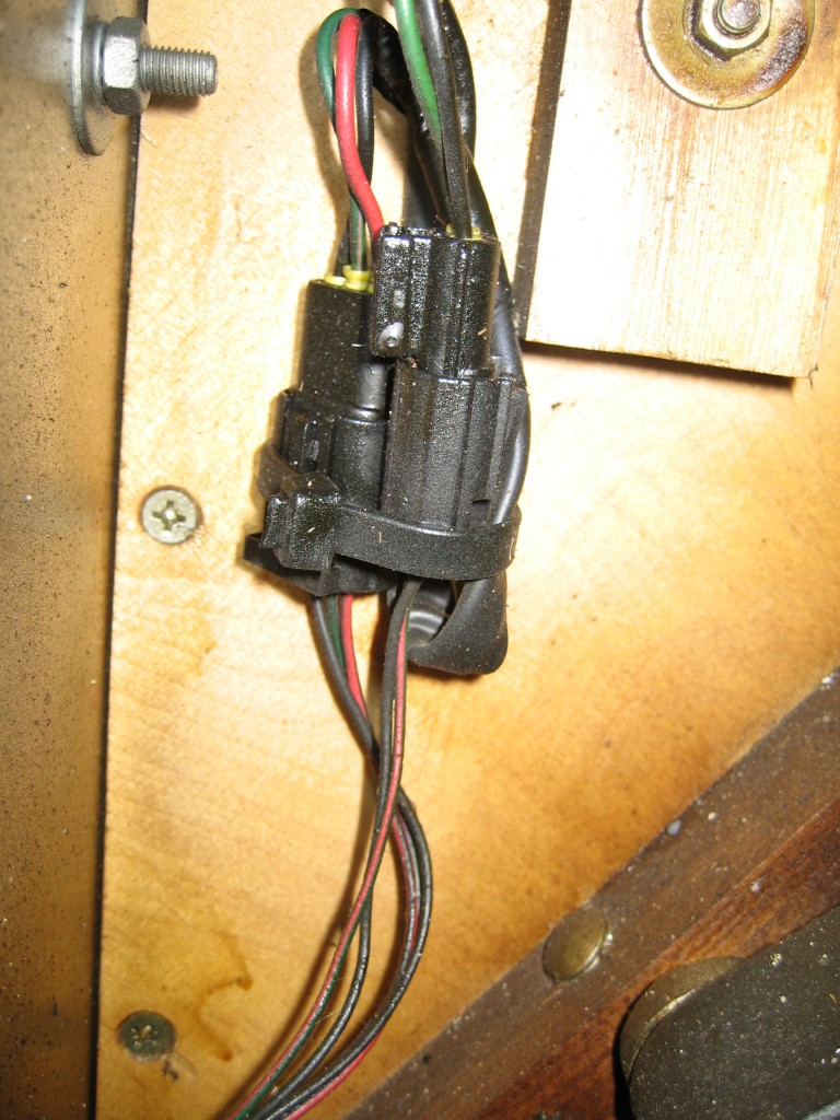

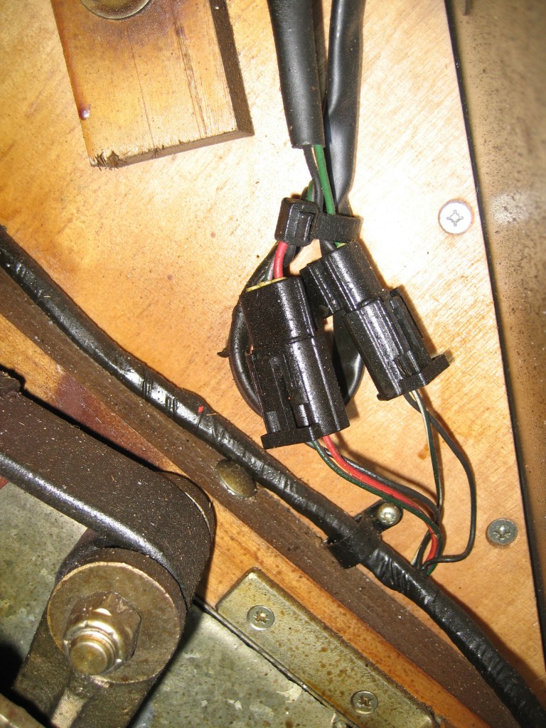

Here are the offside connectors:

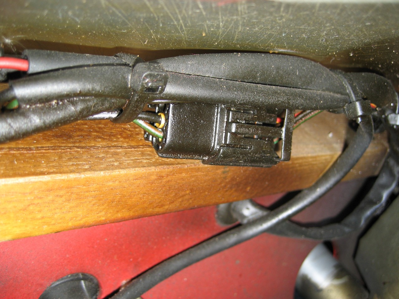

Nearside:
And tucked away under the rear valance over to the nearside........

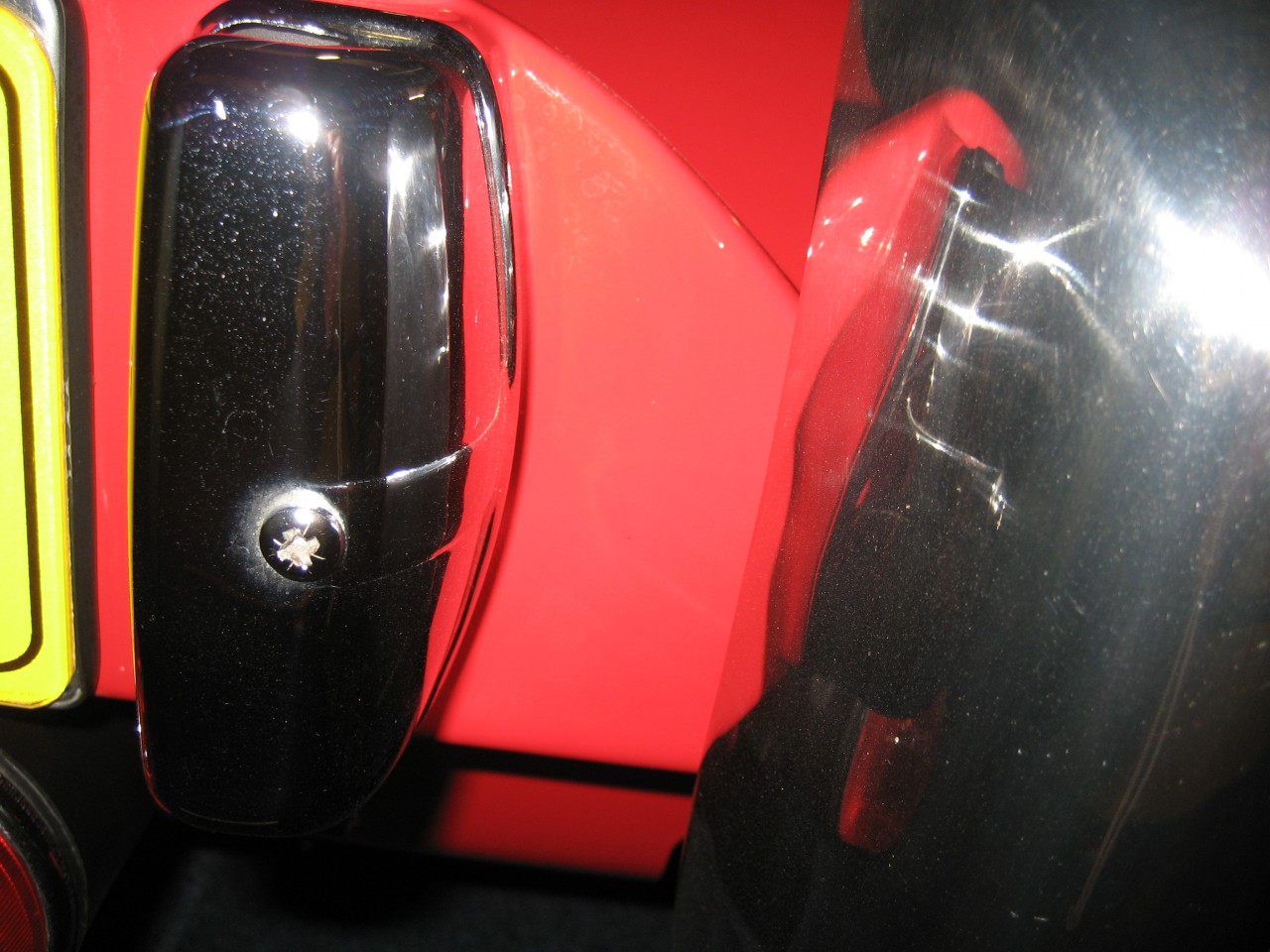

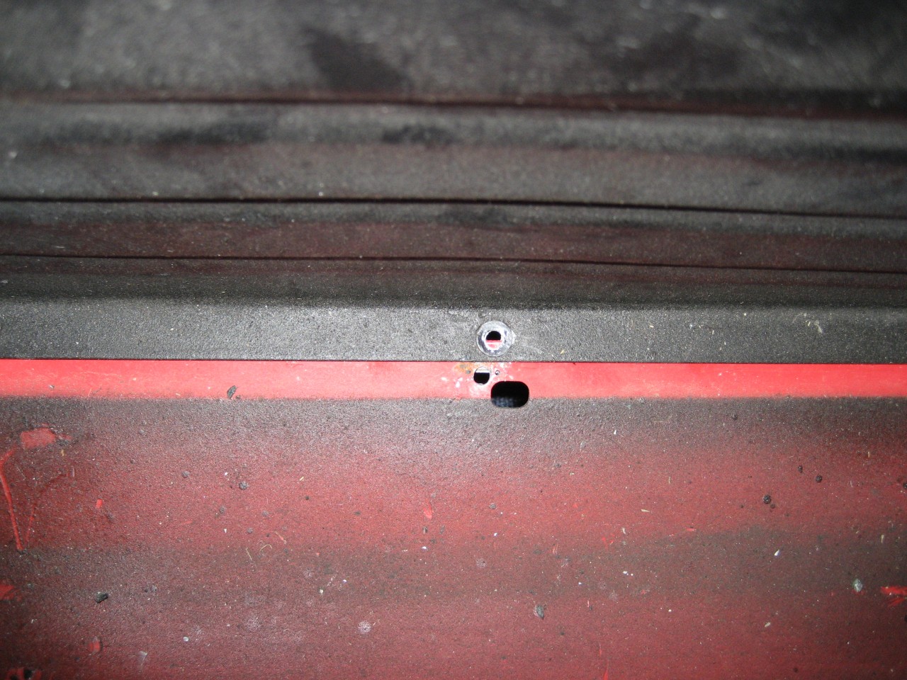

This picture is looking down on the rear valance inside the spare wheel well. You can just make out two slotted holes below, and to the right of the fasteners. There are three of these fasteners, (allen headed setscrews with locknuts below) and the next photo shows this better.

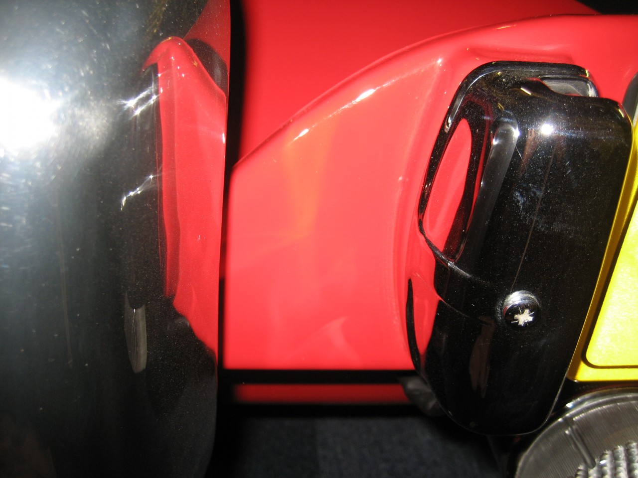

With those three fasteners removed, it's now clear what happened. The slotted holes were to allow adjustment, but the panel is very slightly too deep to line up, so I suspect that the compromise to make it fit was to offset the panel slightly to the right to avoid opening up the slotted hole into an over-large inverted T shape.
The effect is that the rear panel is offset slightly to the right, and my observations are that most early Roadsters seem to be the same.........
Here's the nearside gap......immediately below is the offside gap, and you can just tell the difference.
This has been niggling for a year. The remaining fasteners on this panel are four cross-head self-tappers with penny washers which locate vertically upwards into the wood frame.Two are outboard of the over-riders and two are inboard. Tonight I had then all off, and using my pin chuck to mark up, then Dremel drill, I slotted the seven holes and relocated the rear panel centrally. It was one hell of a fiddle, but now I can rest easy

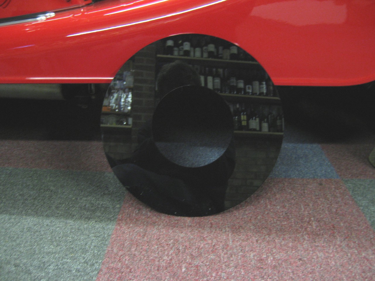

I've had this little project in mind for quite a while, but until now hadn't found a fix. But now I have, and what a success this is. happy3 happy3
The pictures tell the story.This is self coloured 5mm acrylic (perspex) sheet. I tried both red and black to see which looked best.
I'll let you decide......... first the black.....
Then the red.......
I took a lot of care to get the measurements right and had these laser cut and the edges polished. They are such a good fit that you could run with them on the road as dirt barriers were it not for the heat from the brakes (and lack of air flow!!!!!)
They hold in place with (you guessed it) two small pieces of neoprene at 180 degrees on the edge.
And here's the result. I'm so pleased with this........

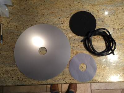

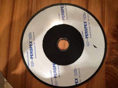

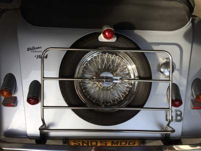

Followed on from Dave Ws solution to "tart up" my spare wheel.
Really pleased with outcome
Total Cost £28.
Spare Wheel before
Kit of Parts. Silver 5mm perspex disc, Felt disc (to go against wheel hub, Mouse mat foam disc ( to go against wheel mounting bracket anti vibration,5mm "U" section edging strip.
Upside finished
Down side finished
Spare Wheel after
Regards
Ian
