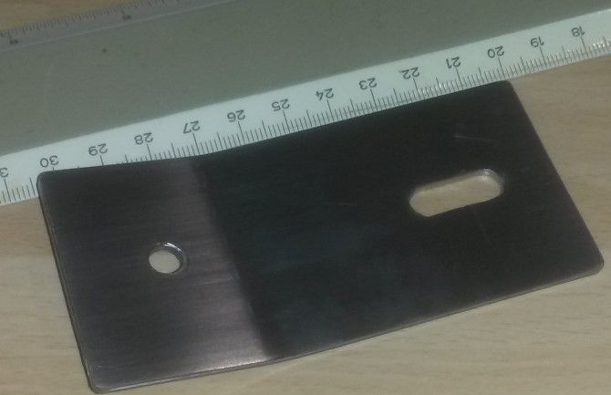

This is the profile of the stainless brackets I used to drop mine.
