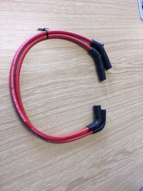

The new leads have arrived smile
Magnecor part number 2547 - Morgan 3 Wheeler 2.0 V-Twin cylinder
£32.09 plus p&p and VAT - total for me was £45.41

Thanks for info Chris. Will be ordering some. Did Magnecor supply them to you direct as cannot see they normally do mail order?
ETA: just ordered some direct by mail order. Not in catalogue at the moment so dealers won't have them.

Are these thicker wires?

Check out here. As I understand it the kits mentioned by Chris employ the KV85 8.5mm cable.
Note Magnecor make the OE cables for MMC as well.

I bought them in blue
Tomorrow I install them

Yes, these are KV85.
Mine are fitted but due to holidays & snow I've not had a chance to drive with them yet.

Just started to install mine. There are four standoff cable ties holding cables to chassis tubes. If your careful the standoff parts can be re-used with normal cable ties.
There are also plastic P clips each side supporting leads as they come out of igniter box and which appear to be pop-rivetted to chassis cross tube. Will drill out rivets tomorrow and re-rivet P clips on new leads assuming they will accomodate the 8.5mm leads.

The P clips don't fit the new leads well Richard. When I took the old leads off I found they were slightly chaffed from the cowl as it gets very close there. I would suggest you cable tie them a bit more outboard to give better clearance. Not driven with them yet either but it seems to start a bit quicker than before from cold.
