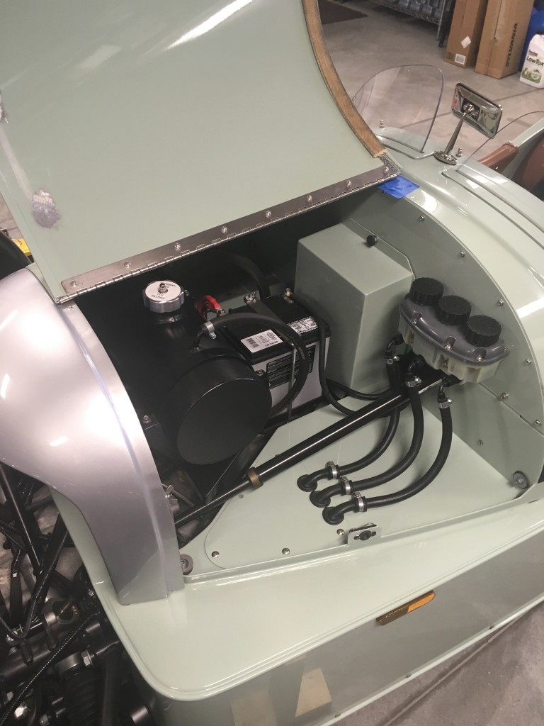

I'd like to see a curved cutout hinged door panel above the oil tank to enable quick top ups - closed with flush mount over centre panel lever fasteners.

I can also see the 'love jugs' cooling fans have been fitted too - what a great looking modification

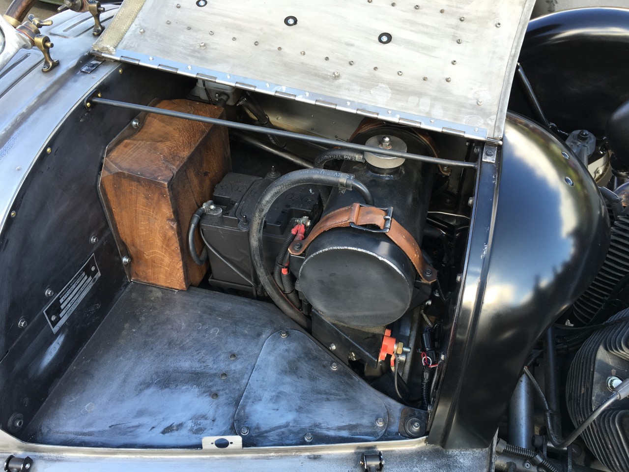

Ha Ha, yes 'froot' has a certain ring to it! BTW, I suspect that that wire mesh blister on the bonnet is to clear that impressively large toolbox!

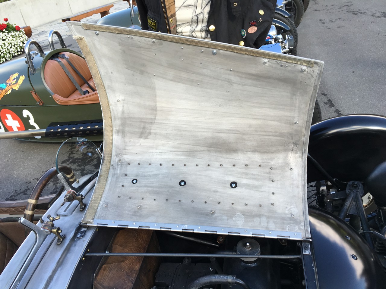

Does anyone have a photo of one of these machines with the bonnet closed?
I've done all the prep work to split my own cars' bonnet (separated bonnet from cowl, fabbed cowl mounting brackets, designed forward Dzus bracket, etc), but am concerned that there is a slight curve fore to aft along the hinge line. I'm struggling to imagine a hinge that would function when installed with said curve. I am therefore reluctant to break out the metal saw until I have a clear understanding of what works and what doesn't.

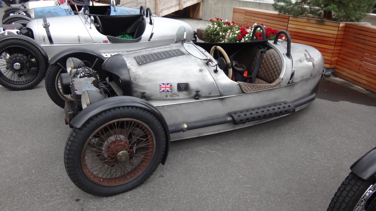

Not the same car but another by the same person I think. The hinge looks straight to me. A lot of work goes into achieving this "worn" look, very clever.

Yes, the hinge looks straight, but when you lay a straightedge along the bonnet touching the center of the bonnet, there is about .2" (5mm) gap at each end, at least on my car.
Perhaps I just need a "sloppy" hinge.

I don't have any pics with the cowl closed but here are 2 more with it open:
For a definitive answer it's maybe a bit cheeky but you could try giving Hans Weiss at Avus a call as they did it!

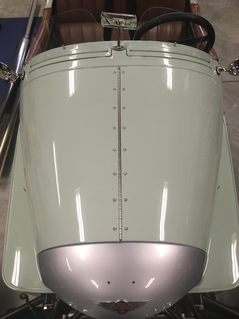

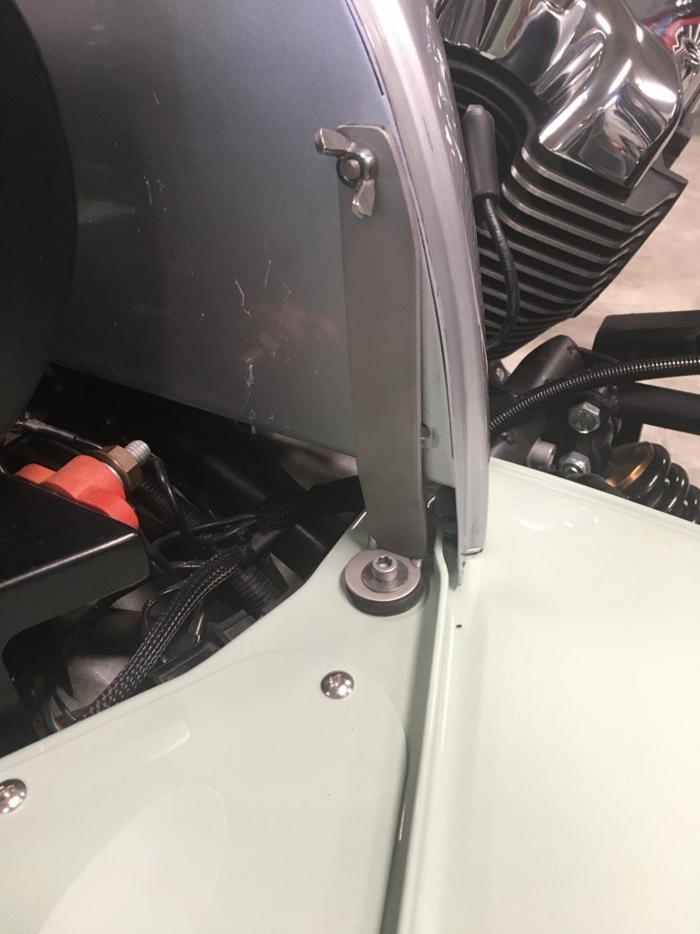

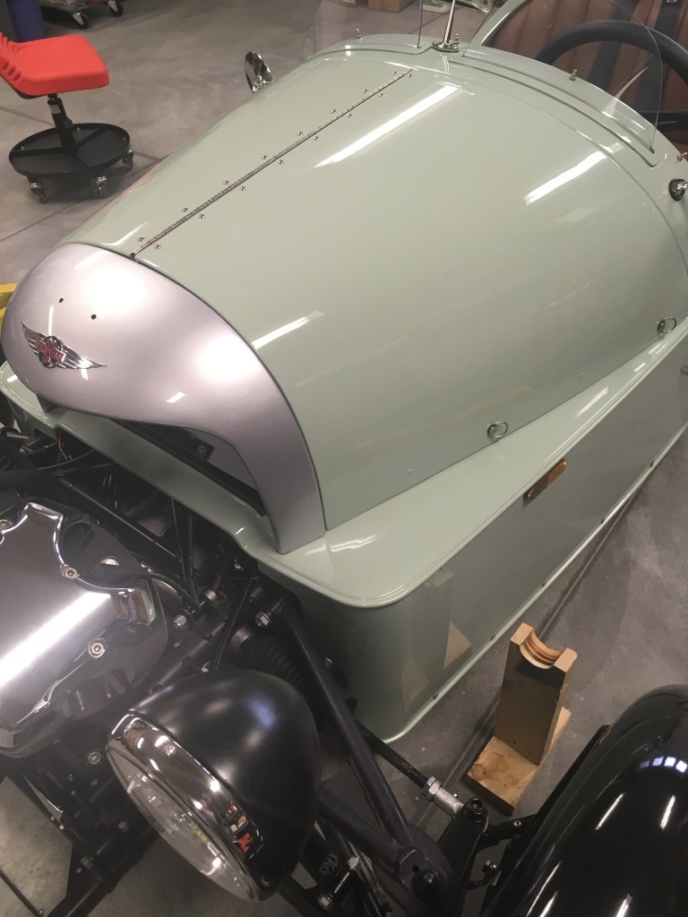

So over the holidays I got out the measuring devices, then the grinding devices, followed by the cutting devices, and ended up here.
One split bonnet with stainless hinge. Pictures are of the trial assembly. Works a treat, and am very happy with the outcome. At moment the 'bull nose' is out being painted body color (note the M3W emblem lowered 2"). Was careful enough with the cutting (jigsaw, painters tape) that the original paint will be retained on the outer bonnet panels. Interior of bonnet panels will likely end up a contrasting low gloss color. Will post photos when final assembly is done.
