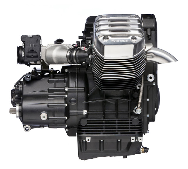

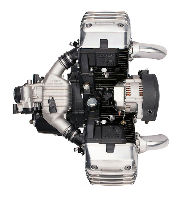

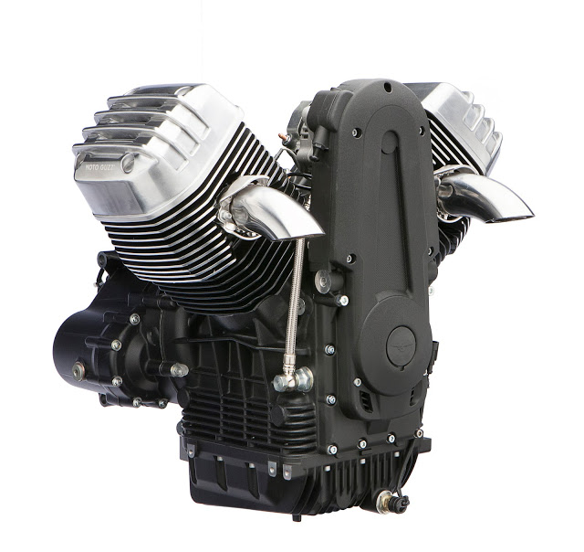

I always thought that the lightweight "Super Sport M3W" with the 1400 Guzzi and a sequential gearbox would be ideal.
Posts: 1,562
Posts: 1,562
I bet those stub exhausts have a nice bark !
