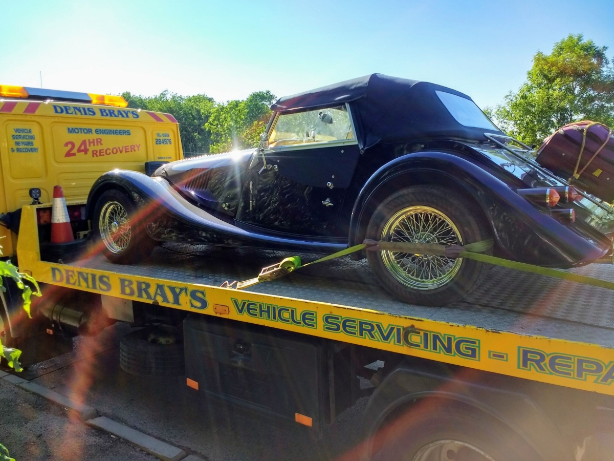

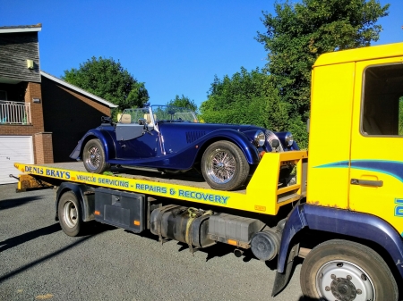

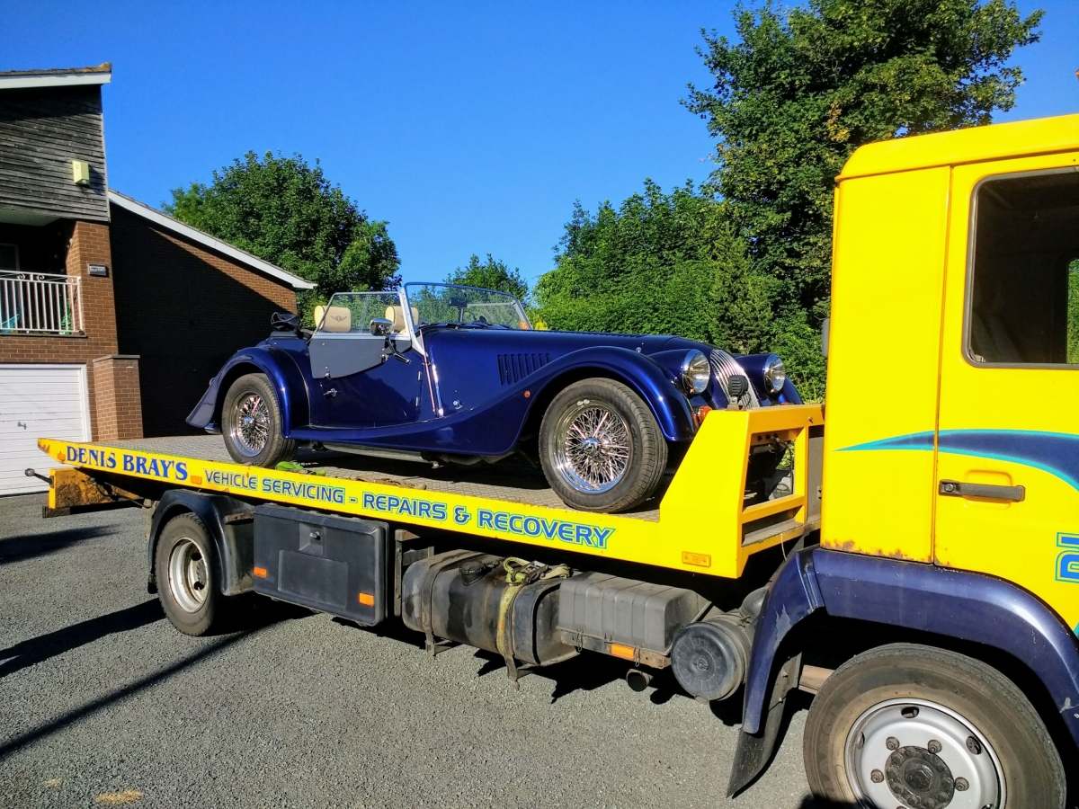

A sad end to a great five day break in Thirsk. On leaving the M62 I touched the brakes and the peddle hit the floor. You don't half push it hard the second time, swmbo nearly went through the windscreen. The offside rear brake slave cylinder pistons had seized, massively overheated the drum and brakes and probably boiled the brake fluid causing bubbles in the fluid. The brakes were smoking when I pulled up. Pistons cleaned and lubed with a tiny bit of copperslip today. This same rear brake overheated a couple of years ago, obviously a poor repair on my part. I must say "Rescue my Car.Com" were really great. Highly recommended and cheap too.
