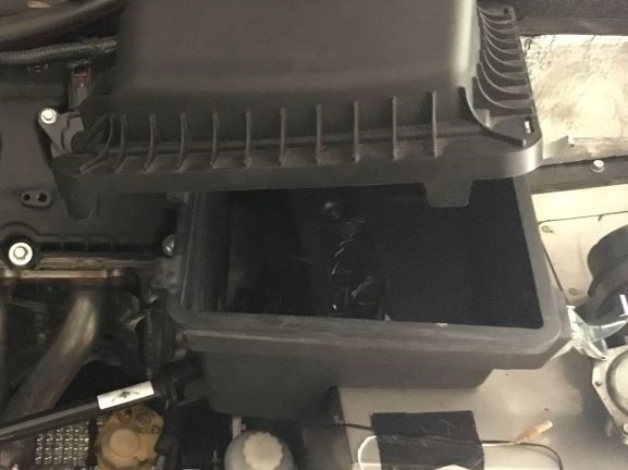

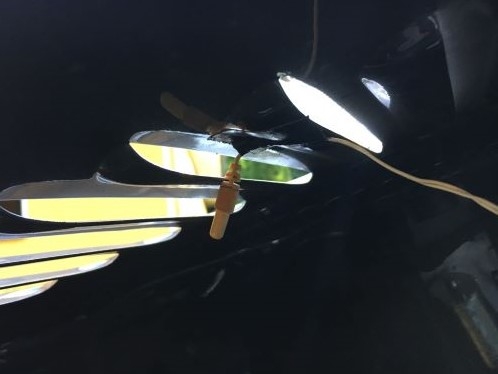

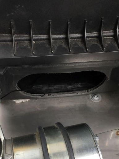

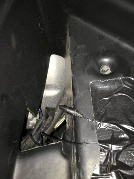

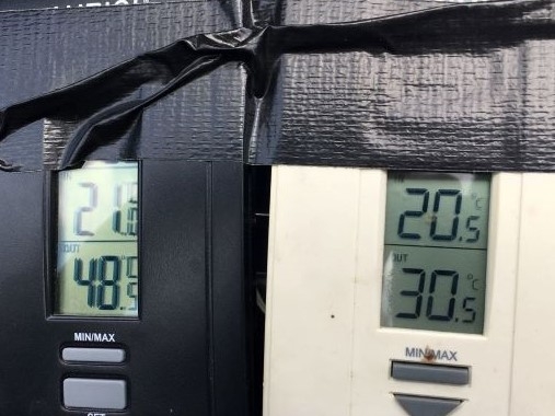

The air filter of the roadster seems to collect relatively hot air, with an opening right above the gear box and in short distance to the manifold. Indeed the temperature is 30°C above ambient level with spirited driving in 3rd gear. The temperature in the area on the right side of the air filter is lower, especially after removing the part of the sealing underneath the last 4-5 louvres.
So I opened the box on the right side and closed the old opening. The incoming is now only 15°C above ambient temperature.

This is the reason, why I measured the temperature there as well. It is more or less as high as in the area below the filter. The air is exiting the louvres. This can be seen in the very helpful work of this Morganeer from Texas. There is low pressure. But the air goes into the last 4-5 louvres before the window. There is high pressure!
