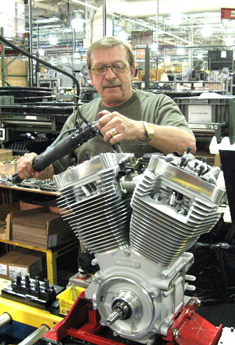

the output shaft is left hand/ rear of the engine when fitted to a motorcycle, turn the engine through ninety degrees and the drive comes through the right side footwell so control pedals have to be on the left
Gents are you sure about this, as the engine is a V the output shaft should be centrally located. See below. This will then connect the the gearbox. If the shaft is offset then the gearbox will also be offset which does not appear to case in the pictures on the MMC site.
Am I missing something? confused
you make no mention of a clutch - though I'm quite open to other explanations -
I'm rather more interested in how they are going to mate the Mazda MX5 box to that 'orrible, vibrating pile 'o c**p which is the H-D power plant.
As I've siad on this site before- more technical info would be nice. Until then, I'm reserving my judgment

I couldn't see prop shaft on that video. As I see it the H-D m/cycle has a chain primary drive[drive from engine to clutch] so engine spins 'forward' [on m/cycles with gear primary engine spins 'backwards'] - so on Mog trike engine will spin anti/clockwise if viewed from drivers seat, therefore prop must connect to wheel on right hand side to propel car forwards, or I am missing something obvious?
