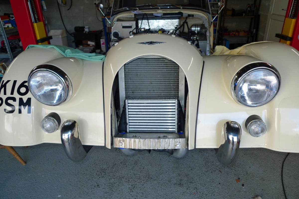

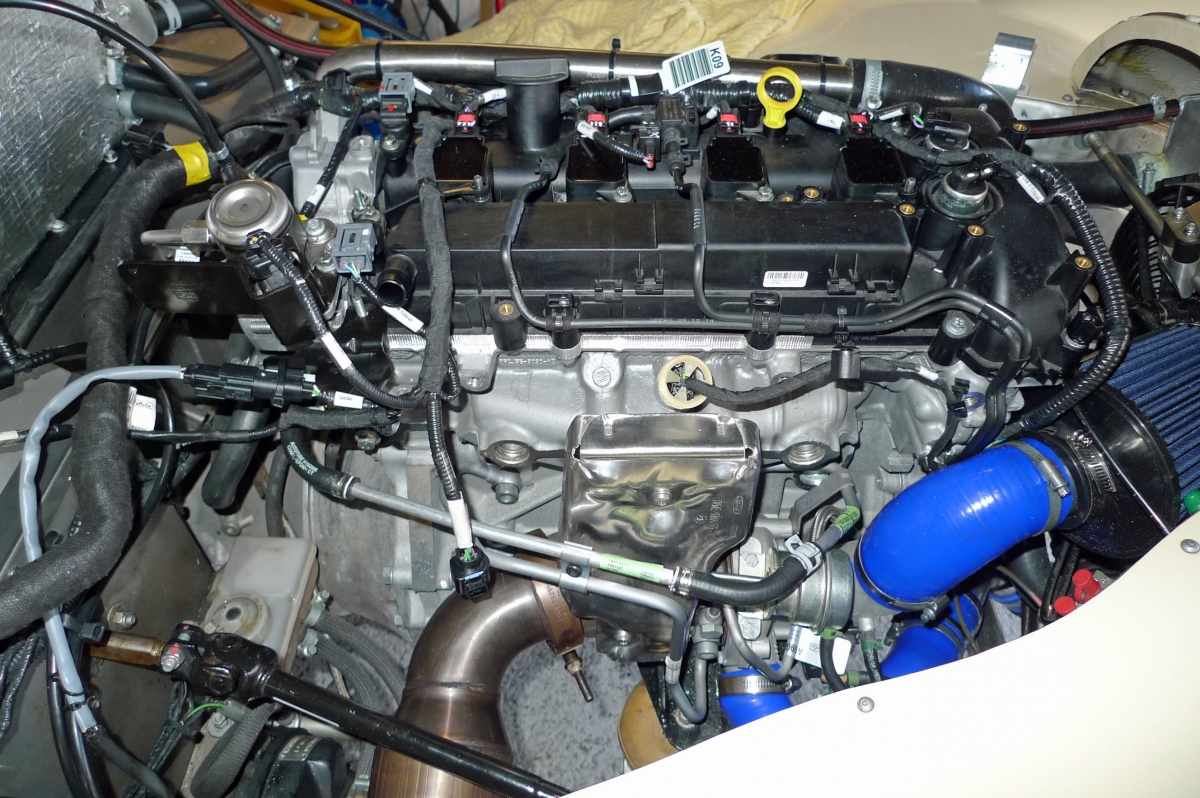

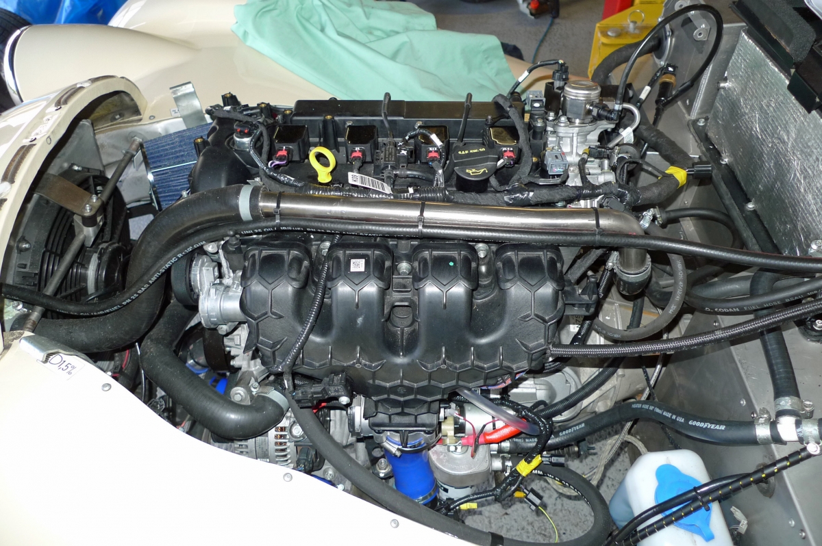

Two litre Ecoboost (250-280 bhp) engine now fitted and plumbed into the Plus 4.
It goes off to have the new ECU fitted and programmed in January.

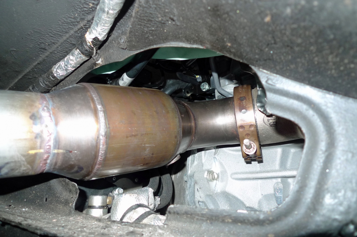

No major problems but tig welding skills for exhaust fabrication useful.

Perfectly street legal here. Engine change must be notified to insurers and emissions low enough for the MOT. It will have two tandem EU4 compliant 200 cell cats so should be ok.
