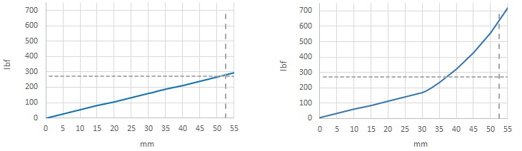

Well here’s my attempt to quantify the “boof” effect. I've been playing with numbers and apologise to all the suspension experts out there smile
I very crudely measured the rate of my springs using various weights and a laser off the garage roof. Yes there is loads of scope for error but came to a leaf spring rate of around 135lbf/inch.
The first graph below is the original spring’s performance. My car would typically bottom after 50 to 55mm of movement from rest.
The second graph is the combined performance with the new bigger capacity stops set 30mm above the spring. The crashing has gone and the body movement looks reduced.
Roger

Interesting graphs Rog. Tempted to compare with factory 5 link rear with coil spring dampers. The published rate of each coil is 225lbf/inch, allowing only 27mm of compression between unloaded and static load (spare wheel + half tank). Although on a Roadster, I imagine the rear loads are not so different on a 4/4, so you can see why we complain of harsh ride swear
