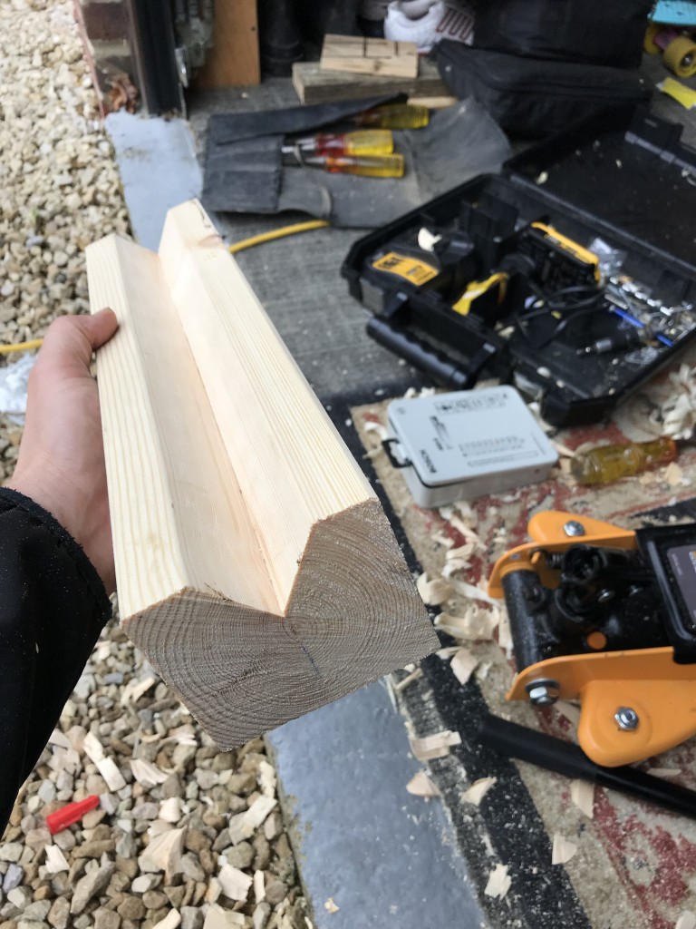

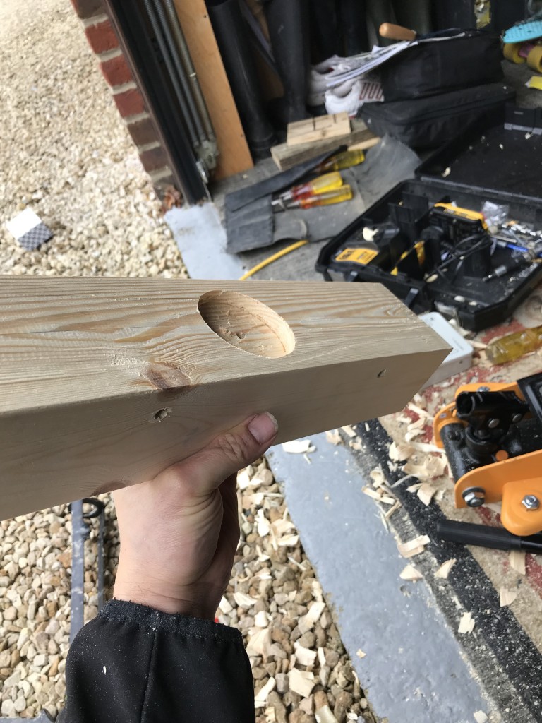

The trolley jack does move slightly when the car is being raised on the carpet, the arm swings as you say, and the block remains central (Block routered into the jacks lifting point)
The handbrake is off so the car also moves slightly as it’s being raised. Once it’s fully raised then the chocks go behind the rear wheels inc axel stands in place.

Some of these wood adaptors are impressive bits of kit. Personally, I have always used a large standard jack on my various Morgans over the years. No problem. It does have a built in rubber pad and operates well, with no slippage.

Craig, nice bit of woodcraft !
