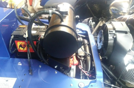

so you got me thinking how I would do it to fan cool the oil tank (she always says she hopes my OCD stays intact before my ADHD kicks in...

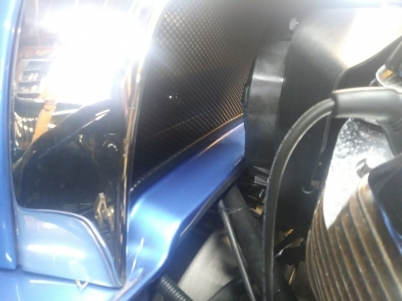

with the bonnet off you can see there is ample room to where the shield behind the faux grill begins for a mini fan. especially if it were attached to the shield, however that would require a quick disconnect every time you remove the bonnet. or make a bracket and attach to the tank mounting system. I see around the transmission plenty of place for the air to escape
there is space between the engine cooler and the faux grill the question would be whether the large engine fan would overwhelm a fan behind the grill
All in all the other down side is you would always be drawing air that has been warmed by the engine

I'm not convinced with size of fan you are talking about that air would be forced down around the transmission, especially when the vehicle is moving. Air movement under the vehicle will act like a blanket as in the 4 wheel Morgans. As you say the air that will be drawn in is nicely heated by the engine which seems counterproductive.

the more I toy with the idea the more I think you are right. I would stick with how I put the cooler on in the first place
always the fun part is thinking through what might work and what might not....
meant to say MY WIFE says she hopes my OCD.....
