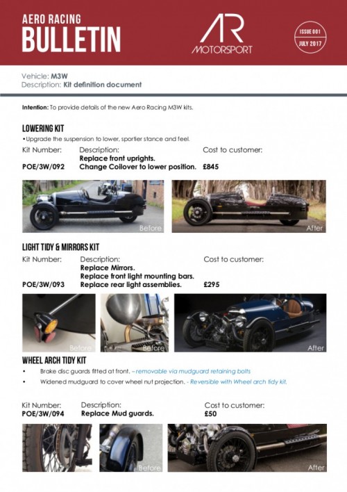

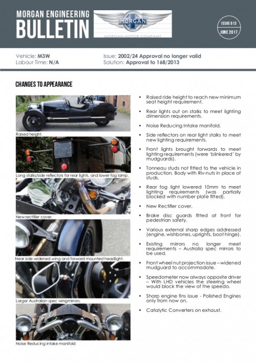

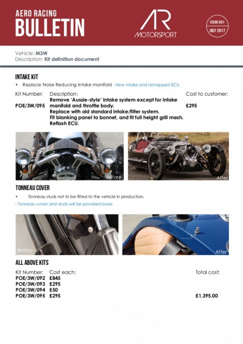

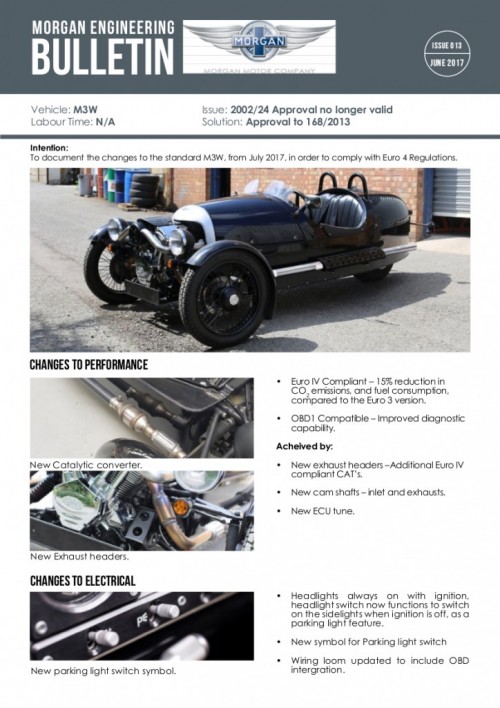

Take a look at these Osten
These are the changes that have been made for EU4 compliance.
convert to EU3 - 4
Page 2
This is what can be done to change it all back.
The new rear lights, wheel arch and mirrors are a joke.
Ride height and intake i could live with.
My car has had the wheel arch mod, lowering mod and light mod undertaken.
However, i will be changing the mirrors to a more period style.
The intake i will sort myself.
Depending on funds, i will change the exhaust and intake and one or two other items when time permits.
At the moment, the look is far more important than the performance.
