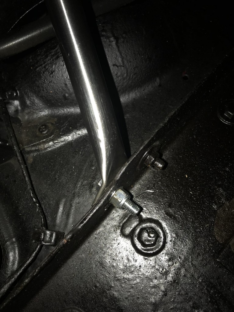

However can someone take an image of where - the BRB attaches to the chassis.
Also are the BRB at 90% to the wheel?

Before I refubished the brakes and fitted new hoses
but
you get the idea
holes were already on the chassis, no drilling required

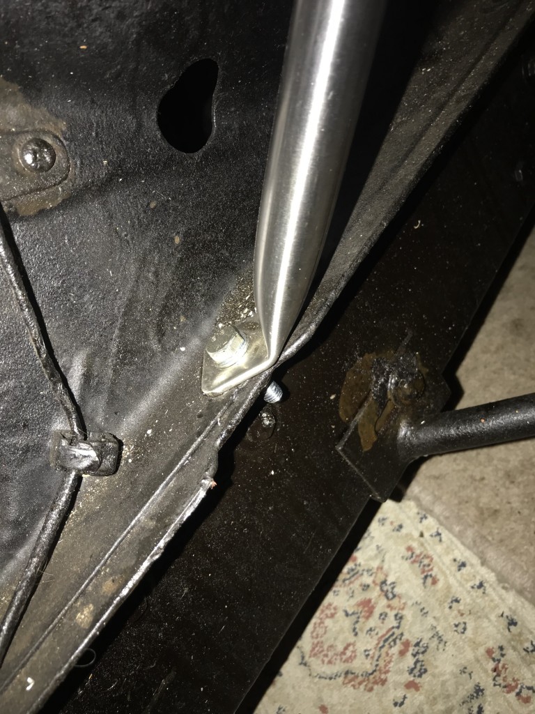

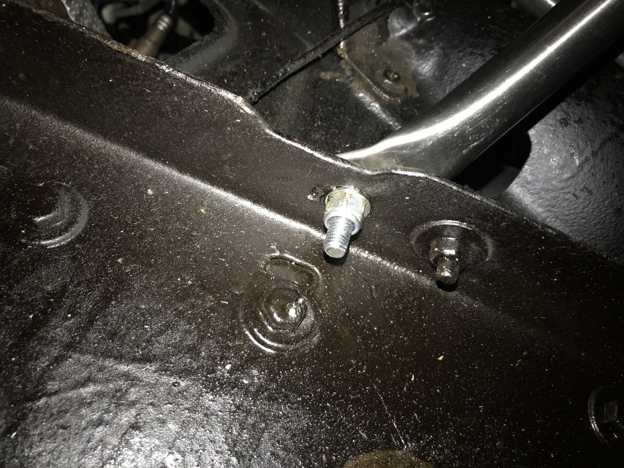

These might show it more clearly

Thanks Craig, that now makes perfect sense!!
