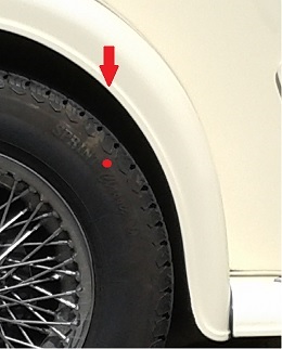

I have no idea if bigger tyres improve or detract from the handling on a 4/4 but I do like the look of the bigger balloony 185 Vreds. They may even add a little extra much needed comfort too.
But on a 4/4 the bulging side wall may just kiss the inside of the rear wings at full suspension travel. It may not even be noticed but it can leave a tale tale rub mark on the black under seal.
About here
The only way that I can run 185’s with zero contact is to reduce and limit the rear suspension movement with my bump stops woohoo
Roger
