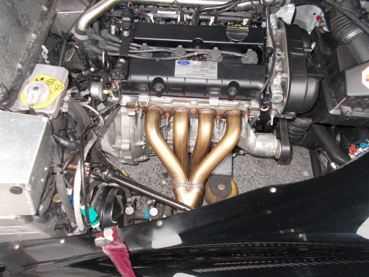

I had the Librands manifold fitted on my 4/4... the difference in performance before and after was very noticeable even without an ECU re-flash. That's coming shortly!
I believe LIbrands use 'Janspeed' to manufacture their product... it's a very nice quality exhaust with smooth welds in and out. And car had no issues getting through the MOT emissions test either with the accompanying 200 cell catalytic converter. smile

The librands (along with sports exhaust and remap) made a big difference in performance and a deep throaty sound.
Installed in my 4/4...

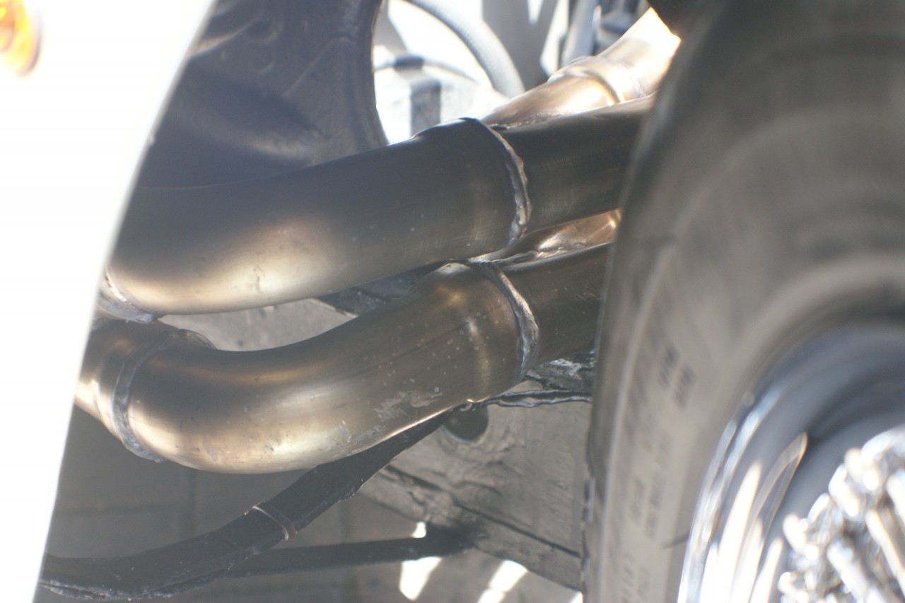

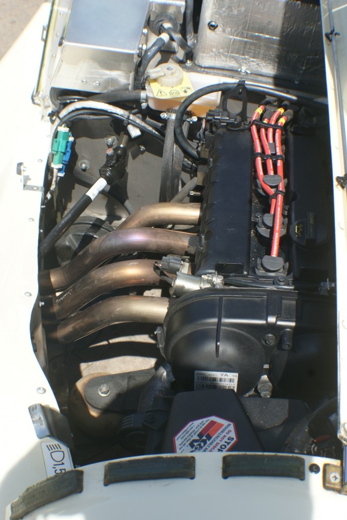

Great photos of the Librands system - I hadn't seen one before. I had imagined the Factory version would be very similar but it turns out they are not copies of each other. What the longer individual pipes achieve, if anything, I don't know.
As you can see the factory AR version extends into the under wing area. This version has both the lambda sensors in the Cat - not into the base of the manifold. The side repeater wire shown isn't touching the exhaust as the picture suggests!
