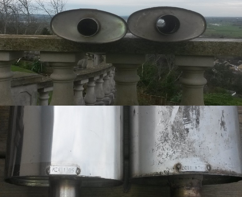

I had a slight resonance at 2600rpm both stationary and moving. Took me a while to track it down and initially thought it was coming from the engine. Everything was tight as you say but did find changing the vertical adjustment on the exhaust changed it.
Eventually tracked it down to the exhaust silencer box. Having stripped the box out to check the baffles were not loose I discovered the car was originally fitted with a MEX 1107 through exhaust (you would have not known as it wasn’t particularly noisy). I changed the box to a MEX 1105 and it instantly fixed the problem. Nice and smooth since without that annoying resonance.
Worth getting down and checking the little metal plate with the number on. See pic below.
Roger

Those nice thoughtful people managed to fit the silencer with the plate on the top surface. It is a MEX 1105. I do have a selection of Morgan exhaust boxes so I may try swapping it over if I don't find the source.
