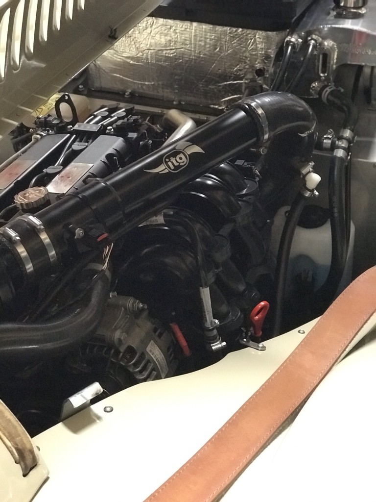

Thought it may be worth an update on the ITG filter that I fitted to the car recently. I've now done about 150 miles, and I feel that the car is pulling better in 4th and 5th gear. ITG reckon their filters may improve torque, so maybe I'm predisposed to the 'improvement'
The filter cost £57.25 including next day delivery. ITG have set up their web site so that a Morgan 4/4 2009-18 1.6L van be selected to get the correct Profilter. I found their technical team via email to select the correct filter most helpful.
Why did I choose ITG? I had a Discovery TD5 fitted with an Aluminium intercooler and re-mapped by AlliSport, and they fitted an ITG filter, which worked well.

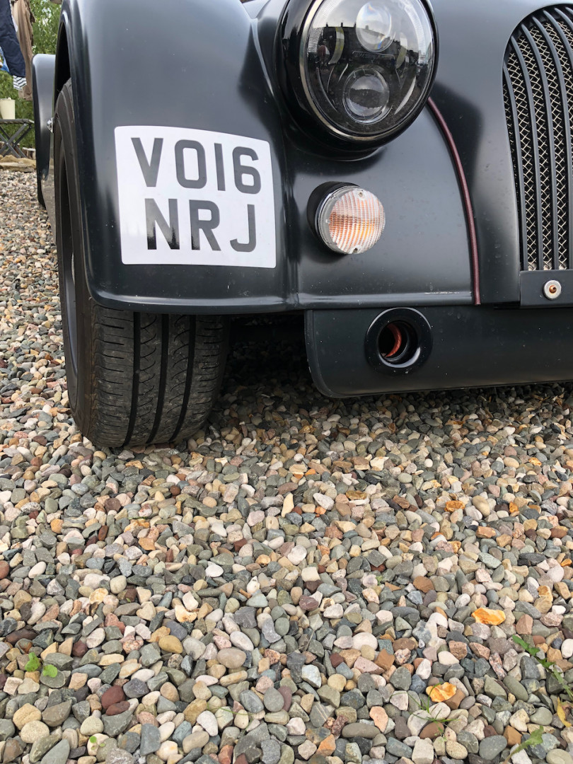

Thanks for the suggestion - I had looked at this, but as I have a 'baby doll' front valance fitted I'd discounted, as the hose would be too close to the ground. I assume the two holes in the valance are there for air flow to the brakes, otherwise utilising one of these would make a great air scoop.

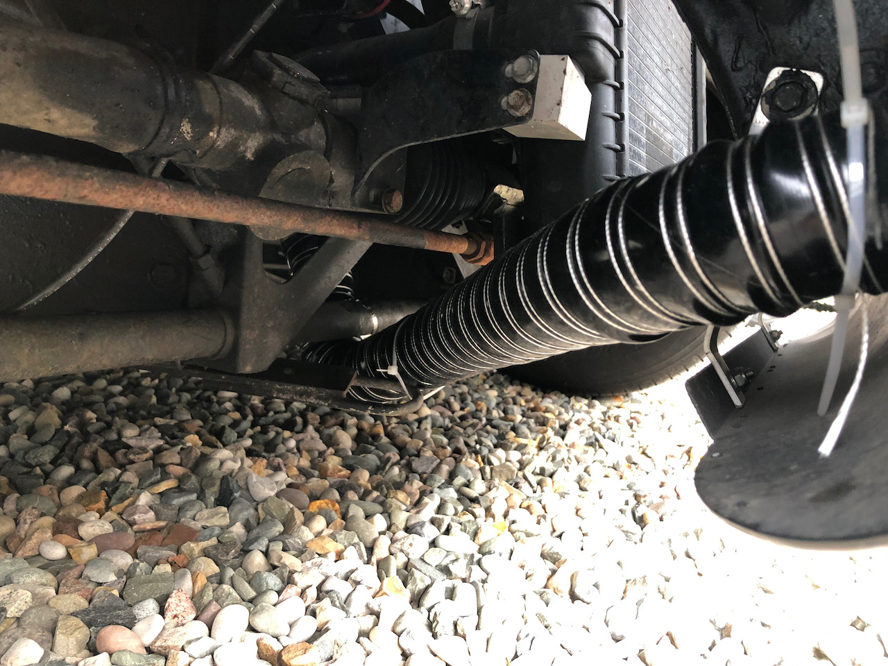

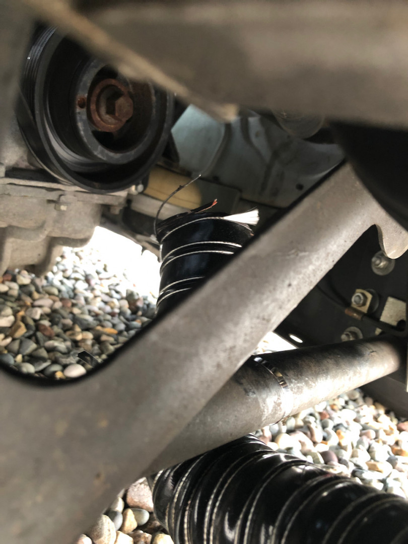

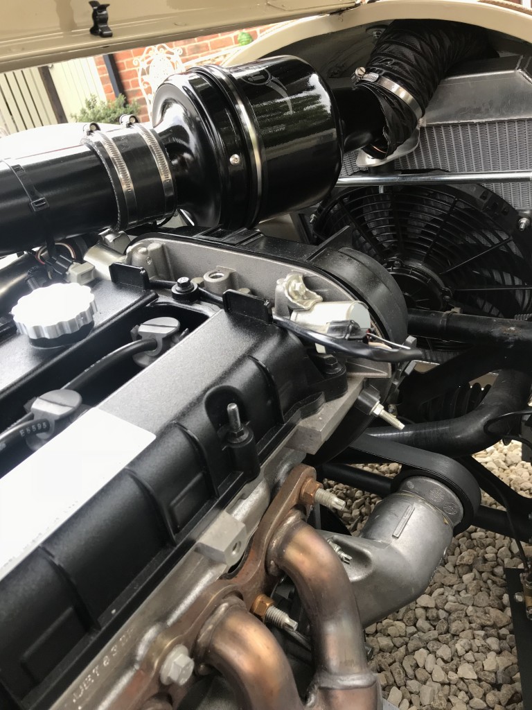

Finally got around to fitting a silicon hosed to offside baby doll air vents. I think it has given some marginal improvement. The hose is attached to the vent using a large jubilee clip. (fitted after the photo's taken)
Also tried the near side, b ut the hose I used was too stiff, and could not be bent without putting too much strain on the vent. May at some point source some more flexible hose
