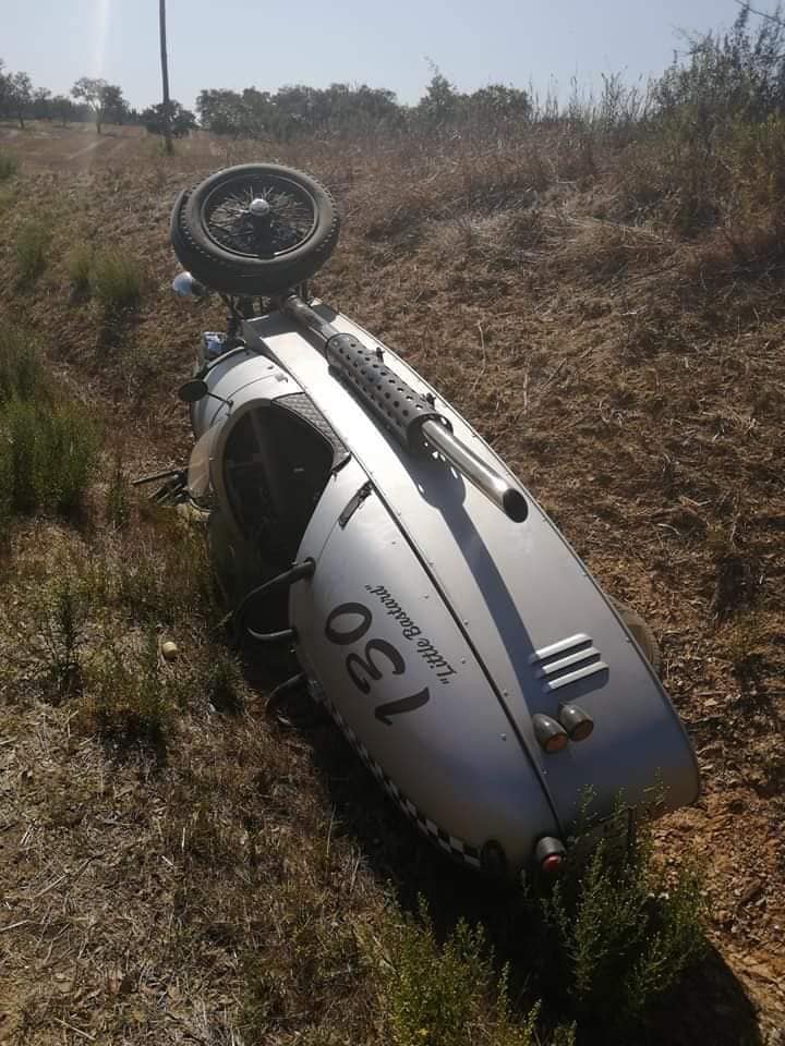

That is a sickening image, just thankful the occupants got out o.k. it's a stark reminder of the fragility of these flying machines.
All small, 2 seater flying machines are fragile and offer little protection.
You are right I think they need fitting with a couple of Martin Baker's finest 7,613 people would agree and no canopy to explode beforehand. Martin Baker

Interesting thought, but as they weigh about 60kg each it might dull the performance somewhat.
