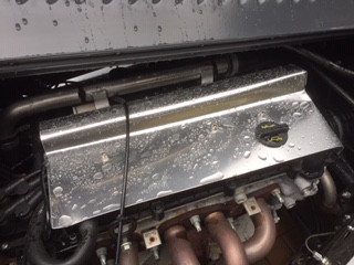

After having the spark plugs drowned in water twice, I got hold of a used Ford engine cover and installed it in my Plus 4 (Duratec engine). Time will tell if this solves the water ingress problem.

Not sure Dave, I’m contemplating driving lights and also some wing protection work. I’m enjoying your book and find it encouraging.

The engine cover after gently rinsing the car prior to washing. Definitely needed

Picking this thread up, if you go down the ford route do you know which one you need? Would one of the ST150 engine covers you see on eBay work?
