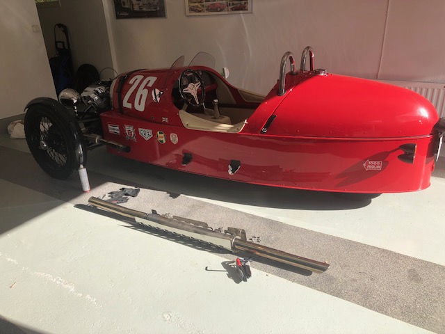

I just took my original exhausts away from the car and I think that I will scrap my idea of reworking the original ones.......

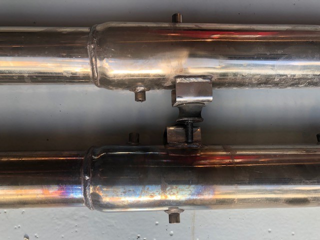

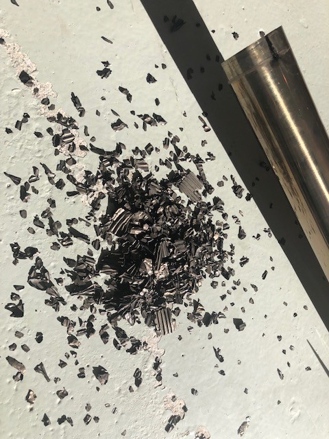

When I took the left exhaust off I could hear it rattle inside and just holding it and shaking it all of the dampening material came out in burnt little scraps (see picture), it must have been totally blocked!! The right side did not have this issue and just looking on both pipes outside you can see that the left one has been extremely warm, the bolt for the heat shield was stuck and the rubber bushing was in two pieces.....:-(
How Morgan in the first place could decide to block the air intake and exhaust in such way to reach homologation/noise levels etc is beyond my understanding......Poor, poor S&S engine....

That looks like the catalytic converter on that side has disintegrated ( can happen), nothing to do with the exhaust.
A few people on here have knocked them out on purpose to remove them from the gas flow.
Whether this helps or not is not clear.
Currently, in the UK there are no emissions checks on the M3W where a lack of cat would cause a fail - I don't know about other countries.
This may of course change in the future.
