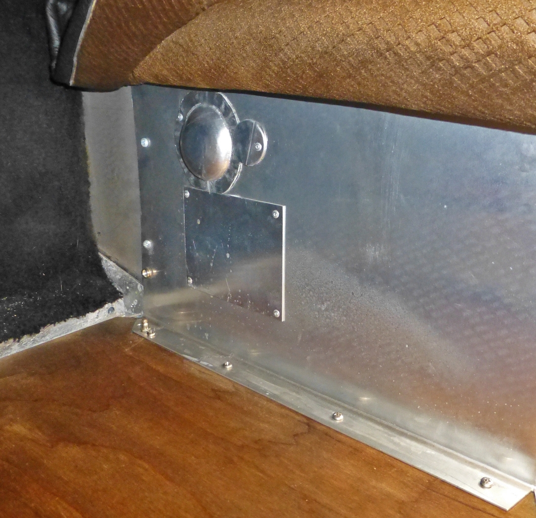

Mine's like this only a lot dirtier.

Thanks for the pics etc, after looking at it again have decided to cut an inspection hole to get at the fixing bolts and make a cover plate to screw on.
Some have done that to help with access to gearbox top-up plugs with success, DW had a guide for his Roadster
