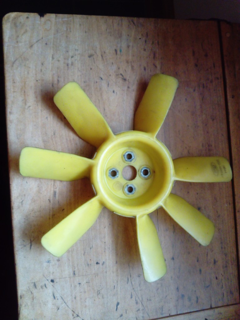

Things are progressing fine.... Have the car mostly stripped awaiting removal of body tub to free up the chassis.... As the bits come off they're checked, cleaned and sprayed ready to go back on.... Have a nice, and growing cupboard of shiny bits ready for the rebuild.
More pics soon hopefully.... Have been pulling the ancillaries off the engine ready for its new coat of heat proof paint.... Have been scratching my head about the cooling fan..... Pic below (hopefully)... Proper Ford part.... No damage or missing blades so someone has gone to great thought and effort to deliberately make it asymmetrical (in fact I can't see any position in which it is symmetrical around a diagonal) .... Anyone here know why they would go to the trouble (some worry about harmonics or not wanting to create a noise that 'beats' with some other engine frequency??).. Just idle curiosity really but do like to get to the bottom of stuff like this!! :-)
Cheers

Image #609226 21/12/19 03:33 PM
Joined: Nov 2018
Posts: 6,667
Likes: 433
TBM Offline
Joined: Nov 2018
Posts: 6,667
Likes: 433
Cheers
Yep, exactly that - supposed be quieter that a equally spaced fan. It prevents resonance.
Image #609231 21/12/19 04:07 PM
Posts: 1,245
Posts: 1,245
Probably the same reason that tyre tread blocks while appearing identical are not all the same size (hetrodyning?)
Measuring tread blocks will make a change from counting louvres! evil

Image #609243 21/12/19 05:01 PM
Posts: 5,586
Likes: 603
Image Offline OP
Posts: 5,586
Likes: 603
Cheers Guys... Guessed it was something along those lines, but sometimes there's oddball reasons outside my logic.... Shows the attention to detail when they do the development of even something like a fan.
