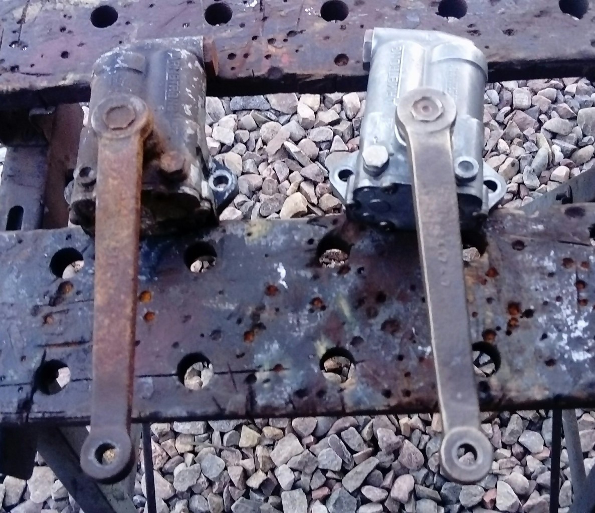

Before and after... 5 mins with a cup-brush on the angle-grinder.... Best thing since sliced bread for dealing with corrosion (unless you have a pro sandblaster tucked away somewhere.) ... Steel twist for heavy ferrous but brass is the one for alloy... Buffs to a nice gloss without being harsh. Both lever dampers are mechanically fine, but they do tend to be 'out of sight out of mind' and get very second-hand looking.

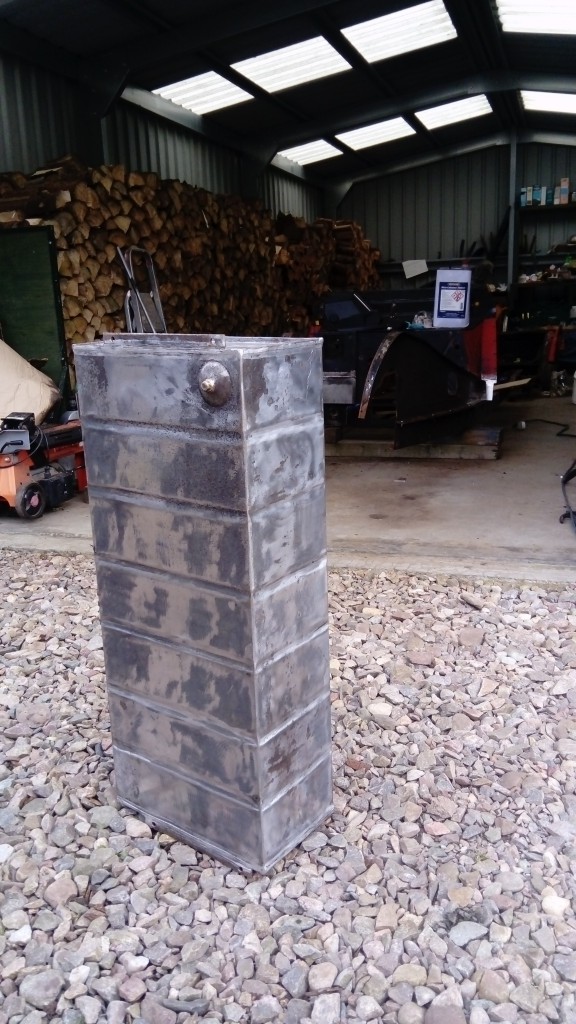

After stripping, the fuel tank proved to be in unexpectedly good condition.... No corrosion that's of any concern, just some light surface rust easily dealt with by the wire brush and neutralising solution..... Now in red oxide primer waiting a black top-coat.... Plenty of waxoyl when it goes back in (the planks of its base are also good, I have a bit of real old fashioned creosote left in a shed... The planks will be a fitting use for it) Fine to see a hand-made tank with all soldered joints... Like a giant tin can.... You could get a lot of soup in that!!
