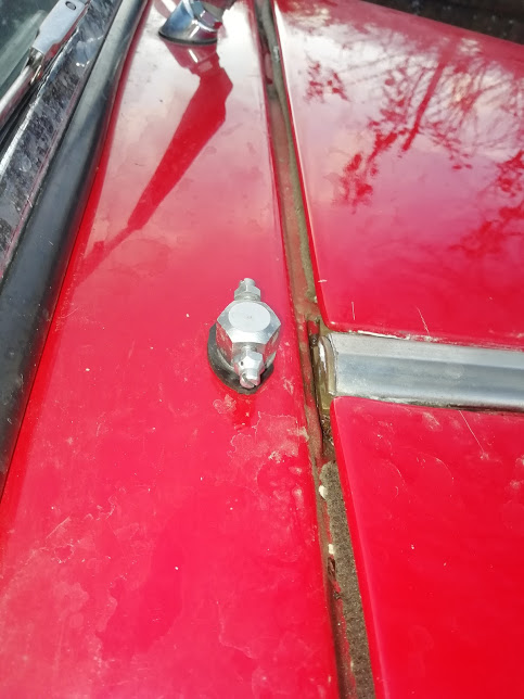

Yesterday changed the washer jet. Found the original one next to useless, I think this one is from an old Jag. Good powerful jet, in exactly the right place.

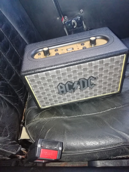

Added a sound system a while back. Used a portable Bluetooth speaker, that links to my phone, which in turns links to a remote controller which is stuck on the dash. Means I can keep the phone in my pocket, and don't have to worry about unlocking it etc.
Here's the controller - has play/pause, skip forward/back and volume
Speaker fits nicely behind the seat (and is branded with the world's greatest rock band smile ).
That's very practical this "dead pedal" TBM !!
I like the solution with the blue tooth speaker also!
