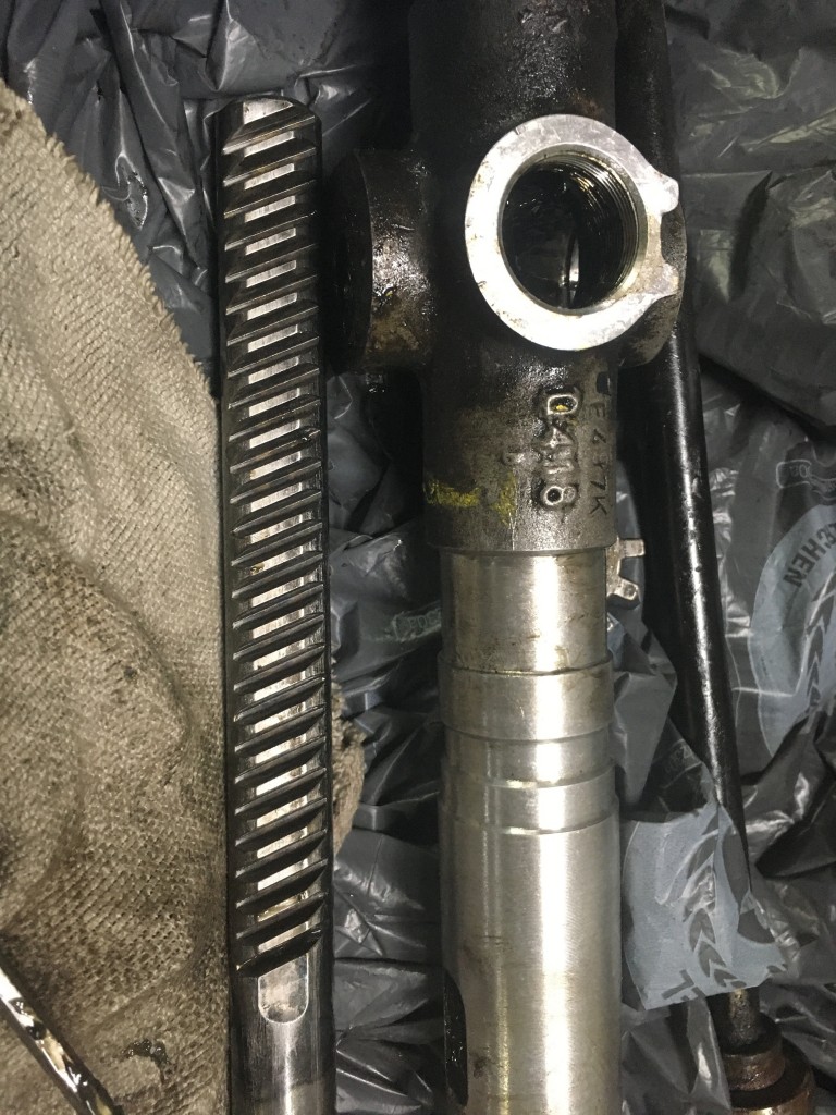

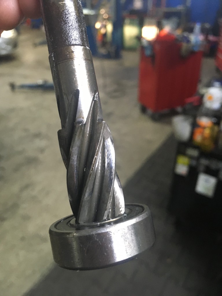

An update re this issue. First we (my son is a trained vehicle mechanic and is now studying engineering for vehicle technology and machine construction) examined the handlebars with the UJ. All are perfectly smooth-running and with good bearings. Then we turned the steering without linkage at the front wheel. It was very stiff and as before when driving we noticed this inequality of resistance.
We removed the steering because it was not ok to drive with it anyway. To see if the spindle or even the rack has damage to teeth the spindle was removed.

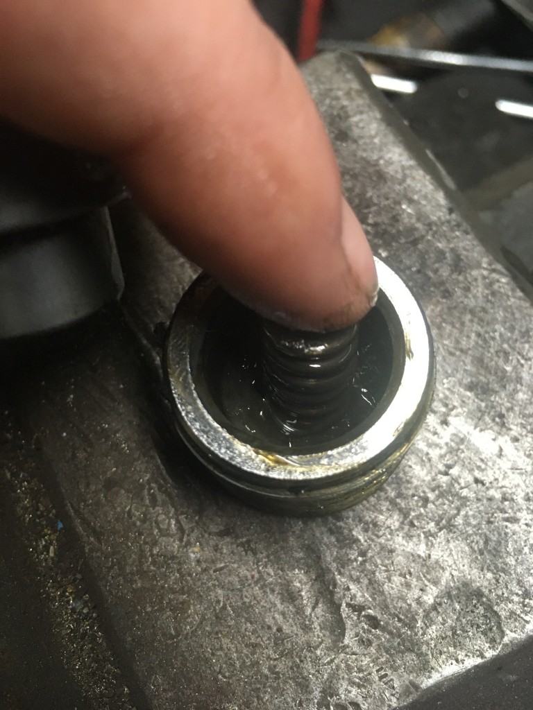

We noticed by our marking that the adjusting screw was much too tight. It was almost up to 1.5 mm outer circle of the screw at the stop.
We brought the parts to an expert and he confirmed that the spindle and the rack are still in good condition. Of course I was afraid it might be worn out, or a tooth might be broken off and ground.
But all parts are still very good. It was just too tightly adjusted. The rule of thumb with such an adjustment screw is about 1/8 turn back from the attachment point. There is also a spring under the screw so that the spindle always has pressure contact with the rack. Now the steering runs very well. It has been re-greased and is now being assembled.
I never noticed it before. Whether the rack can have curved over the years and kilometers in the 100th of a millimeter range so that the distance became somewhat narrower?

The car passed the TÜV (MOT) today. There were two different steering errors. For unexplainable reasons the Quaife steering was set much too tight as I wrote before. It is now adjusted in a way that the steering is just not heavy. This is about 1/8 turn back from full stop. Lorne Goldman even recommends 1/4 turn back on the Quaife steering. But I wanted to stay on the safe side. And still it's a lot freer than it was before. We've checked and cleaned all the parts. The spring works like it should. Also the plastic cylinder that transfers the force of the spring to the pinion works fine and is easy to move. Since the revised setting, the steering has become much lighter. It is now as it should be. I have never driven another 4/4. Therefore I have no comparison and no reference. My former Morgan had much more weight and much wider tyres. I can't compare it to that. But I think that the steering of the bigger Morgan was as smooth as the current one is now, but due to weight and wide tyres more friction was added at that time. But when driving faster, the steering of the Roadster was as smooth in the middle position as it is only now with the 4/4.
