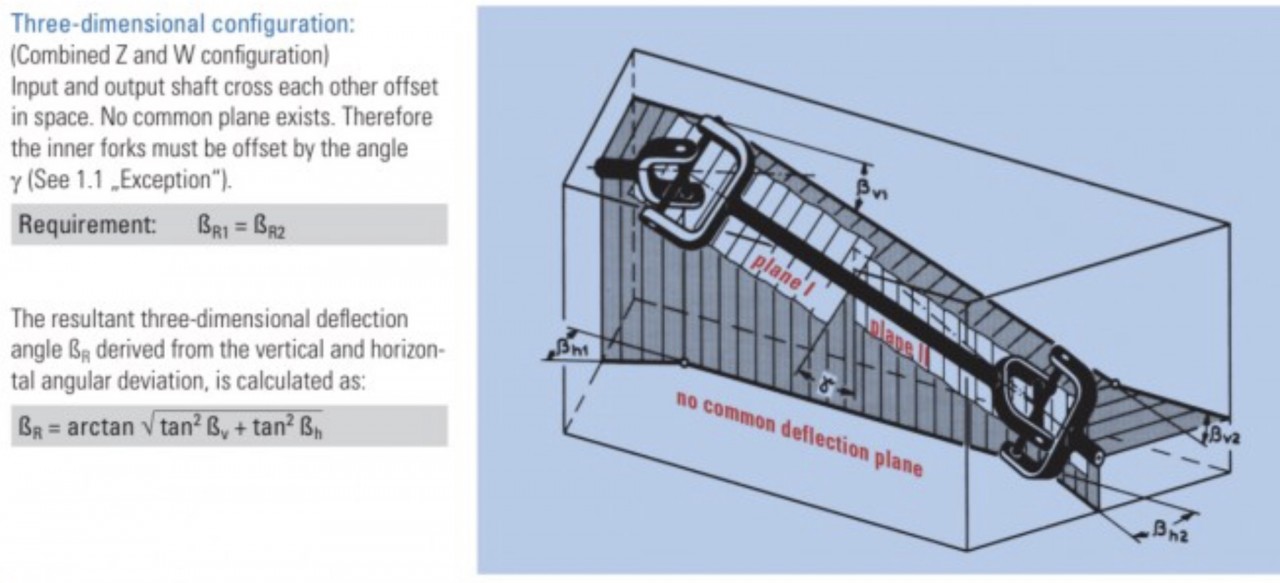

Here is a picture how the special case, our second rod is intentionally designed in the Morgan. Have a look at the inner forks, they are twisted. But everything uptream and downstream of this rod must be aligned +++ on each side of this twisted fork.
My guess, why there are so many U joints, a) there is no room for a direct connection, and b) it is a safety concept. We do not have a telescopic steering column in the Morgan. Alternatively, the U joints in the wheelhouse will buckle. This way we don't impale ourselves on the steering wheel in a crash, as it was the case with very old cars.

Thanks I see what you mean now about the second rod having differently aligned inner joints / forks, and I agree on the possible reasons for 4 UJ's but it does complicate things! The more UJ's The more chance of misalignment and uneven steering feel.

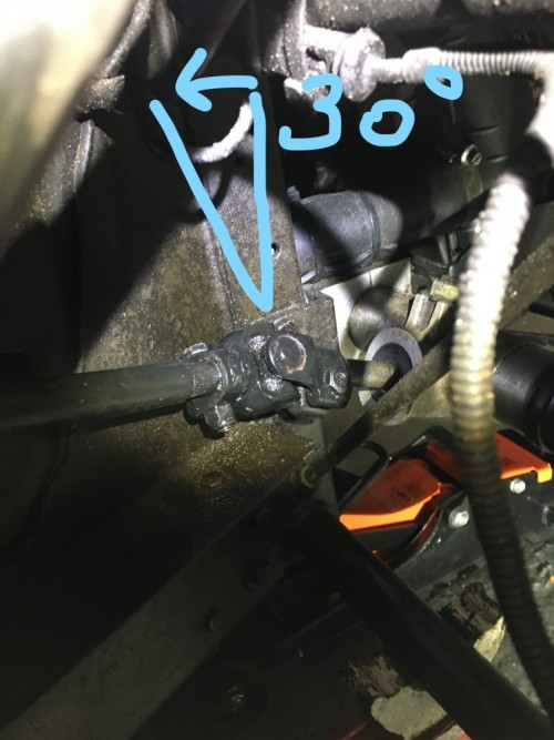

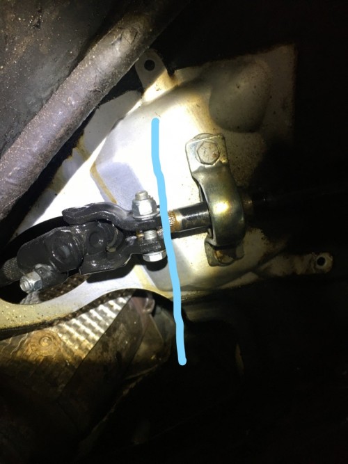

Checked the UJ under the steering wheel and the one next to the bulkhead and the UJ forks are roughly in line.
Then I took the box off the inner wing/valance that covers the UJ where it passes through the inner wing. Looking at the photos the UJ inner forks near the inner wing are vertical but on the UJ near the steering rack the forks are at about 30 degrees to the forks on the UJ near the inner wing. Does this look like it may be my problem?
Rob

Rob, that could be the issue. I would realign it and give the chance a try and see if there is an improvement. 30 degrees is significant.
