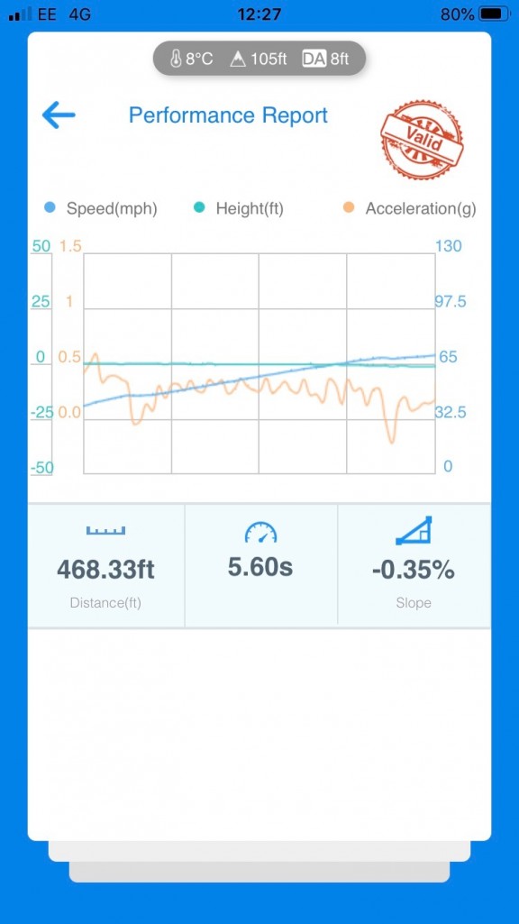

40-70mph, not sure if I was at full acceleration when going through 40mph though.

Are those figures with your Magnaflow exhaust Obie or have you refitted the originals? Also what gear did you do the 40-70 in? It will be interesting to see if there is much change after you have fitted your choice of free flowing exhaust. When I changed to the G56 it certainly felt like an improvement but you will have some figures to show if that feeling is correct. The only figures I have seen are Morgans publicity fantasy numbers, at least these are believable, thanks.

Standard exhaust fitted with number 1 baffle removed, I have sold the Magnaflows.
I could improve the 0-60 on a dry road as I couldn't use much power of the line as there was no grip, 40-70 had a gear change but there was so much traffic about that may also not be representative.
I will do them again on a quiet dry road (if there is such a thing in the uk) and then again after fitting Garage 56 exhausts for comparison.
Got more power with the Magnaflows though.
