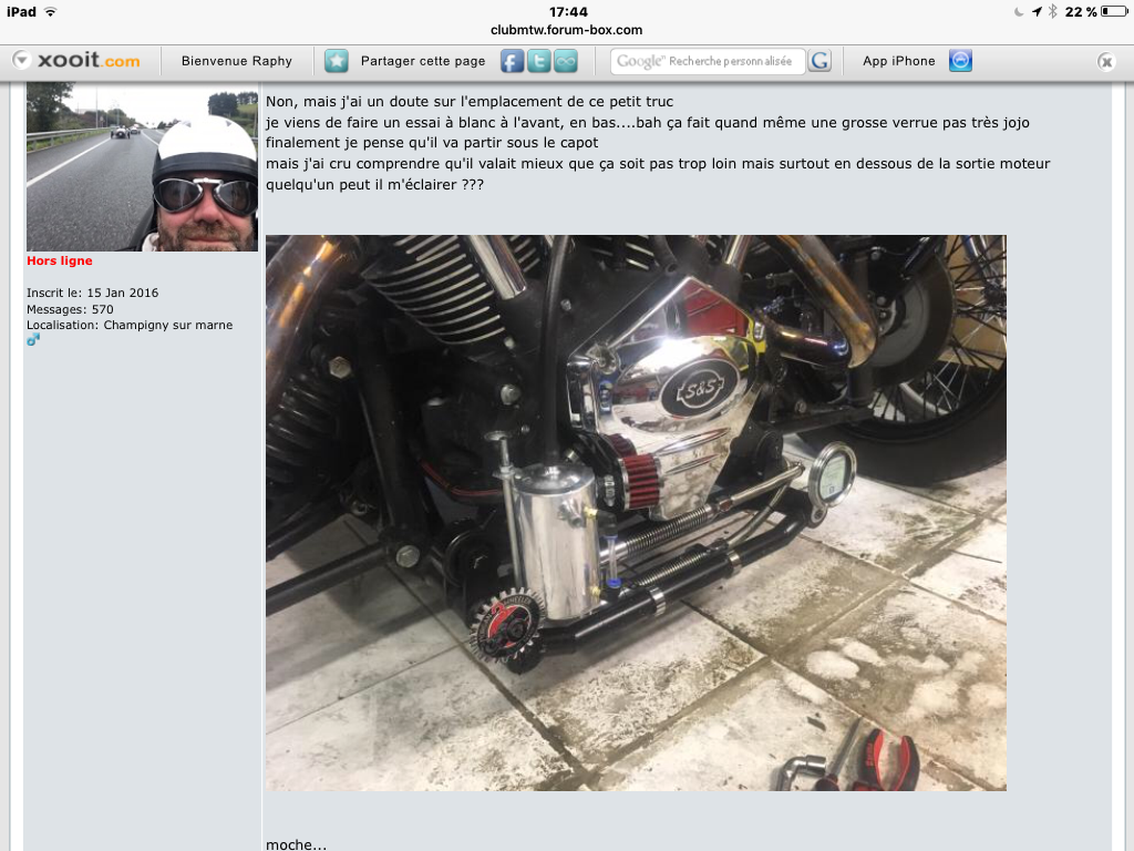

Has anybody installed an oil catch can for the PCV system or routed it to the atmosphere? Would love to see some pics, before I do mine...

Just run it to atmosphere -- no need for a fancy catch can. Be sure to plug the hole in the inlet. I don't believe the three wheeler is GDI so it's not vital to do this. Obviously it is for a Plus 4 with the GDI engine because of inlet valve fouling.

One of my previous posts shows the set up on my plus 4. I'm not sure how to sh ow the link here and also not sure how useful that is to you. As Griffo says it's not crucial to vent via a can but I felt better doing this. It won't do any harm either way.
