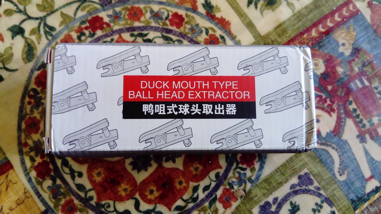

I think I asked this some time ago but never really felt conclusive.
What is the best tool for separating the ball joint from the track rod end?
My method requires a lot of hammering which I don't really like.
Bob
2009 Black Roadster
1999 4/4 2 litre Zetec
Posts: 5,606
Likes: 617
Posts: 5,606
Likes: 617
I used one of these..... Just reading the box I was glad I bought it!! :-)
