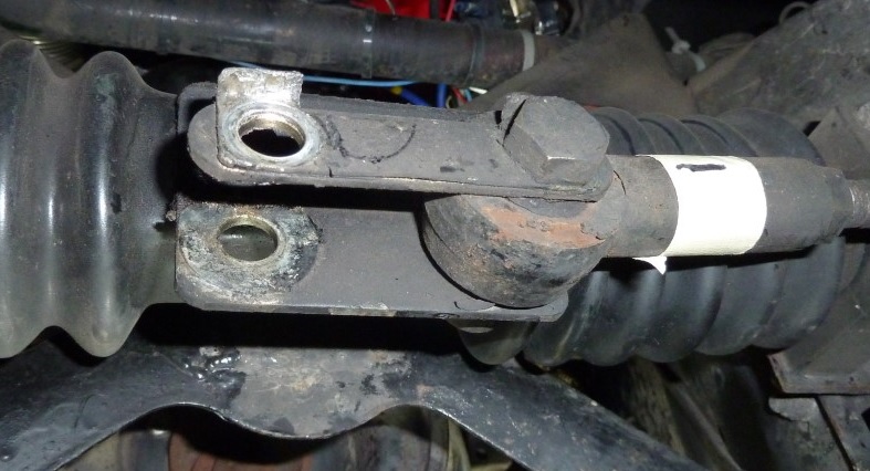

First job was to mark the inner rod ends so I know which side faces front and mark it with tape. Then undo the locking nut securing the end to the rod, remember the thread is counter clockwise, keep the lock nut abutting the rod end. Remove the bolt securing the rod end to the rack, and unscrew the rod end from the control rod, make sure the locking nut stays in place.

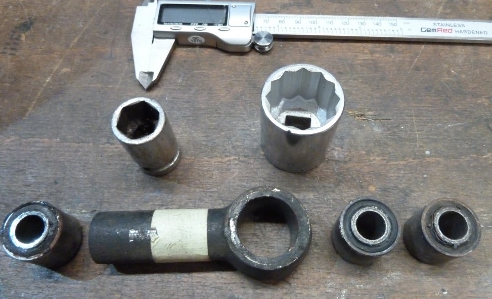

Once removed the bush can be pressed out with the aid of a couple of old sockets, a large one to go under the rod and a small one (approx 26mm diameter) to push the bush through

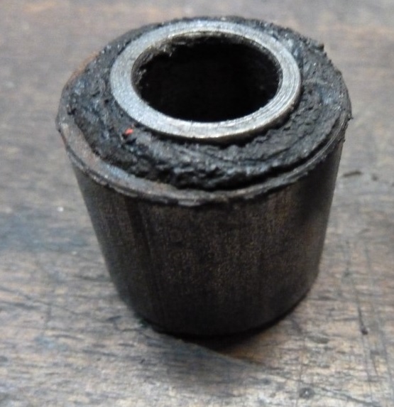

The old bush looks a bit tired
Old bush on left, new pair on right, although they have been lingering in the garage for about 10 years waiting for the call
Press the new bush in and then screw the end back onto the control rod and fit to rack.
