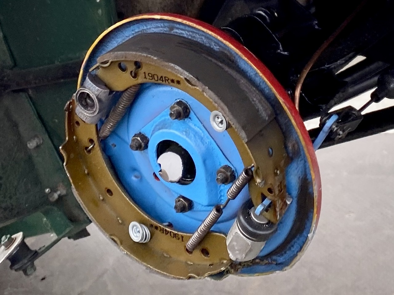

Too true Calum, it doesn’t fill me with confidence, that said, it was more my fault than the car’s, riding those kerbs is great fun, but the shock load is obviously too much for that design of axle. It’s the lightest axle fitted to Caterhams, but not as strong as the Ford Escort one, I should probably look at an upgrade if I’m going to continue with track days, but maybe not to the extent of buying a Senna, that would be a little more expensive than just a fancy axle.
I certainly wasn’t the only one trying too hard, even the Senna had a tank slapper, he comes to Knockhill often and holds the track record for a production car, 51 seconds, most do well to get below 60. He said the tyres just wouldn’t get up to temperature, the in car telemetry shows him everything, it’s an incredible machine. He was driving in full race mode with all assists turned off and performance at maximum, same as me then! laugh2
There were several others too who went for a cool down in the gravel and one fully race prepared BMW had his bonnet flip up onthe straight at 130mph, smashed his screen and bashed all the roof!
Here’s a close up of the failure, it snapped the 1” drive shaft, it’s a bit of a weird combination of ideas, a taper, with a square keyway, then a nylock nut on a UNF thread.
To be honest, that looks and sounds near enough identical to the Morgan set up. Slightly different grease seal cover but otherwise identical.

Re. The failed shaft, the last time I broke it, it sheared the key and ripped the nylock nut threads out. It was all new parts again this time so who knows.
It’s not a difficult repair and it’s not a lot of money , £200 or so to rebuild the axle I’ve got, the slight body damage doesn’t matter, just another battle scar to add to the charm.
