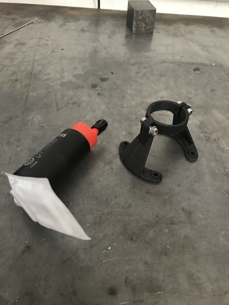

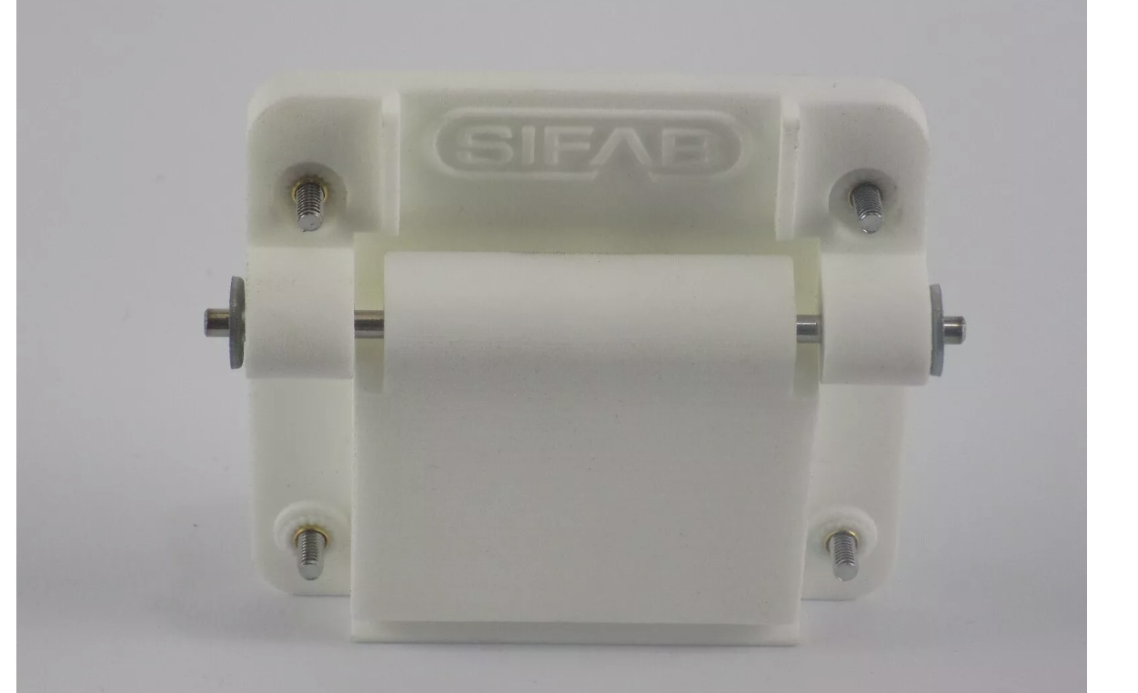

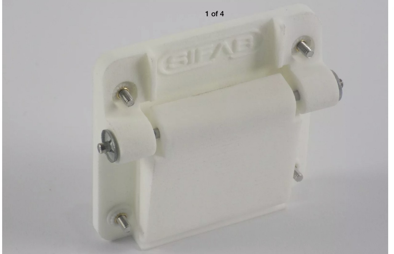

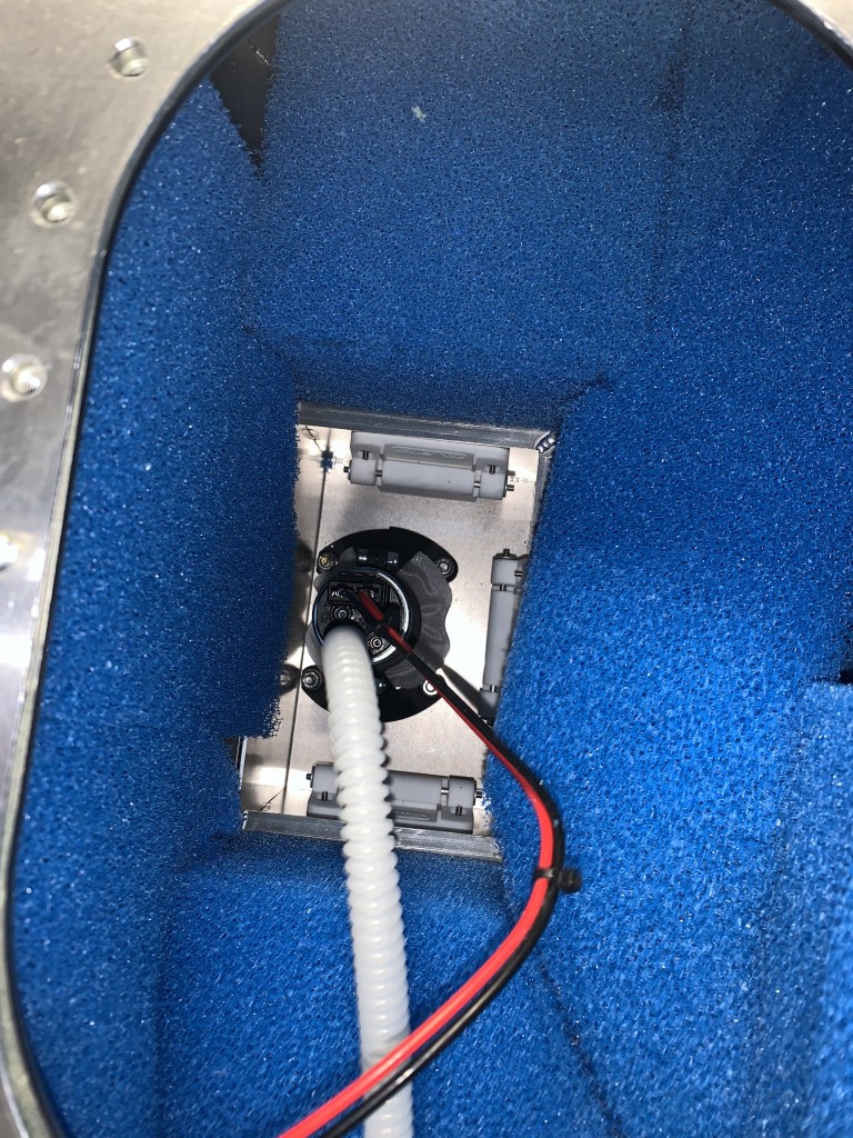

We use lots of 3D printed components in nylon as end use products
These are the baffle flaps fitted around the collector boxes used inside the competition fuel tanks
You can see them here, surrounding an in-tank high pressure fuel pump
And here’s the pump and it’s 3D printed retaining bracket out side of the tank prior to fitting

Very clever stuff Simon.

And one showing the pump fitted

Simon, it looks like the resistive strips for the fuel level sender are exposed to direct contact with the fuel ?

Yup...exactly as the are in a Ford Mondeo, Focus, Fusion, CMax, Fiesta, et al

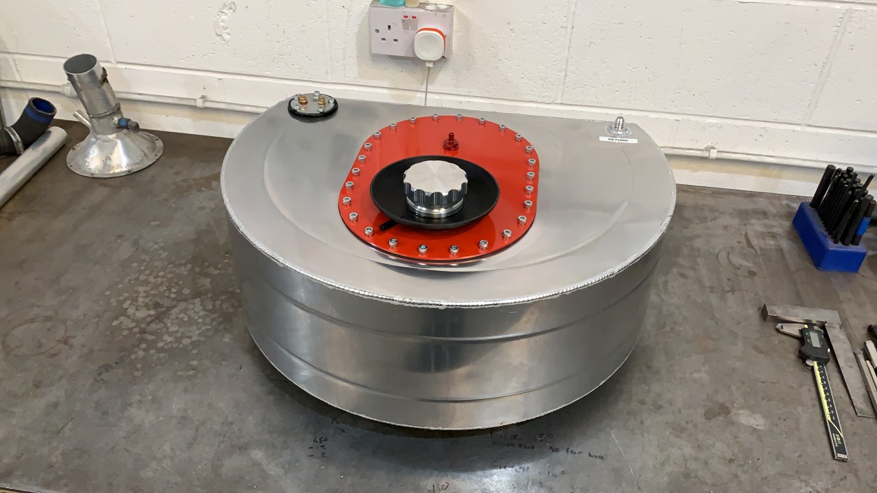

And for a change of scenery.....
Some BMW parts....
This is a 40 ltr "D Cell", designed to fit into the spare wheel well of a BMW 3 series, foam filled and with a small sump and pick up, to run an external fuel pump

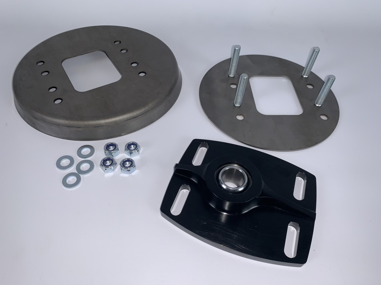

These are Group A/DTM suspension strut top mounts, to suit the E30 saloons from the late 80's/early 90's. There's a huge resurgence on building these for Historic Touring Car Racing, so we were commissioned to manufacture a small batch run

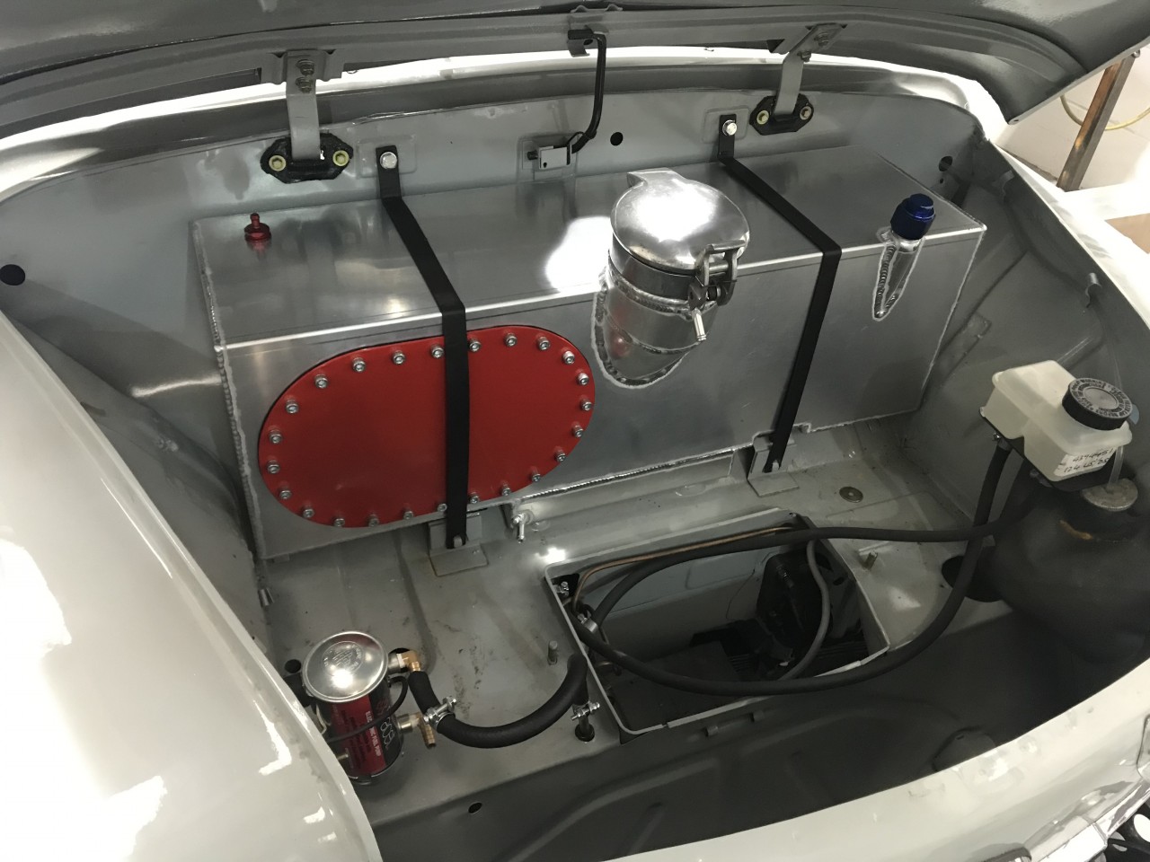

Had this little cutie in about this time last year for a fuel tank.
It's an Abarth 1000
The customer had an original works filler cap that he wanted to use, so we machined up a threaded collar to allow us to screw the cap onto the tank neck.
The cap also had to fit perfectly through the pre cut hole in the bonnet

What a tidy garage. It puts mine to shame. Maybe I’ll get the chance to use yours as an inspiration and tidy mine up during the isolation
