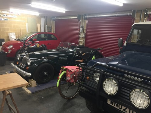

I've got 3 individual 2.4m insulated high security roller doors on my garage, I find they work ok. The garage internal volume is 10m x 7m x 2.5m and I heat it with a 2Kw fan heater, takes about an hour to get warm though the whole garage but I keep the fan in front of the Morgan next to the tool cab so that bit warms up quickest.
The walls are double skin blocks with rockwool in the cavity, ceiling is double-skinned plasterboard with 150mm of celotex. Floor is 150mm of reinforced concrete with a damp proof membrane but no other insulation. I used recycled plastic interlocking tiles from Ecotile for the floor.
