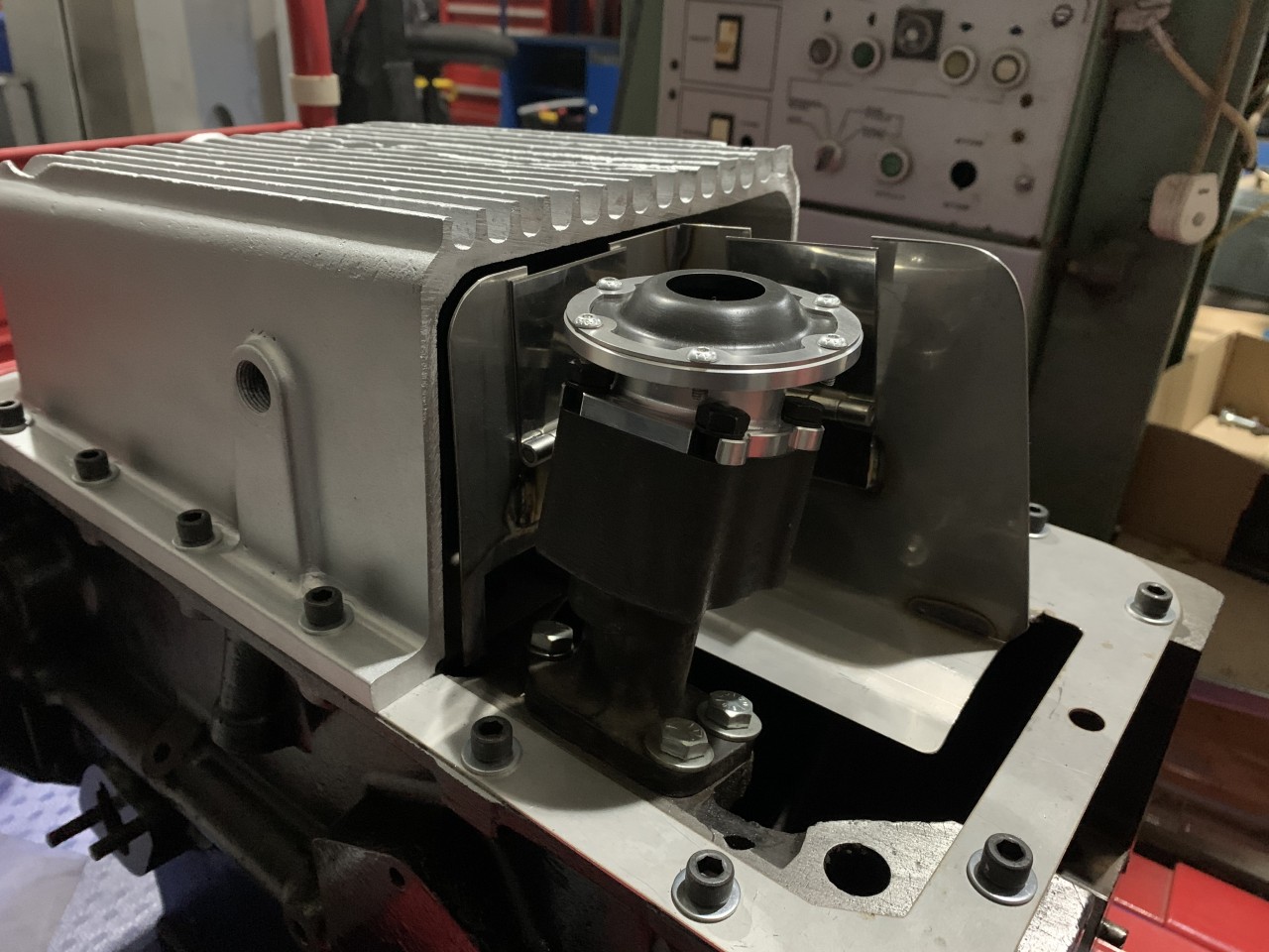

This is a combined bolt in sump baffle and windage tray for the TR engined +4’s
As the drivers are pushing harder than ever these days, they are starting to see oil surge when cornering on track
The standard oil pick up on TR engine is a long sock like gauze, running along the bottom of the sump pan. It’s size makes it impossible to adequately battle the sump, so we designed a new pickup, that bolts directly to the bottom of the oil pump. We had to get these 5 axis machined because of some of the geometry of the part
The new pick up allows for a much smaller area to be baffled with one way trapdoors
An old aluminium sump was 3d scanned and then sectioned to check for proper clearance

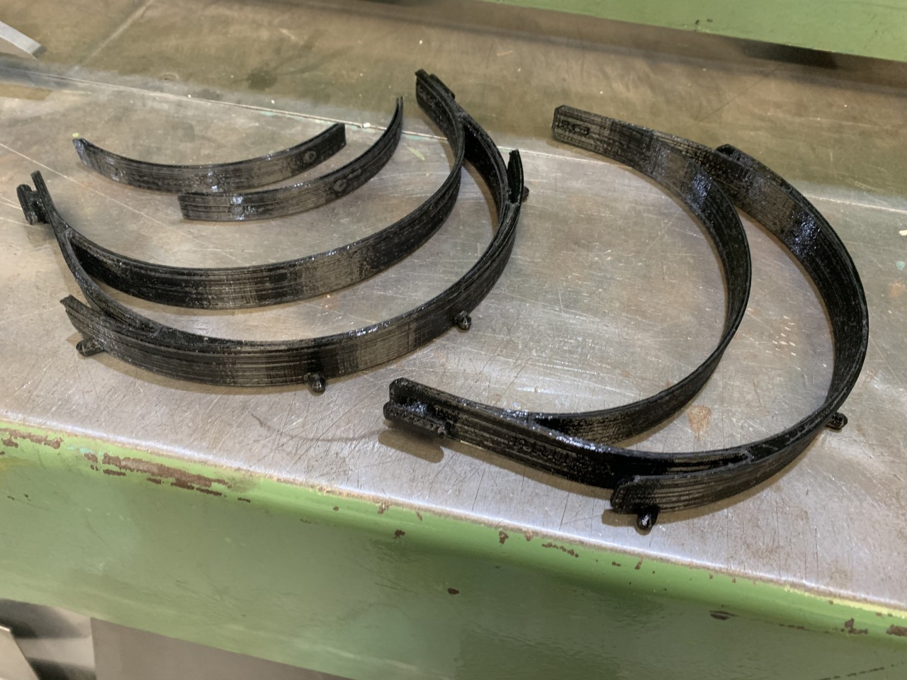

We’re printing mask components for the NHS and other front line workers
In PETG material so they can be autoclaved or washed in boiling water after use
A local engineering consultancy is coordinating all the micro manufacturers
It’s like all the little boats going to Dunkirk!
