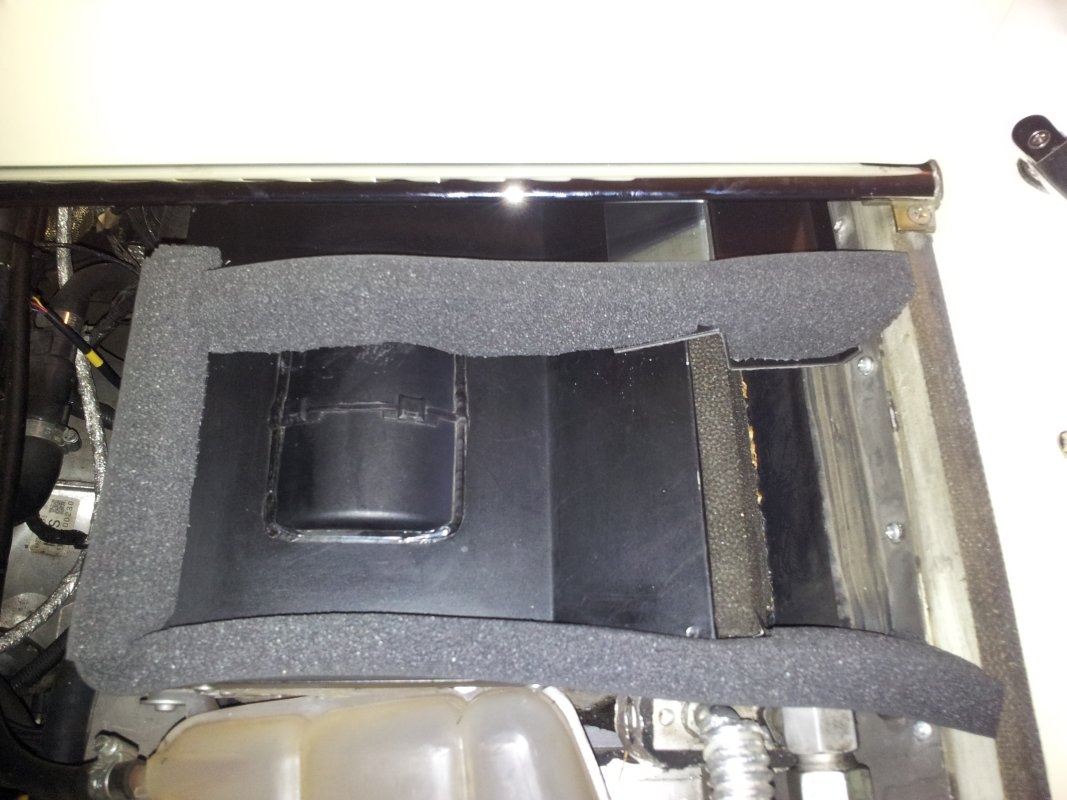

I had a mouse situation in my garage... I was very lucky that no wires were damaged.
My two pronged attack of putting poison everywhere combined with an electronic device (which has a special 'Turbo Nutter' setting) has seen them off.
I stripped off the old foam work and found an identical replacement supply online - which I have fixed with high temperature glue - and all is back to normal.
The big issue with mice is if they decide to go for your electrics - that can be a huge job to rectify.

What a lovely nest Neil. It is a shame to have to evect them after so much hard work.
While you are in there with new foam you might like to consider running a strip either side of the bonnet hinge and using a piece of plastic sheet or aluminium to block the central part of the airbox. This will stop hot engine air coming into the cockpit in warm weather. The gap for the hinge at the front allows an amazing amount of hot air to enter the ventilation airbox. I have the optional aircon so it was quite important to do this to get the best possible result from the aircon.

And here is my version after 10k miles & in need of cleaning. I used duct tape to wrap the foam.
