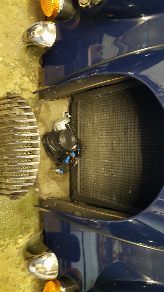

On my car the nuts are riv nuts & as Richard says the box has to come off.
Here is a shot of my car with the grill off. You can see the Riv nut on the cowl box.

Rivnuts were used for a while, and my 04/05 Roadster is like John's.
But my 2012 had rough cut ovalled holes in that panel, as does my 2016.
