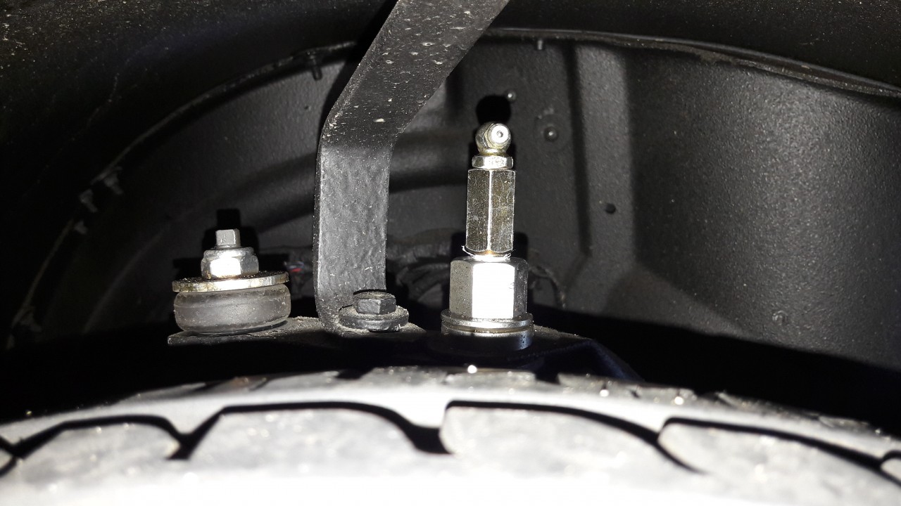

Originally Posted by Spanner Juggler
If you have a pistol grip gun in like a Wanner you can use it sideways on top of the wheel and reach the upper nipple. Then if you listen carefully you can hear it ‘burp’ as the grease exits around and under the steering bearing.
Of course nothing is a good as getting under the car with a couple of 1/2” (13mm) spanner’s and doing a quick spanner check of the lower crosshead/kingpin fixings and tie rod.
BR
Colin (first method is a clean and easy way to give the front a couple of shots of grease when touring)
This is my solution to 'tour greasing' helps with access to the top nipple as Colin suggests above
Joined: Jun 2015
Posts: 2,095
Likes: 75
Joined: Jun 2015
Posts: 2,095
Likes: 75
BR
I also fitted those extensions a couple of years back, following a tip on TM and they make it so much easier to access. Mind you, I still have a belly crawl to make sure discs are clear after greasing.
